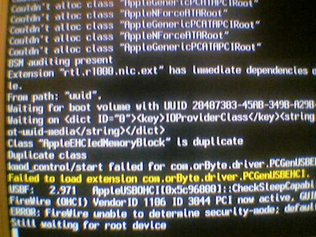

Hi Mysticus,
I ran the v1.4a installer on my main OS X 10.5.3 system with the defaults chosen, no Kernel Options chosen, Nvidia Options - I chose NVinject with 256 RAM, and my Patches choice was MAC.NUB/Mac Pro Named. These were the same choices made originally when using V1.3 to update my 10.5.2 system.
The install went OK up to the required restart but upon restarting the system hung; see boot screen image:
Something has gone wrong ..... my fault in not deselecting "Prepare For Combo Update" and/or the Option and Patches choices?......should I only have selected 10.5.3 Update Fixed v1.4 and Finalise and nothing else....? :)
I will have to use Carbony Copy Cloner to clone an original 10.5.2 system to my Main volume and run your 10.5.3 v1.4a Updater on it as I did on my Test Volume...... :)
Cheers Haxi
Specs and original install in signature ...
Didn't work, it hung right after the firewire with the "still waiting for root device" error ... tried IDE, IDE+AHCI, AHCI, and Legacy, no luck.
your osx hdds that you are trying to boot should be on the main intel controller and not the jmicron!!! i didnt add jmicron stuffs... also your intel controller's sata ports should be set to AHCI!!! and not ide or anything... If bios is set correctly for ahci, and your osx boot is not on jmicron, it should work else, please provide me your sata controllers' device/vendor ids so I can see if they are in the list or not...
@haxi: prepare update/ main update package and the finalize should be selected, i will check the package and see if there is anything wrong in there... i might have left some things missing :) working on too many scripts sometimes has wrong effects as well :) the fix however should not be hard... only replacing one script from the main installer and i ll check and provide the solution... which will be copy and paste of one file and nothing else hopefully...
