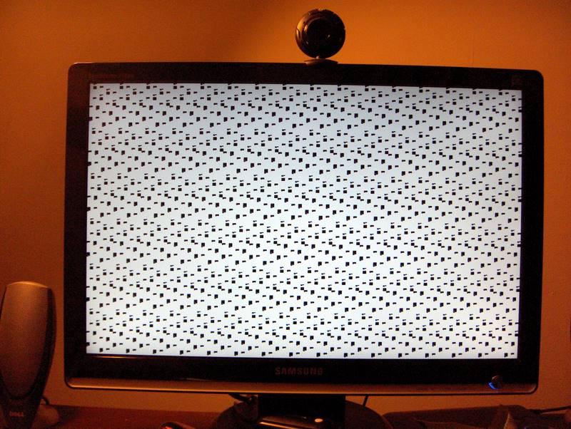

edrin Posted November 22, 2008 Share Posted November 22, 2008 I have the 94c1 card 01:00.0 VGA compatible controller [0300]: ATI Technologies Inc Radeon HD 2400 XT [1002:94c1] and when using the drivers for this card I have the black & white blocks with no desktop I use the RGB output and not my DVI. Does anyone know how I can get this card working in 10.5.2? this card dont work till now hardware accel . you can maximum charge correct id card and gl framework with this method: 1. clean install without any graphic drivers ideneb v3 10.5.5 2. install 9f23 drivers from www.nvinstaller.com 3 install 9f23 post-install drivers with kext helper without natit.kext 4. install efi strings for ati 2400 card with efi studio in com.apple.Boot.plist after you change in efi studio "Iago" with "Megalodon" 5. restart with "Graphics Mode"="1280x1024x32" (or your good resolution) 6. enable gl with osx86tools Now you must have good video description in System Profiler good 2D drivers , gl framework but software accel and no quartz extreme. Link to comment https://www.insanelymac.com/forum/topic/107526-ati-radeon-hd-pkg-installers-105x-106/page/40/#findComment-974583 Share on other sites More sharing options...
xomp Posted November 22, 2008 Share Posted November 22, 2008 this card dont work till now hardware accel . you can maximum charge correct id card and gl framework with this method: 1. clean install without any graphic drivers ideneb v3 10.5.5 2. install 9f23 drivers from www.nvinstaller.com 3 install 9f23 post-install drivers with kext helper without natit.kext 4. install efi strings for ati 2400 card with efi studio in com.apple.Boot.plist after you change in efi studio "Iago" with "Megalodon" 5. restart with "Graphics Mode"="1280x1024x32" (or your good resolution) 6. enable gl with osx86tools Now you must have good video description in System Profiler good 2D drivers , gl framework but software accel and no quartz extreme. wat sorry man, but I have no idea what you're talking about here lol. Unless I'm provided with spoonfed how-to's I will get lost. Link to comment https://www.insanelymac.com/forum/topic/107526-ati-radeon-hd-pkg-installers-105x-106/page/40/#findComment-974591 Share on other sites More sharing options...

xomp Posted November 23, 2008 Share Posted November 23, 2008 I have the 94c1 card 01:00.0 VGA compatible controller [0300]: ATI Technologies Inc Radeon HD 2400 XT [1002:94c1] and when using the drivers for this card I have the black & white blocks with no desktop I use the RGB output and not my DVI. Does anyone know how I can get this card working in Kalyway 10.5.2? I use the vanilla 9.2 kernel. Link to comment https://www.insanelymac.com/forum/topic/107526-ati-radeon-hd-pkg-installers-105x-106/page/40/#findComment-974888 Share on other sites More sharing options...

xomp Posted November 24, 2008 Share Posted November 24, 2008 With this method I have QE/CI activated with ATI Sapphire Radeon HD 2400XT (9ac1) 256MB and works fine. Try with this kext (remove and backup the your one before installing with kexthelper): ATIRadeonX2000.kext.zip But I have the 94c1 not 9ac1 and besides, I can't make heads or tales of what those instructions are saying. They are a bit scatter brained (no offense). If you can explain the steps a little more clearly than the OP I would appreciate it. I just can't wrap my brain around the language barrier he has Link to comment https://www.insanelymac.com/forum/topic/107526-ati-radeon-hd-pkg-installers-105x-106/page/40/#findComment-976439 Share on other sites More sharing options...

Guest Posted November 24, 2008 Share Posted November 24, 2008 But I have the 94c1 not 9ac1 and besides, I can't make heads or tales of what those instructions are saying. They are a bit scatter brained (no offense). If you can explain the steps a little more clearly than the OP I would appreciate it. I just can't wrap my brain around the language barrier he has I have 94c1, escuse me. In EFI string you can also change the string "IagoParent" with "MegalodonParent". Look at this Topic: http://forum.insanelymac.com/index.php?showtopic=137076 Link to comment https://www.insanelymac.com/forum/topic/107526-ati-radeon-hd-pkg-installers-105x-106/page/40/#findComment-976553 Share on other sites More sharing options...

xomp Posted November 25, 2008 Share Posted November 25, 2008 I have 94c1, escuse me. In EFI string you can also change the string "IagoParent" with "MegalodonParent". Lokk at this Topic: http://forum.insanelymac.com/index.php?showtopic=137076 You sir, and Demone are saints among men! This actually worked beautifully!!! I can't thank you both enough! Link to comment https://www.insanelymac.com/forum/topic/107526-ati-radeon-hd-pkg-installers-105x-106/page/40/#findComment-977031 Share on other sites More sharing options...

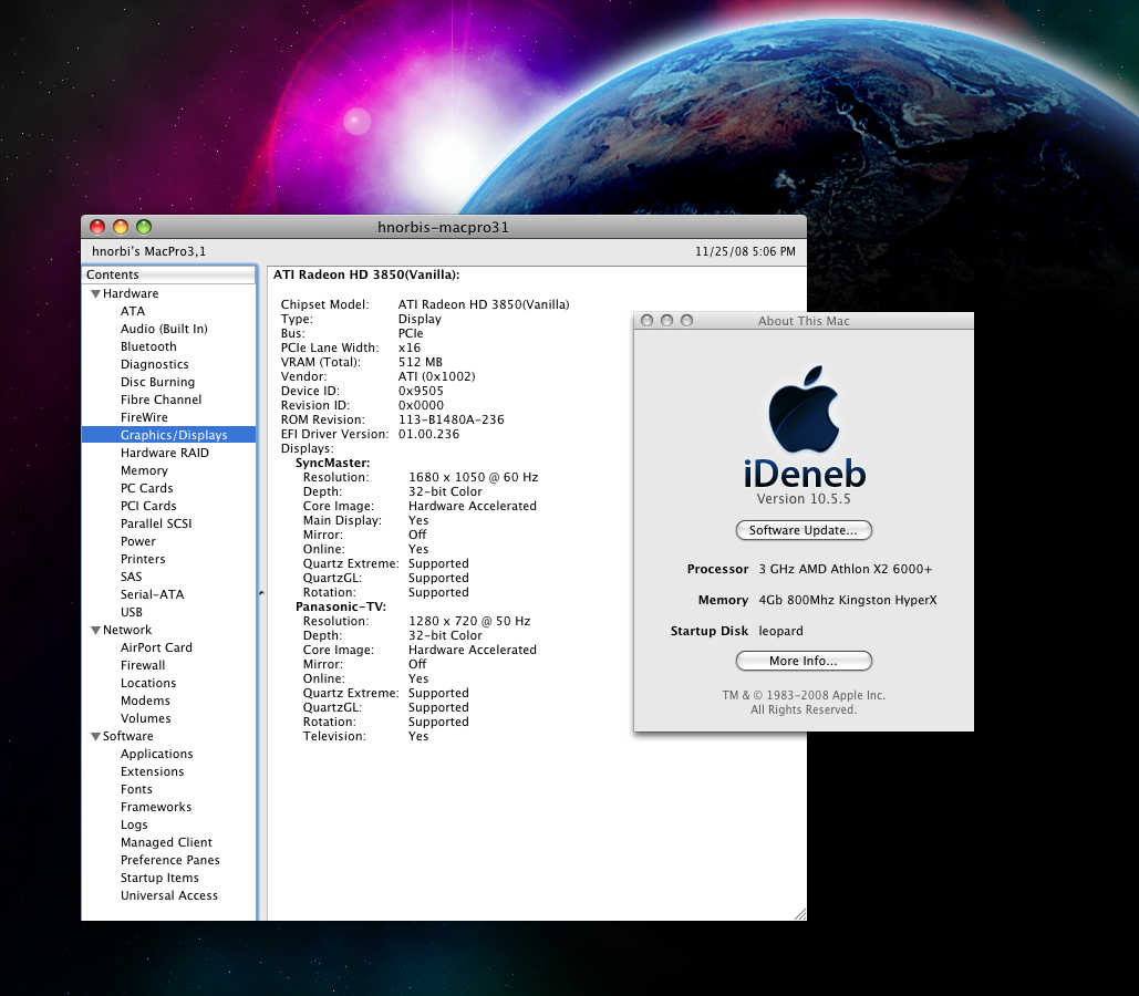

hnorbi Posted November 25, 2008 Share Posted November 25, 2008 You may try my modded NATIT.kext.I moddded it a bit, got also KP or blue screen with Natits try&error installs. (mostly .pgk have also some natit.kext installed too). Be sure that you have an Megadlon.plugin in the ATIRNDRV.kext (in Plugin folder od that .kext). This natit uses Megadlon Framebuffer. Some OSX86 DVDs didnt have all Framebuffers included (use older ATI drivers without Megadlon plugin). Remove other natit.kext. Install this Natit.kext with KEXTHELPER or OSXTools (because of rights setting). I would also remove extensions.mkext before reboot Hey man, your kext just worked for me!!! Thanks so very much ! Link to comment https://www.insanelymac.com/forum/topic/107526-ati-radeon-hd-pkg-installers-105x-106/page/40/#findComment-977438 Share on other sites More sharing options...
