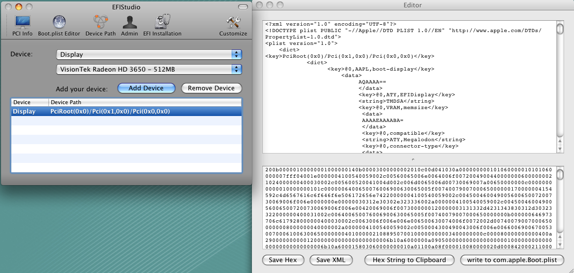

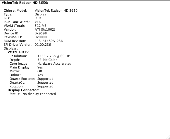

H4ckster Posted November 18, 2008 Share Posted November 18, 2008 I have made an edit to efistudio that puts the VisionTek Radeon HD 3650 with 512mb in the dropdown as a choice I used the eps fixed 5.5 driver pkg for the 3650 then removed natit, I think this is needed b/c the drivers in this pkg are bin patched ... someone correct me if I am wrong on that. To add this file into the app just right click on it and show package contents, then go to EFIStudio.app/Contents/Resources/graphiccards and drop in this plist. Then run efistudio and it will be under display in the list of supported efi strings. Hope this helps someone.Also Ican edit it a bit if someone needs something other then VisionTek and can't figure out how to do it on there own. My system has been updated so ignore the sig ... guess its time to edit it lol VisionTek_Radeon_HD_3650___512MB.plist.zip Link to comment https://www.insanelymac.com/forum/topic/107526-ati-radeon-hd-pkg-installers-105x-106/page/37/#findComment-970495 Share on other sites More sharing options...
ridgeline Posted November 18, 2008 Share Posted November 18, 2008 I have made an edit to efistudio that puts the VisionTek Radeon HD 3650 with 512mb in the dropdown as a choice I used the eps fixed 5.5 driver pkg for the 3650 then removed natit, I think this is needed b/c the drivers in this pkg are bin patched ... someone correct me if I am wrong on that. To add this file into the app just right click on it and show package contents, then go to EFIStudio.app/Contents/Resources/graphiccards and drop in this plist. Then run efistudio and it will be under display in the list of supported efi strings. Hope this helps someone.Also Ican edit it a bit if someone needs something other then VisionTek and can't figure out how to do it on there own. My system has been updated so ignore the sig ... guess its time to edit it lol I am guessing that this only applies to desktops not laptops as that is what fuji and I are trying to work on..... Please correct me if I am wrong Thanks, Mark Link to comment https://www.insanelymac.com/forum/topic/107526-ati-radeon-hd-pkg-installers-105x-106/page/37/#findComment-970501 Share on other sites More sharing options...
