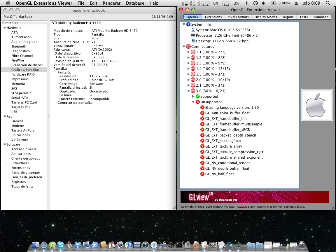

macoff Posted November 7, 2008 Share Posted November 7, 2008 Hi, I test de natit posted by Fujilives (3450 Modified Natit) with the same results as those above, like other times I have added the ID (0x95c4) to ATIRadeonX2000.kext, and this time without blackscreen!!! Its something. I got errors in boot loading with the Megalodon: 07/11/08 23:45:09 com.apple.kextd[9] /System/Library/Extensions/ATINDRV.kext/Contents/PlugIns/ ATY_Megalodon.kext/Contents/MacOS/ATY_Megalodon isn't a valid mach-o, bad symbols 07/11/08 23:45:09 kextd[29] error mapping module file /System/Library/Extensions/ATINDRV.kext/ Contents/PlugIns/ATY_Megalodon.kext/Contents/MacOS/ATY_Megalodon 07/11/08 23:45:09 kextd[29] can't map module files 07/11/08 23:45:09 kextd[29] can't check load addresses of modules 07/11/08 23:45:09 kextd[29] a link/load error occured for kernel extension /System/Library/ Extensions/ATINDRV.kext/Contents/PlugIns/ATY_Megalodon.kext MacOff EDIT: and this in terminal: Last login: Sat Nov 8 00:44:43 on ttys000 macoffs-macbook:~ macoff$ /System/Library/Extensions/ATINDRV.kext/Contents/PlugIns/ ATY_Megalodon.kext/Contents/MacOS/ATY_Megalodon -bash: /System/Library/Extensions/ATINDRV.kext/Contents/PlugIns/ATY_Megalodon.kext/ Contents/MacOS/ATY_Megalodon: Malformed Mach-o file macoffs-macbook:~ macoff$ Link to comment https://www.insanelymac.com/forum/topic/107526-ati-radeon-hd-pkg-installers-105x-106/page/35/#findComment-958580 Share on other sites More sharing options...
ridgeline Posted November 8, 2008 Share Posted November 8, 2008 Maybe this is where our problem lies.... I will take a look at it and we should maybe try and get in touch with LastExile and see what he has to say. As Fuji found the original issue was that new kext pointed to megaladon and now with the adjusted kext and the addition of megaladon back in to the mix.... It might just not be perfect quite yet..... Lets keep exploring and find a fix soon. I rebooted through verbose mode and found the same error..... maybe we can find out a little more. Link to comment https://www.insanelymac.com/forum/topic/107526-ati-radeon-hd-pkg-installers-105x-106/page/35/#findComment-958693 Share on other sites More sharing options...
