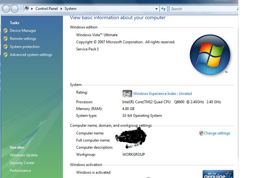

Oh and since service pack1, vista 32bit has no problems with 4 gig or higher..
Since SP1, 32bit Vista can SEE you have 4 gigs, but not actually make use of it, as far as I know.
and thats not with any memory holes.... ETC!!!
Depends on what your definition of problems is.
They added a "fix" to the OS in SP1 to have it report 4GB if you have 4GB instead of what you can actually address typically between 3.5 - 3.0GB depending on how many PCI cards and other devices you machine has.
They did this to mitigate the amount of calls they were getting asking what happened to the RAM.
This doesn't really fix anything nor does it give you any performance boost.
No, 32-bit Windows can't use more than about 3.5gb of RAM. What it shows there is the amount you have installed, not how much you can use.
