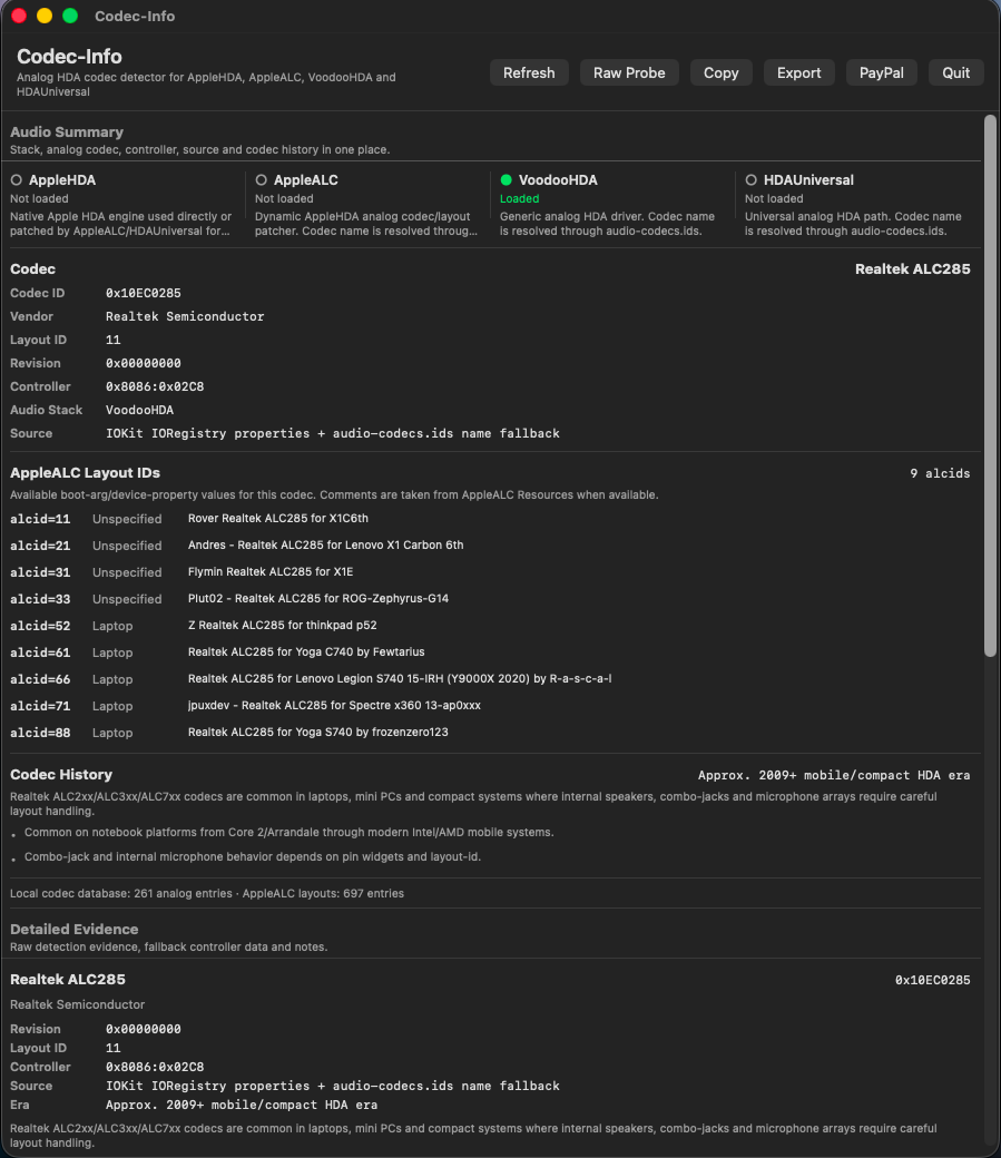

Thank you, @Slice. Installation of VoodooHDA.kext 3.6.2 was easy on my HP EliteBook 850 G7 running macOS Tahoe 26.6 Beta (25G5065a): Remove other audio kext from /Library/Extensions (in my case, I removed HDAUniversal.kext) Set csr-active-config = <03000000> and Reboot Modify VoodooHDA.kext/Contents/Info.plist: VoodooHDAEnableVolumeChangeFix = True cp -R VoodooHDA.kext /Library/Extensions Reboot Set csr-active-config = <01000000> Audio working perfectly. I don't have AMD HDMI on this hack, so I can't test AMD HDMI/DP audio, but audio quality with my internal speakers is outstanding. EDIT: Code-Info
