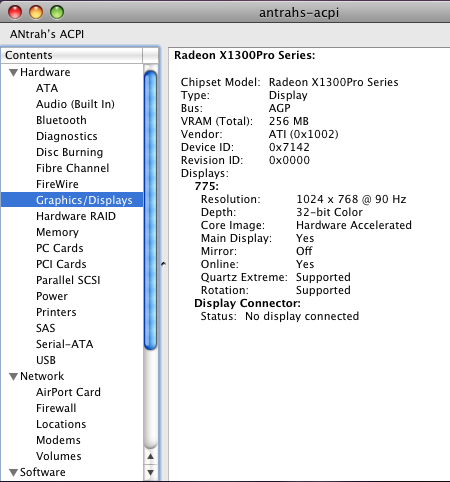

ToH 10.5.1
Radeon X1300Pro Series:
Chipset Model: Radeon X1300Pro Series
Type: Display
Bus: AGP
VRAM (Total): 256 MB
Vendor: ATI (0x1002)
Device ID: 0x7142
Revision ID: 0x0000
Displays:
775:
Resolution: 1024 x 768 @ 90 Hz
Depth: 32-bit Color
Core Image: Hardware Accelerated
Main Display: Yes
Mirror: Off
Online: Yes
Quartz Extreme: Supported
Rotation: Supported
Display Connector:
Status: No display connected <<<<<< ;)

ANtrah, what CPU, Chipset, AGPGart you have there?
