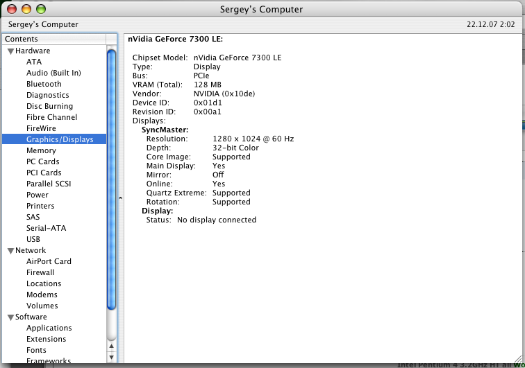

Hi Slice,
This is the output of my windowserver.log
Dec 19 04:33:04  [109] Server is starting up
Dec 19 04:33:08  [109] CGXMappedDisplayStart: Unit 0: no display alias property
Dec 19 04:33:08  [109] CGXMappedDisplayStart: Unit 1: no display alias property
Dec 19 04:33:08  [109] Accel caps: 00000003
Dec 19 04:33:22  [109] CGXPerformInitialDisplayConfiguration
Dec 19 04:33:22  [109]   Display 0x2b385a50: MappedDisplay Unit 0; Vendor 0x10ac Model 0xe000 S/N 808475217; online enabled (0,0)[1280 x 1024], base addr 0x3008000
Dec 19 04:33:22  [109]   Display 0x2b384785: MappedDisplay Unit 1; Vendor 0x10ac Model 0xe003 S/N 808863556; online enabled (1280,0)[1280 x 1024], base addr 0x3008000
It doesnt seem out of the ordinary to me. I tried to find something in the logs that could help you and the only thing I could find out of the ordinary was this line in my system.log its repeated about 50 times
Dec 19 04:33:22 eric-rezns-computer kernel[0]: Graphics chip error! Restarted.
And let me explain what happens in detail once my system boots with the agpgart: the system boots and then when it looks like its about to start up both screens turn blue then after a little while the left screen turns black(right one stays blue) and the mouse cursor appears and I can move it around and from one screen to the other.
Hope this helps somehow

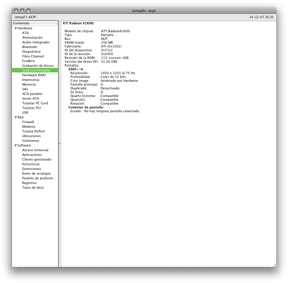

2 ANtrah
Bus: AGP
VRAM (Total): 256 MB
Vendor: ATI (0x1002)
Device ID: 0x7142
How can you explain the Bus: AGP?
What version of AGP driver do you have????
No display connected - there is another VGA output. The main output works!
2 rezn
You have no graphics output :blink: Sorry, it is AGPGart problem.

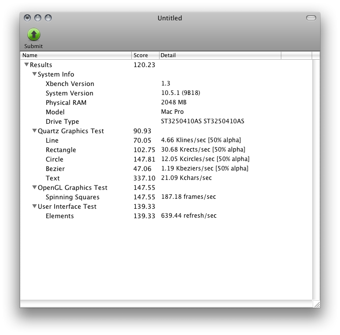

You have the same pc as I do except for PCEFI and you seem to have better UI perf as I do.

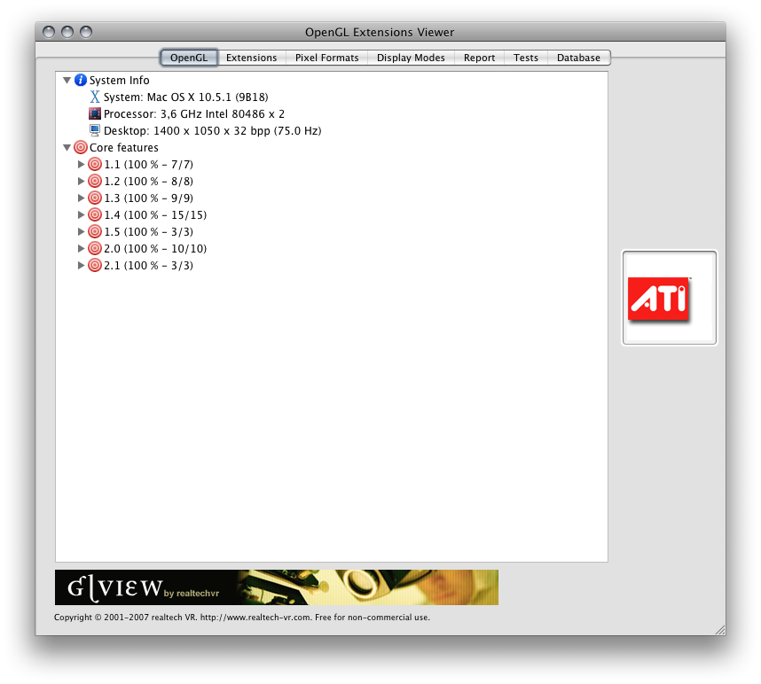

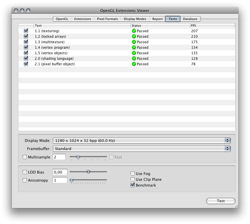

Can you run a benchmark with glview in 1280x1024@32 bit ? if you can't as that rez, in 1024x760@32bit.
edit : ive just compared my Xbench with AGPGART 249 and u r twice faster as me : ie in rectangle mode, and worst UI=48 on my computer !!
explain me which file u r using cause it seems to works 100% on ur config maybe it's PC EFI V8
Thanks in advance

yes, correctly installed PC_EFI_V8 was "the key" (plus some bios tweaking)
agpgart 2.4.9 working with radeon x1600 pro -> asus p4p800se (intel i865pe) under 10.5.1 with pc efi v80 (device id configured on com.apple.boot.plist) + original atiradeonx1000 kexts (adding device id 71c2 in atiradeonx1000.kext) + replacing atindrv from 10.4.5 & iondrvsupport from 10.4.7

Izmael can u relaunch a fresh Xbench cause i dont get ur UI perf? compared to OPENGL extension tester. Did u check games? such as call of duty 2 i really don't think u ve more performance at all i get the same results. what is your aperture size in your bios?

You don't answer at all my question... can you reboot and redo a xbench in 1280x1024@60Hz and try Call of Duty 2 if you can (demo on macupdate) or WoW and everything maxxed it should be like 15fps (unplayable)
I get the exact same perf w/out PCEFI in GLVIEW so I think it doesn't work.. xbench might be wrong 'cuz it's bugged
You don't answer at all my question :) ... can you reboot and redo a xbench in 1280x1024@60Hz and try Call of Duty 2 if you can (demo on macupdate) or WoW and everything maxxed it should be like 15fps (unplayable)

ok u wanna play with an insanelymac legend (maybe i should refresh ur memory : ive made the X1600Pro package for tiger n leopard), anyway here to prove u Im right his my ioreg after using pcefi v6x1600
xbench still slow as hell (i suggest u relaunch ur xbench) anyway xbench is not working it has been proved for a while, and i get the same result under opengl extension benchmark uve used.

I'd like to understand (and check) how Izmael had 4 times better score under UI meanwhile i had better score under Opengl extension benchmark. Anyway believe or me, take more tester, no 1 is having I865 working for sure + AGP.
Version 249 downloaded 123 times and only 4 bad reports. Version 260 is beta, dowloaded 36 times and only 1 bad report. All these reports with nVidia AGP. I have no any method to check what is wrong for it.
UI is bad because of SCROLL method supported by FrameBuffer driver i.e. ATY_Wormy.

ok we disagree anyway slice u may have forgoten to see izmael is having same result with n without agpgart and UI= 140 even in PCI mode so something is weird. Believe what u want.but even if your gart sets io registry doesn't mean is used correctly. Take an x1000 or whatever run a game or scroll under safari u will see. Regard and no offense my friend.
As im willing to show u my compliance here is my Xbench 1.3 result running AGPGART 2.6.0 with the same info.plist as IZMAEL and my ioreg
find the 7 differences :)
Izmael can u post ur ioreg + dmesg running 260? thanx
at the end ive posted the macbook pro RESULTS EAT THIS , which got an 128mb X1600PRO memory that gots 100FPS under call of duty2 compare to 25FPS on my PC
xbench1.3.tiff
