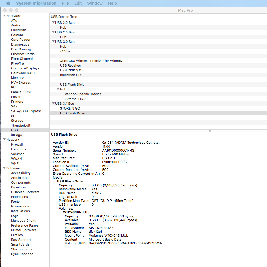

Does anyone have all USB ports working??  Im missing some in High Sierra...  I can post a copy of my EFI folder anf my IOREG
Here is my Clover folder and my IOREG
Motherboard         X99P-SLI F24
Processor             Intel 6800k
Memory                32GB
Graphics              GTX 960
Drives                  Multiple SSD and 1 Intel 600P NVME
EFI 2.zip
Jabbas Mac Pro.zip
Memory                32GB
Graphics              GTX 960
try it, dont change or add nothing, only replace full folder, reboot and send me new ioreg, test ur USB
CLOVER.zip
Here are the updated files you requested...   attached is a screenshot of my USB and PCI after booting with your Clover folder..  The USB did not change...
how many ports dont work?
use it, this version
USB.zip
which board are you Using???? I reversed back without the USB injectors and now I only have 1 port that doesnt work..  Will try sleep see if that works now...  I appreciate your help...
GA X99-UD3P

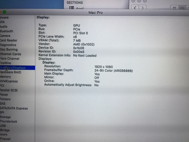

Hi guys i need help with my vga card upgraded from gt710 to amd sapphire  rx560 2gb cos everyone said its working out of the box.
I tried a few things but i m a newbie and I can't figure out why mine is not working it s booting up but in sys report graphics it says 7mb ram and no kext loaded.
Maldon you helped me with a patched dsdt last time , but with that dsdt the rx560 wont work.
I ll upload my efi ,unpatched dsdt (with the rx560 inside) , and ioreg.
Regards Adam!
efi rx 560.zip
adam Mac Pro-rx560.zip
DSDT.adam.zip
Regards Adam!
https://github.com/vit9696/WhateverGreen
Maldon I was able to make it work as you said with ssdt pm only,  i ll upload ioreg and dsdt unpatched maybe you can help again
DSDT.aml.zip
remove all ssdts, remove ssdt PM too
hot patches x99
EVMR to PMCR
4556 4d52
504d 4352
GLAN to GIGE
474c 414e
4749 4745
ALZA to HDEF
414c 5a41
4844 4546
LPC0 to LPCB
4c50 4330
4c50 4342
SMBS to SBUS
534d 4253
5342 5553
XHCI to XHC
5848 4349
5848 435f
SAT1 to SATA
5341 5431
5341 5441
HECI to IMEI
4845 4349
494d 4549
EVSS to SAT0
4556 5353
5341 5430
EC0 to EC
4543 305f
4543 5f5f
BR3A to PEG0
4252 3341
5045 4730
send me new ioreg after reboot
Ok i put that dsdt i downloaded from your link here's the new ioreg
i need check ur clover folder, i think u use xdsm patch, _DSM into DSDT dont work ;)
remove ur serials and post ur full clover folder here
