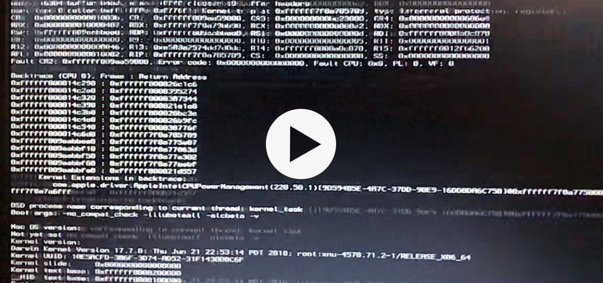

SuperReaper Posted September 11, 2018 Share Posted September 11, 2018 4 hours ago, tluck said: can you try this one? what is KP all about? DSDT.zip KP like this Anonymous UUID: 2D6AEB3B-6313-385A-93E9-DF44519B0F33 Sun Sep 9 12:38:13 2018 *** Panic Report *** panic(cpu 1 caller 0xffffff800838776f): Kernel trap at 0xffffff7f8aeec5d5, type 14=page fault, registers: CR0: 0x000000008001003b, CR2: 0x0000000000000000, CR3: 0x000000000bce3000, CR4: 0x00000000000626e0 RAX: 0x0000000000500000, RBX: 0xffffff801979e0c0, RCX: 0xffffff801a9a4c80, RDX: 0xffffff801b87d480 RSP: 0xffffff91139b3eb0, RBP: 0xffffff91139b3eb0, RSI: 0x0000000000000000, RDI: 0x0000000000000000 R8: 0x0000000000000001, R9: 0x0000000000000030, R10: 0x0000000000000110, R11: 0x0000000000000008 R12: 0xffffff801a9a4cd0, R13: 0xffffff801b87d480, R14: 0xffffff801b87d480, R15: 0xffffff801a9a4c80 RFL: 0x0000000000010246, RIP: 0xffffff7f8aeec5d5, CS: 0x0000000000000008, SS: 0x0000000000000000 Fault CR2: 0x0000000000000000, Error code: 0x0000000000000000, Fault CPU: 0x1, PL: 0, VF: 1 Backtrace (CPU 1), Frame : Return Address 0xffffff91139b3980 : 0xffffff800826c1c6 0xffffff91139b39d0 : 0xffffff8008395274 0xffffff91139b3a10 : 0xffffff8008387544 0xffffff91139b3a80 : 0xffffff800821e1e0 0xffffff91139b3aa0 : 0xffffff800826bc3c 0xffffff91139b3bd0 : 0xffffff800826b9fc 0xffffff91139b3c30 : 0xffffff800838776f 0xffffff91139b3da0 : 0xffffff800821e1e0 0xffffff91139b3dc0 : 0xffffff7f8aeec5d5 0xffffff91139b3eb0 : 0xffffff800886f6d5 0xffffff91139b3f00 : 0xffffff80088723ab 0xffffff91139b3f50 : 0xffffff80088740c6 0xffffff91139b3fa0 : 0xffffff800821d557 Kernel Extensions in backtrace: org.rehabman.driver.AppleSmartBatteryManager(1.81.4)[E65767C3-A35F-348A-89CF-C6FAA44C5C6F]@0xffffff7f8aeeb000->0xffffff7f8aef3fff dependency: com.apple.iokit.IOACPIFamily(1.4)[95DA39BB-7C39-3742-A2E5-86C555E21D67]@0xffffff7f88ff2000 BSD process name corresponding to current thread: kernel_task Boot args: slide=64 -no_compat_check -lilubetaall -alcbeta -v Mac OS version: 17G65 Kernel version: Darwin Kernel Version 17.7.0: Thu Jun 21 22:53:14 PDT 2018; root:xnu-4570.71.2~1/RELEASE_X86_64 Kernel UUID: 1AE5ACFD-3B6F-3D74-AD52-31F1430DBC6F Kernel slide: 0x0000000008000000 Kernel text base: 0xffffff8008200000 __HIB text base: 0xffffff8008100000 System model name: MacBookPro8,1 (Mac-94245B3640C91C81) System uptime in nanoseconds: 41034020254 last loaded kext at 40669556317: com.apple.driver.AppleHDA 281.52 (addr 0xffffff7f8a935000, size 958464) loaded kexts: com.paragon-software.lvm-for-mac 1 org.rehabman.voodoo.driver.PS2Mouse 1.8.34 org.rehabman.voodoo.driver.PS2Trackpad 1.8.34 org.rehabman.voodoo.driver.PS2Keyboard 1.8.34 VoodooSDHC 1.1d1 com.insanelymac.IntelMausiEthernet 2.3.0d0 com.rehabman.driver.ACPIPoller 0.8.1 org.rehabman.voodoo.driver.PS2Controller 1.8.34 org.hwsensors.driver.ACPISensors 1443 org.rehabman.driver.AppleSmartBatteryManager 1.81.4 org.hwsensors.driver.CPUSensors 1443 as.vit9696.AppleALC 1.3.1 org.netkas.driver.FakeSMC 1443 com.rehabman.driver.USBInjectAll 0.6.5 as.vit9696.WhateverGreen 1.2.2 science.firewolf.NightShiftUnlocker 2.2.1 as.vit9696.Lilu 1.2.7 com.apple.driver.AppleHDA 281.52 com.apple.driver.ApplePolicyControl 3.20.13 com.apple.driver.AppleUpstreamUserClient 3.6.5 com.apple.driver.AppleMCCSControl 1.5.5 com.apple.driver.AppleGraphicsDevicePolicy 3.20.13 com.apple.AGDCPluginDisplayMetrics 3.20.13 com.apple.driver.pmtelemetry 1 com.apple.iokit.IOUserEthernet 1.0.1 com.apple.iokit.IOBluetoothSerialManager 6.0.7f10 com.apple.Dont_Steal_Mac_OS_X 7.0.0 com.apple.driver.AppleHV 1 com.apple.driver.AppleOSXWatchdog 1 com.apple.driver.AppleLPC 3.1 com.apple.driver.ACPI_SMC_PlatformPlugin 1.0.0 com.apple.driver.AppleIntelSlowAdaptiveClocking 4.0.0 com.apple.driver.AppleSMCPDRC 1.0.0 com.apple.driver.AppleFIVRDriver 4.1.0 com.apple.driver.AppleIntelSNBGraphicsFB 10.0.4 com.apple.iokit.SCSITaskUserClient 404.30.2 com.apple.driver.AppleFileSystemDriver 3.0.1 com.apple.filesystems.apfs 748.51.0 com.apple.AppleFSCompression.AppleFSCompressionTypeDataless 1.0.0d1 com.apple.AppleFSCompression.AppleFSCompressionTypeZlib 1.0.0 com.apple.AppleSystemPolicy 1.0 com.apple.BootCache 40 com.apple.filesystems.hfs.kext 407.50.6 com.apple.driver.AirPort.Atheros40 700.74.5 com.apple.driver.AppleFWOHCI 5.5.9 com.apple.driver.AppleIntelHD3000Graphics 10.0.4 com.apple.driver.AppleAHCIPort 329.50.2 com.apple.driver.AppleBacklight 170.12.6 com.apple.driver.AppleRTC 2.0 com.apple.driver.AppleHPET 1.8 com.apple.driver.AppleACPIButtons 6.1 com.apple.driver.AppleSMBIOS 2.1 com.apple.driver.AppleACPIEC 6.1 com.apple.driver.AppleAPIC 1.7 com.apple.driver.AppleIntelCPUPowerManagementClient 220.50.1 com.apple.nke.applicationfirewall 183 com.apple.security.quarantine 3 com.apple.security.TMSafetyNet 8 com.apple.driver.AppleIntelCPUPowerManagement 220.50.1 com.apple.driver.DspFuncLib 281.52 com.apple.kext.OSvKernDSPLib 526 com.apple.driver.AppleGraphicsControl 3.20.13 com.apple.iokit.IOSurface 211.15 com.apple.iokit.IOAVBFamily 680.2 com.apple.plugin.IOgPTPPlugin 680.15 com.apple.iokit.IOEthernetAVBController 1.1.0 com.apple.driver.AppleSMBusController 1.0.18d1 com.apple.driver.AppleSSE 1.0 com.apple.driver.AppleSMBusPCI 1.0.14d1 com.apple.iokit.IOFireWireIP 2.2.9 com.apple.AppleGPUWrangler 3.20.13 com.apple.AppleGraphicsDeviceControl 3.20.13 com.apple.driver.AppleHDAController 281.52 com.apple.iokit.IOHDAFamily 281.52 com.apple.iokit.IOAudioFamily 206.5 com.apple.vecLib.kext 1.2.0 com.apple.driver.Apple16X50Serial 3.2 com.apple.iokit.IOSerialFamily 11 com.apple.driver.IOPlatformPluginLegacy 1.0.0 com.apple.iokit.IOSlowAdaptiveClockingFamily 1.0.0 com.apple.driver.IOPlatformPluginFamily 6.0.0d8 com.apple.iokit.BroadcomBluetoothHostControllerUSBTransport 6.0.7f10 com.apple.iokit.IOBluetoothHostControllerUSBTransport 6.0.7f10 com.apple.iokit.IOBluetoothHostControllerTransport 6.0.7f10 com.apple.iokit.IOBluetoothFamily 6.0.7f10 com.apple.driver.usb.cdc 5.0.0 com.apple.driver.usb.networking 5.0.0 com.apple.driver.usb.AppleUSBHostCompositeDevice 1.2 com.apple.driver.usb.AppleUSBHub 1.2 com.apple.iokit.IOSCSIMultimediaCommandsDevice 404.30.2 com.apple.iokit.IOBDStorageFamily 1.8 com.apple.iokit.IODVDStorageFamily 1.8 com.apple.iokit.IOCDStorageFamily 1.8 com.apple.driver.AppleXsanScheme 3 com.apple.iokit.IOAHCISerialATAPI 267.50.1 com.apple.iokit.IOAHCIBlockStorage 301.40.2 com.apple.filesystems.hfs.encodings.kext 1 com.apple.iokit.IO80211Family 1200.12.2 com.apple.driver.corecapture 1.0.4 com.apple.iokit.IOFireWireFamily 4.7.2 com.apple.driver.usb.AppleUSBEHCIPCI 1.2 com.apple.driver.usb.AppleUSBEHCI 1.2 com.apple.iokit.IOAHCIFamily 288 com.apple.driver.AppleEFINVRAM 2.1 com.apple.driver.usb.AppleUSBHostPacketFilter 1.0 com.apple.iokit.IOUSBFamily 900.4.1 com.apple.driver.AppleBacklightExpert 1.1.0 com.apple.iokit.IONDRVSupport 519.20 com.apple.iokit.IOGraphicsFamily 519.20 com.apple.driver.AppleEFIRuntime 2.1 com.apple.driver.AppleUSBHostMergeProperties 1.2 com.apple.iokit.IOSMBusFamily 1.1 com.apple.iokit.IOHIDFamily 2.0.0 com.apple.security.sandbox 300.0 com.apple.kext.AppleMatch 1.0.0d1 com.apple.driver.AppleFDEKeyStore 28.30 com.apple.driver.AppleEffaceableStorage 1.0 com.apple.driver.AppleKeyStore 2 com.apple.driver.AppleUSBTDM 439.70.3 com.apple.driver.AppleMobileFileIntegrity 1.0.5 com.apple.iokit.IOUSBMassStorageDriver 140.70.2 com.apple.iokit.IOSCSIBlockCommandsDevice 404.30.2 com.apple.iokit.IOSCSIArchitectureModelFamily 404.30.2 com.apple.driver.AppleCredentialManager 1.0 com.apple.driver.KernelRelayHost 1 com.apple.iokit.IOUSBHostFamily 1.2 com.apple.driver.usb.AppleUSBCommon 1.0 com.apple.driver.AppleBusPowerController 1.0 com.apple.driver.AppleSEPManager 1.0.1 com.apple.driver.IOSlaveProcessor 1 com.apple.driver.DiskImages 480.60.1 com.apple.iokit.IOStorageFamily 2.1 com.apple.iokit.IOReportFamily 31 com.apple.iokit.IOTimeSyncFamily 680.15 com.apple.iokit.IONetworkingFamily 3.4 com.apple.driver.AppleACPIPlatform 6.1 com.apple.driver.AppleSMC 3.1.9 com.apple.iokit.IOPCIFamily 2.9 com.apple.iokit.IOACPIFamily 1.4 com.apple.kec.Libm 1 com.apple.kec.pthread 1 com.apple.kec.corecrypto 1.0 EOF Model: MacBookPro8,1, BootROM MBP81.004E.B00, 2 processors, Intel Core i5, 2.59 GHz, 8 GB, SMC 1.68f99 Graphics: Intel HD Graphics 3000, Intel HD Graphics 3000, Built-In Memory Module: BANK 0/DIMM0, 4 GB, DDR3, 1333 MHz, Samsung, M471B5273DH0-CH9 Memory Module: BANK 0/DIMM1, 4 GB, DDR3, 1333 MHz, Samsung, M471B5273CH0-CH9 AirPort: spairport_wireless_card_type_airport_extreme (0x168C, 0x8F), Atheros 9287: 4.0.74.0-P2P Bluetooth: Version 6.0.7f10, 3 services, 27 devices, 1 incoming serial ports Network Service: Wi-Fi, AirPort, en1 PCI Card: Intel 82579LM PCI Express Gigabit Ethernet, Ethernet, PCI Slot 1638400 Serial ATA Device: HGST HTS725050A7E630, 500.11 GB Serial ATA Device: Optiarc DVD RW AD-7710H USB Device: USB 2.0 Bus USB Device: Hub USB Device: Integrated Camera USB Device: Broadcom Bluetooth Device USB Device: Biometric Coprocessor USB Device: USB 2.0 Bus USB Device: Hub Thunderbolt Bus: It seem dsdt conflict with ACPIBatteryManager.kext Link to comment Share on other sites More sharing options...

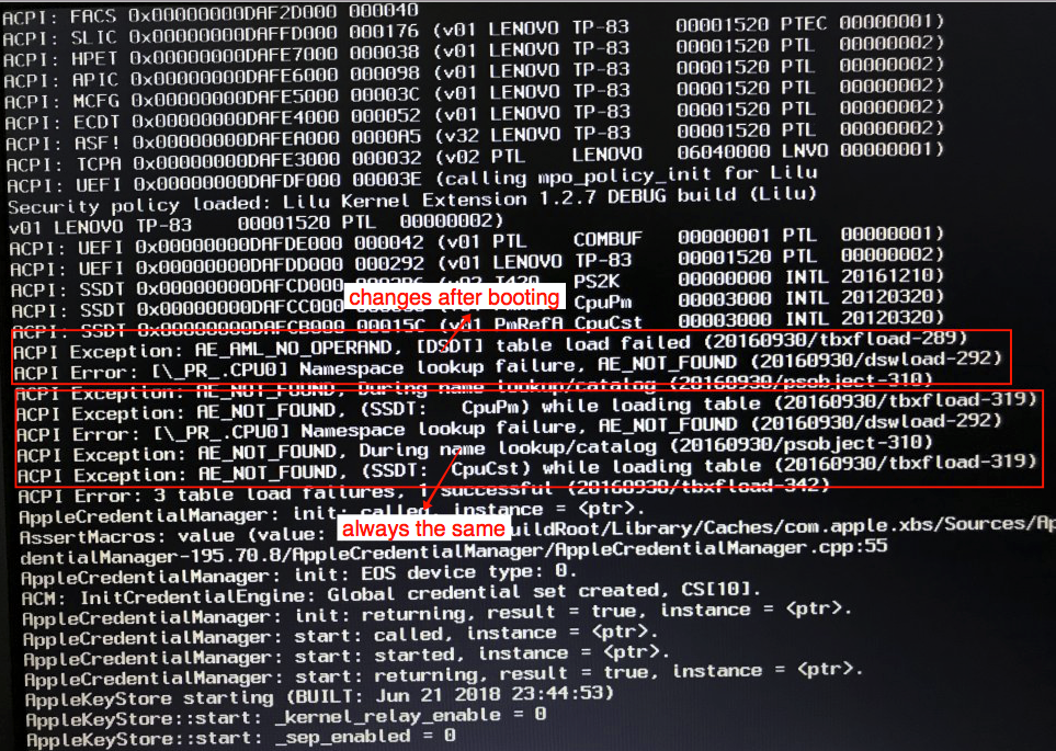

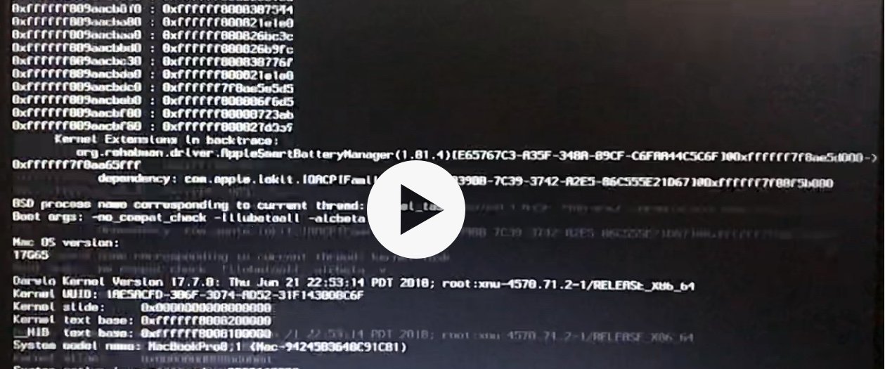

SnuK Posted September 11, 2018 Share Posted September 11, 2018 (edited) Hello together, last weekend I tried around 12h to boot up, always with the similar faults as shown on the picture, just the first message changes: What I did so far: - use clover 4542 and 4509 - use my DSDT - use DSDT from @tluck - use the package from tluck dated August, with my DSDT - use bios default settings and make changes according to this guide - save ACPI tables again and compared with my 1.52: same Always the same result... argh.. The crazy thing is it was working before... The only way to boot into macOS is without DSDT.. then of course nothing is working. Somewhere else I read that macOS has sometimes problem with the installed RAM. So I will organize a few other modules and try again. Keep you updated... UPDATE: Just tried DSDT_1.52_hs from @tluck , same result, see above picture. UPDATE 2: new RAM, same problem Edited September 12, 2018 by SnuK another test Link to comment Share on other sites More sharing options...
n0xius Posted September 11, 2018 Share Posted September 11, 2018 (edited) 36 minutes ago, SnuK said: Hello together, last weekend I tried around 12h to boot up, always with the similar faults as shown on the picture, just the first message changes: What I did so far: - use clover 4542 and 4509 - use my DSDT - use DSDT from @tluck - use the package from tluck dated August, with my DSDT - use bios default settings and make changes according to this guide - save ACPI tables again and compared with my 1.52: same Always the same result... argh.. The crazy thing is it was working before... The only way to boot into macOS is without DSDT.. then of course nothing is working. Somewhere else I read that macOS has sometimes problem with the installed RAM. So I will organize a few other modules and try again. Keep you updated... UPDATE: Just tried DSDT_1.52_hs from @tluck , same result, see above picture. did you set a serial number by any chance? if yes try to boot with it removed Edited September 11, 2018 by n0xius more info Link to comment Share on other sites More sharing options...
tluck Posted September 11, 2018 Share Posted September 11, 2018 (edited) Hmm. can you try with the DSDT most recently provided and this config.plist which will disable all the Clover DSDT edits except fix regions. rename it config.plist or select during Clover startup. note: i forget to mention - this most recent DSDT needs ACPIPoller.kext to handle FAN speed. Obviously this DSDT works for me. @Snuk i took your nicely patched DSDT.dsl and added a few more changes/fixes. then compiled it. config.1600x900.2e3.plist Edited September 11, 2018 by tluck 1 Link to comment Share on other sites More sharing options...

SnuK Posted September 12, 2018 Share Posted September 12, 2018 (edited) Hello again, today I made some more tests, here are the results: - put in another RAM, same problem as described 9/11/2018 at 8:31 PM - boot with my dsdt_1.52 and the config from @tluck actual bundle, same problem as described 9/11/2018 at 8:31 PM - boot with my dsdt_1.52 and tlucks new config config.1600x900.2e3.plist, kernel panic (see attached picture, related to AppleIntelCPUPowerManagement, maybe same problem as @SuperReaper reported) - boot with tlucks dsdt_1.52 and the config from @tluck actual bundle, same problem as described 9/11/2018 at 8:31 PM - boot with tlucks dsdt_1.52 and tlucks new config config.1600x900.2e3.plist, successfully boot into macOS HS, looks good - boot with tlucks dsdt_1.52_hs and the config from @tluck actual bundle, kernel panic (see attached picture, related to AppleIntelCPUPowerManagement, maybe same problem as @SuperReaper reported) - boot with tlucks dsdt_1.52_hs and tlucks new config config.1600x900.2e3.plist, kernel panic (see attached picture, related to AppleSmartBatteryManager, maybe same problem as @SuperReaper reported as well) So again, for me the following is working: tlucks dsdt_1.52 and tlucks new config config.1600x900.2e3.plist! P.S. sorry for the bad pictures, they are captured from slo-mo videos Edited September 12, 2018 by SnuK typo Link to comment Share on other sites More sharing options...

tluck Posted September 12, 2018 Share Posted September 12, 2018 4 hours ago, SnuK said: Hello again, today I made some more tests, here are the results: ... So again, for me the following is working: tlucks dsdt_1.52 and tlucks new config config.1600x900.2e3.plist! Great news. That points to the recent version of Clover breaking the DSDT for some reason (and not for everyone!?) ... as this "working" config.1600x900.2e3.plist has the ACPI DSDT fixes turned off except Fix_regions. But everything is already in the pre-made DSDT except a few things. I will make a few appropriate changes and repost the zip. Note: i found very little difference between the 1.46 DSDT and 1.52 DSDT. Link to comment Share on other sites More sharing options...

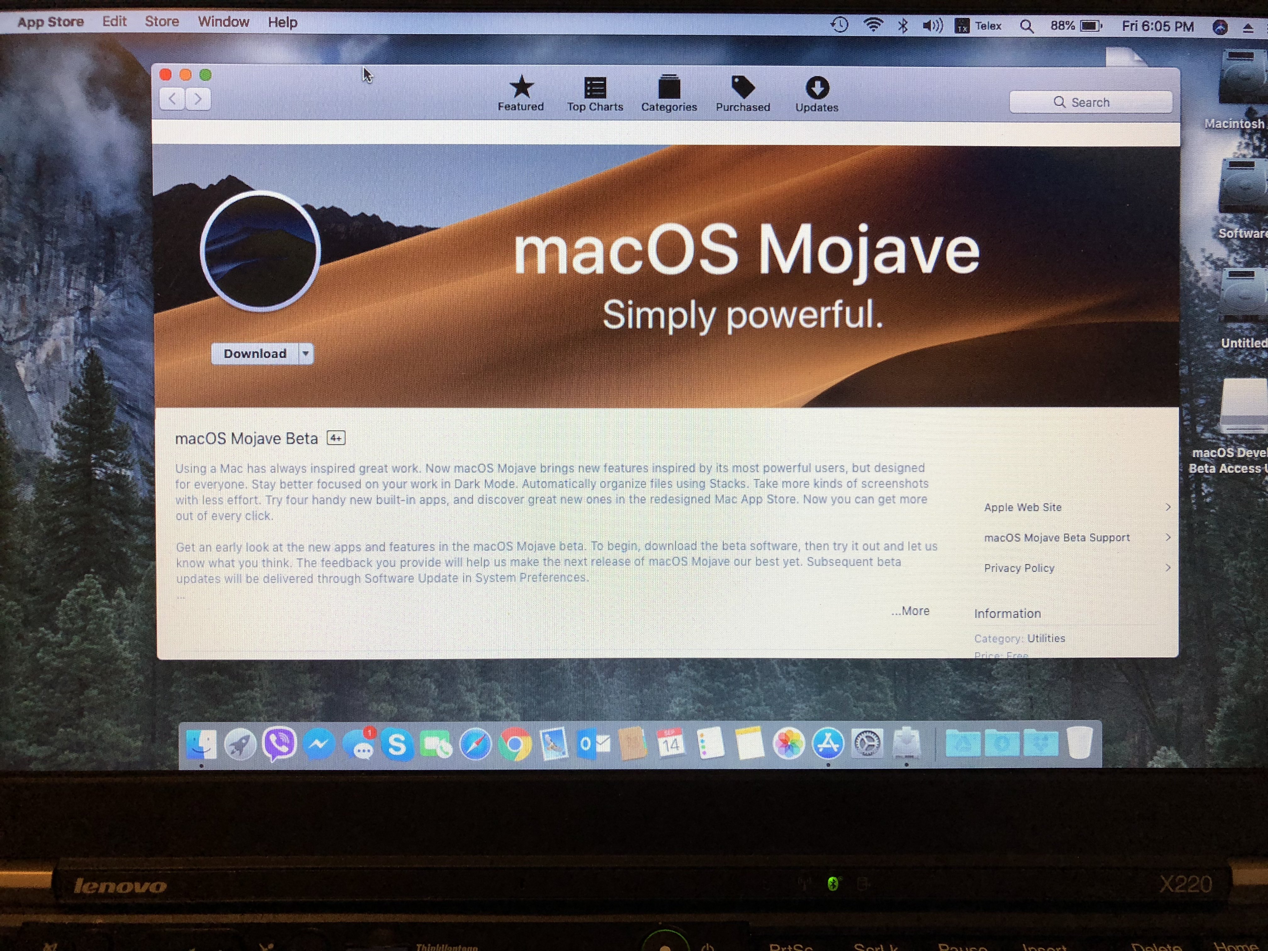

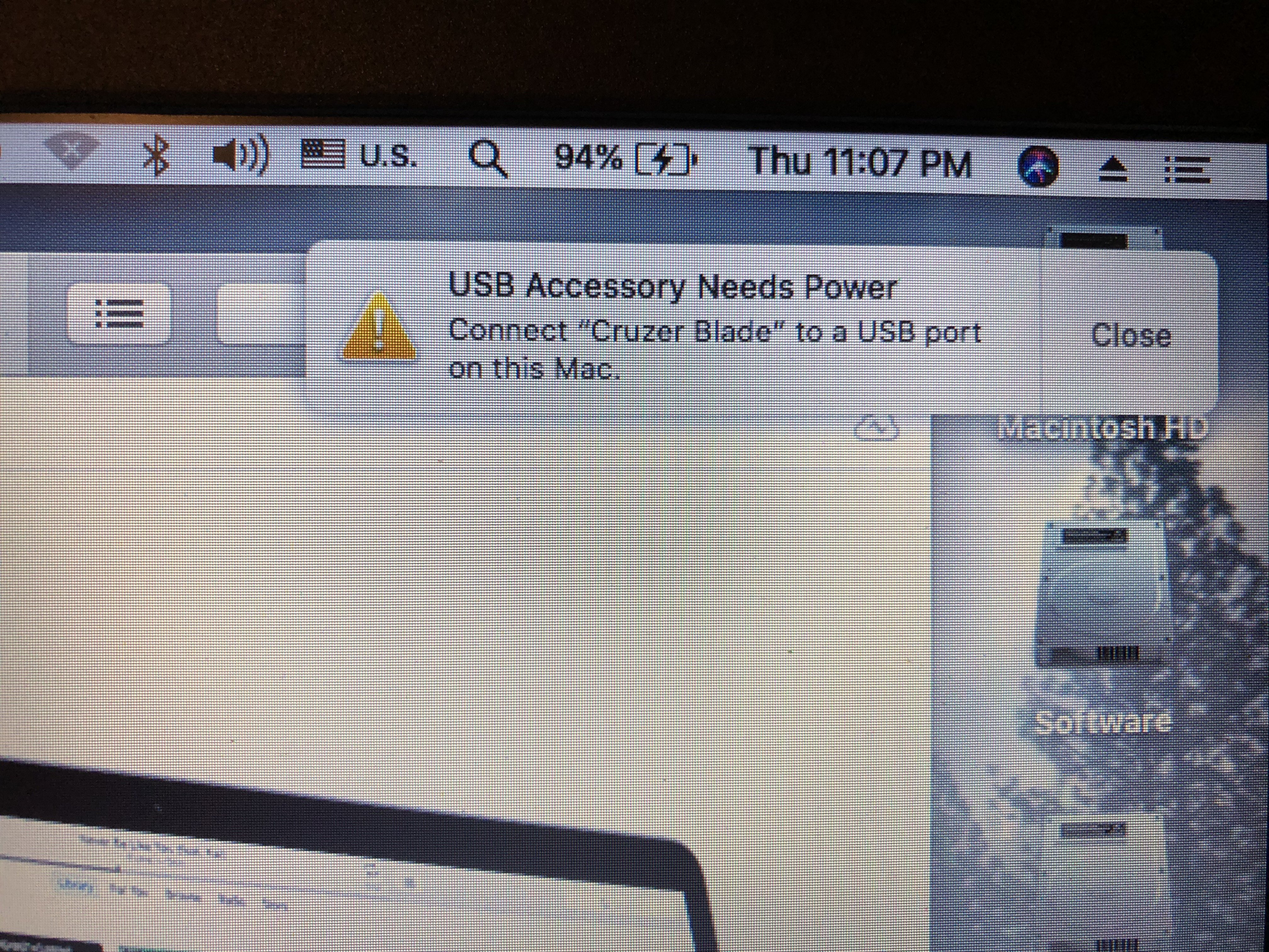

maihoward1985 Posted September 14, 2018 Share Posted September 14, 2018 @Tluck, @Snuk, How to resolve this problem without remove USB Inject All Kext while using Config Mojave?. I am too curious how exactly Mac OS Mojave looked like to that I've decided to give my computer a try by using Mojave Config in Tluck Package. After boot, the MacOS High Sierra recognize my system as MacBook Pro 2013 and also allow me upgrade direct via Apple Store. Besides that, something really strange happened. I can't open Config Mojave Plist file by Clover then I've tried several times before using Plist Edit Pro to check what wrong with it. When Plist Edit Pro opened the config file, there few main information inside has been deleted ( Kext to Patch ... System ... etc ) Link to comment Share on other sites More sharing options...
bedfellow Posted September 14, 2018 Share Posted September 14, 2018 (edited) 42 minutes ago, maihoward1985 said: @Tluck, @Snuk, How to resolve this problem without remove USB Inject All Kext while using Config Mojave?. I am too curious how exactly Mac OS Mojave looked like to that I've decided to give my computer a try by using Mojave Config in Tluck Package. After boot, the MacOS High Sierra recognize my system as MacBook Pro 2013 and also allow me upgrade direct via Apple Store. Are you saying that if mojave.plist is used, then it's possible to update to mojave via Apple Store? I use mojave.plist on a High Sierra install and get the same USB Accessory Needs Power if more than one USB device is plugged in. Edited September 14, 2018 by bedfellow Link to comment Share on other sites More sharing options...
maihoward1985 Posted September 14, 2018 Share Posted September 14, 2018 (edited) @bedfellow Yes. When my machine was identified as Macbook Pro 13, it’s allowed me to update like this way. ( But make sure you already install apple beta or developers profile into your system ). I used same config, same packages i have downloaded from Tluck but i dont know why only X220 was recognized as Macbook Pro 2013. My “new” T420 wasn’t. Edited September 14, 2018 by maihoward1985 Link to comment Share on other sites More sharing options...
maihoward1985 Posted September 14, 2018 Share Posted September 14, 2018 @bedfellow It's may sound little strange. But I used that way while was giving my computer a try to update direct via App Store rather than create the USB installation. One thing I am worry that HD3000 Graphics may lag lol Link to comment Share on other sites More sharing options...
bedfellow Posted September 15, 2018 Share Posted September 15, 2018 53 minutes ago, maihoward1985 said: @bedfellow Yes. When my machine was identified as Macbook Pro 13, it’s allowed me to update like this way. ( But make sure you already install apple beta or developers profile into your system ). I used same config, same packages i have downloaded from Tluck but i dont know why only X220 was recognized as Macbook Pro 2013. My “new” T420 wasn’t. It allows you to update, but did you perform the update? My T420 identifies as MacBook Pro (Retina, 13-Inch, Late 2013) Link to comment Share on other sites More sharing options...

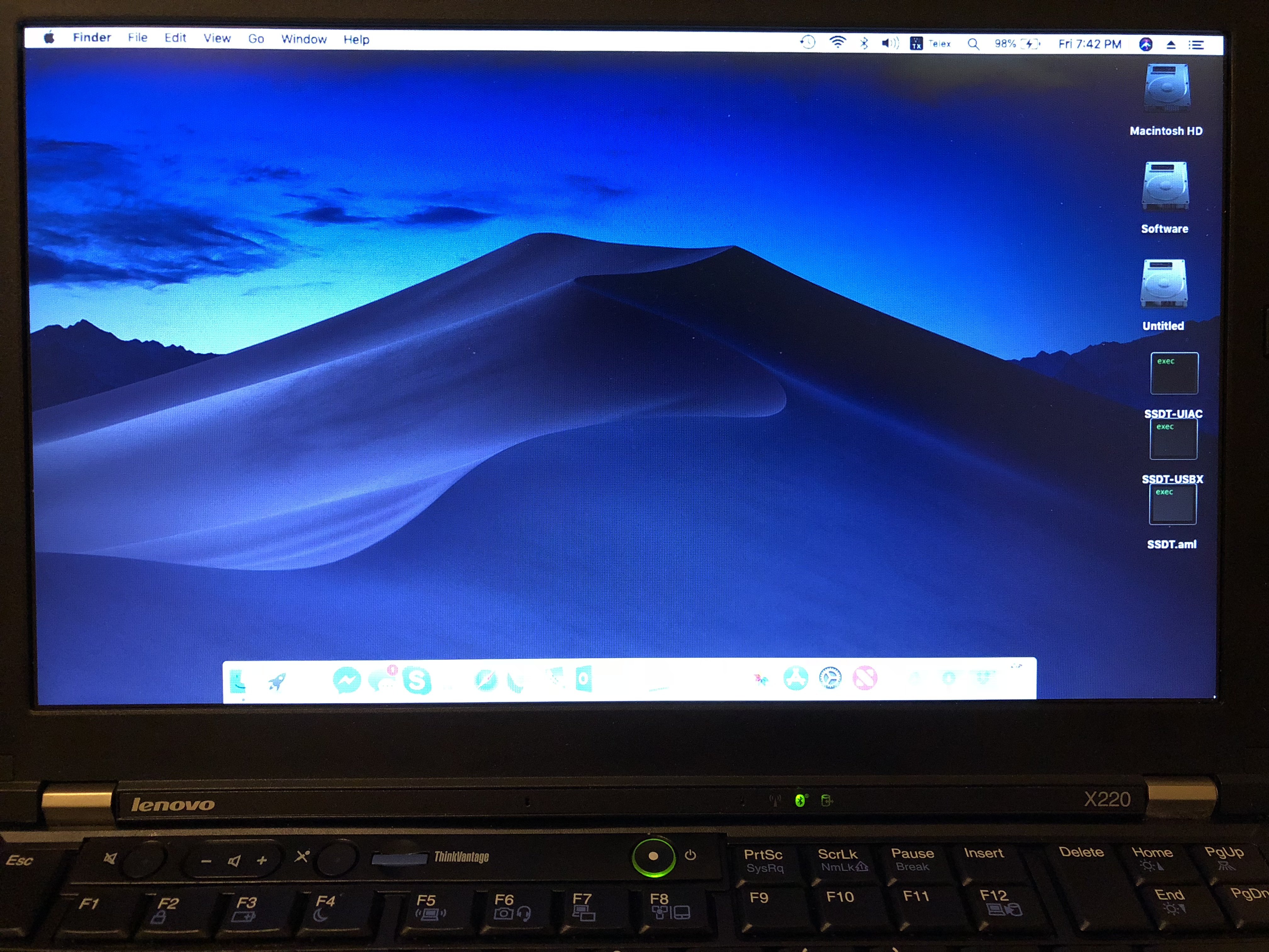

maihoward1985 Posted September 15, 2018 Share Posted September 15, 2018 (edited) 1 hour ago, bedfellow said: It allows you to update, but did you perform the update? My T420 identifies as MacBook Pro (Retina, 13-Inch, Late 2013) Yes. I did. While I was writing reply comments here, my machine was updating by that way. Here is my very first impressions since I was able to update by this way. - Trackpad, Wifi, Speaker ... etc. Still recognized like Native machine. I don't see any problems. - Still able to keep some patched I had used like Night Shift .... - Due to HD3000 is non-metal supporting, there have major lagging. I hope Tluck or anyone else could find away to patch frame or something like this to make the system run more smoothly. - Tluck config Mojave is so amazing !!!! Edited September 15, 2018 by maihoward1985 Link to comment Share on other sites More sharing options...
