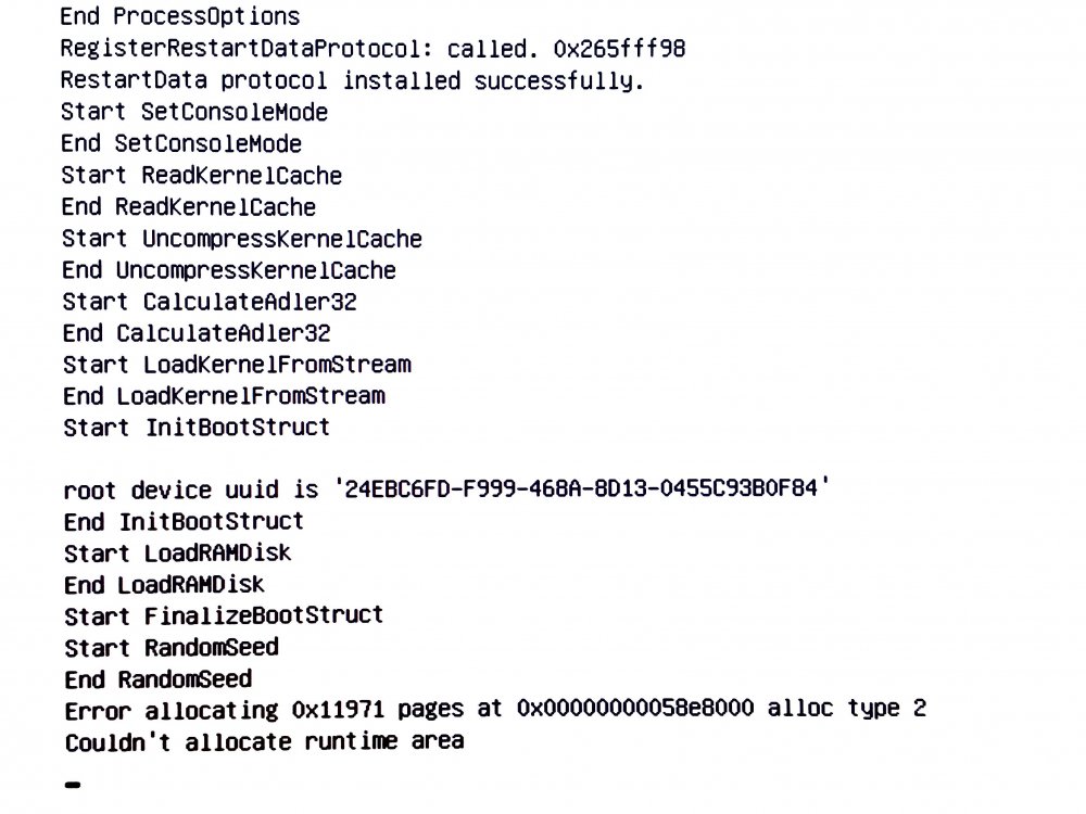

Slice Posted July 29, 2019 Share Posted July 29, 2019 Exclude then HTFS.efi. Windows should boot without it. As well delete HFSplus.efi. Legacy Clover contains such driver. Link to comment Share on other sites More sharing options...
Andres ZeroCross Posted July 29, 2019 Share Posted July 29, 2019 (edited) 19 minutes ago, Slice said: Exclude then HTFS.efi. Windows should boot without it. As well delete HFSplus.efi. Legacy Clover contains such driver. Just use APFSDriverLoader.efi and FSInject.efi but i still get in that error log. I CAN't Reach the GUI CLOVER. Edited July 29, 2019 by Andres ZeroCross Link to comment Share on other sites More sharing options...
Slice Posted July 29, 2019 Share Posted July 29, 2019 The addresses are changed. May be ApfsDriverLoader is fault? Use Apple's apfs.efi. Anyway I have to note that you are not the first who using H61 chipset with IvyBrigde CPU. Link to comment Share on other sites More sharing options...
Andres ZeroCross Posted July 29, 2019 Share Posted July 29, 2019 (edited) 5 minutes ago, Slice said: The addresses are changed. May be ApfsDriverLoader is fault? Use Apple's apfs.efi. Anyway I have to note that you are not the first who using H61 chipset with IvyBrigde CPU. Of course yes, i have build some PC with H61 chipset. The important thing H61 + IvyBridge CPU is set IMEI as 0x1E3A8086 (I just set this with DSDT). Legacy and UEFI with my configurations get no problem with other H61 Chipset. There is something with this "Dell Alienware X51". Will try remove ApfsDriverLoader.efi and report back Edited July 29, 2019 by Andres ZeroCross Link to comment Share on other sites More sharing options...
Andres ZeroCross Posted July 29, 2019 Share Posted July 29, 2019 8 minutes ago, Slice said: The addresses are changed. May be ApfsDriverLoader is fault? Use Apple's apfs.efi. Anyway I have to note that you are not the first who using H61 chipset with IvyBrigde CPU. Just use FSInject.efi in EFI/CLOVER/Drivers/BIOS, still got same error log. Can't reach CLOVER GUI Link to comment Share on other sites More sharing options...
