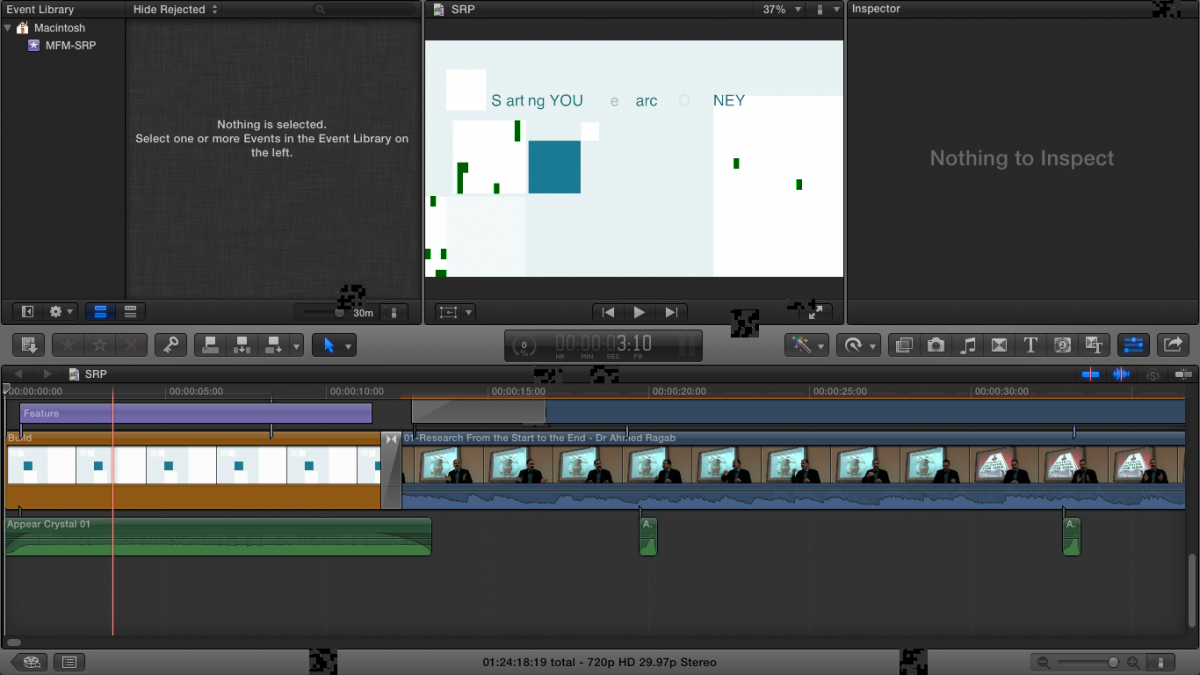

second problem there is problem on intel hd graphics 3000 there is artefacts
this artefacts don't appear with chameleon
here is darwin dump

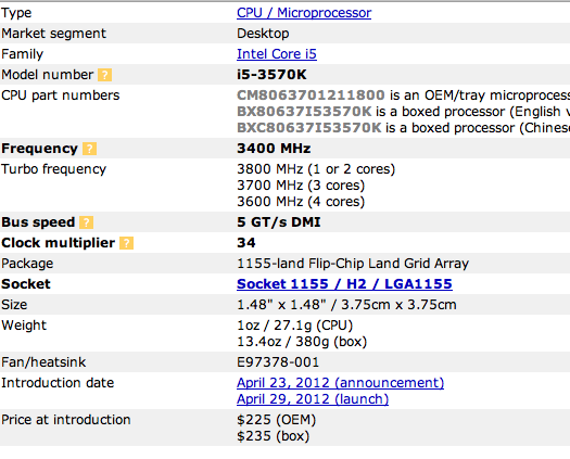

I recently build a new PC with a GA-z77m-dh3-mvp MB, I5-3570K CPU and ATI HD6450 graphics card which is very similar to Apple Computers specifications. The problem is I installed Clover and wanna boot and try a stock installation with Install ESD.dmg downloaded from Apple App Store. I followed this guide here modified the Base System.dmg specifically I added Fakesmc.kext and deleted ATI6000controller.kext which cause KP which according to him. I tried to boot with kext and no cache the computer stucked at the apple logo and the colorful mouse pointer fan keeps spanning and the machine freezes or KP. Any idea how to do the stock install with clover UEFI booting?

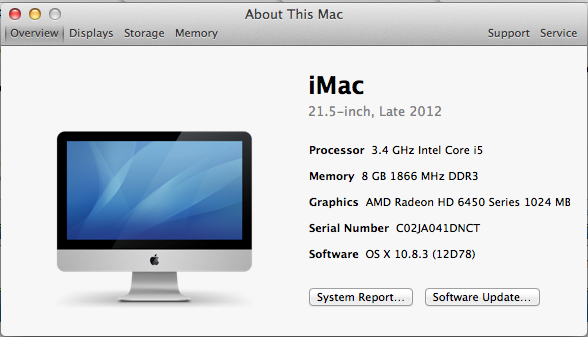

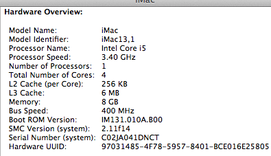

here
b.t.w. after using Clover Bootloader the memory speed of about this apple is not right. I got 4GB*2 DDR3-1600 Mem but it shows 8GB 1868 Mhz RAM. And the CPU info also is wrong. I got a I5-3570k Cpu and the bus speed seems also not right. Is clover not clever enough to identify my Mem? I have already tried 3 SMBIOS settings with config.plist a configuration setting Doc of Clover. It seems Clover is not stable also. How can I help file the bug?
Below is what the about this apple shows:

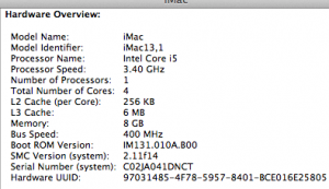

Tested rev 1741 and i've got a memory detection problem.
System info shows "8 Gb ???"
No type and no free or full bank detected in memory tab.
For all that have memory detection with never revision of Clover plz report it here and post your boot.log.
U can also check if new version have some changes about memory detection here, then if u feel lucky :D compile latest version and try it.
I recently build a new PC with a GA-z77m-dh3-mvp MB, I5-3570K CPU and ATI HD6450 graphics card which is very similar to Apple Computers specifications. The problem is I installed Clover and wanna boot and try a stock installation with Install ESD.dmg downloaded from Apple App Store. I followed this guide here to modify the Base System.dmg specifically I added Fakesmc.kext and deleted ATI6000controller.kext which would cause KP according to that guy. I tried to boot with kext and no cache the computer stucked at the apple logo and the colorful mouse pointer fan keeps spanning and the machine freezes or KP. Any idea how to do the stock install with clover UEFI booting?
b.t.w. after using Clover Bootloader the memory speed of about this apple is not right. I got 4GB*2 DDR3-1600 Mem but it shows 8GB 1868 Mhz RAM. And the CPU info also is wrong. I got a I5-3570k Cpu and the bus speed seems also not right. Is clover not clever enough to identify my Mem? I have already tried 3 SMBIOS settings with config.plist a configuration setting Doc of Clover. It seems that Clover is not stable also. It`s been a long time not hackintoshing. I need to catch up with you guys. First things first, how can I help to file the bugs?
And the config.plist setting file attached below.
The DriversUEFI drivers I`m using show below:
Hi.
I would u suggest to try 100% stock instalation without modifing Base System.dmg
U can copy fake smc to clover kext directory and use it from there(when u choose boot volume press space and choose with kext),next to that u will need to remove your ati card when installing soo we dont have problems with that.
U can add it later of course.
Next remove csmvideodxe-64.efi from drivers and add EmuVariableUefi-64.efi for install process.
Memory detection bug will be fixed in new version again,but u can use older version if u dont wanna wait.
I check your config.plist and that will not work for instalation,but its goot for installed system.
