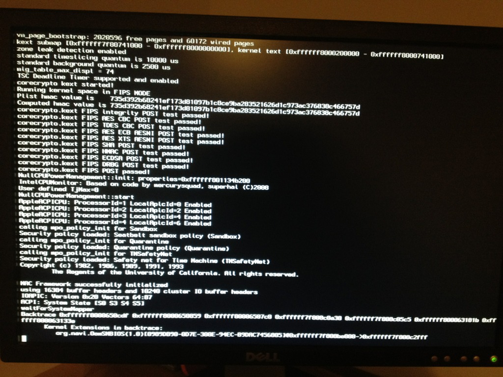

I got this when I updated and rebooted, not a KP - don't know what it is but won't go any further:
Attached File  ImageUploadedByTapatalk1348135718.873424.jpg   217.1KB   280 downloads
...i'm thinking it is a panic...caused by a plugin inside fakesmc.kext(OemSMbios.kext) ...find and remove that...reboot

Removed oemsmbios and repaired permissions etc. now got Voodoohda KP so going to delete that and see what happens
