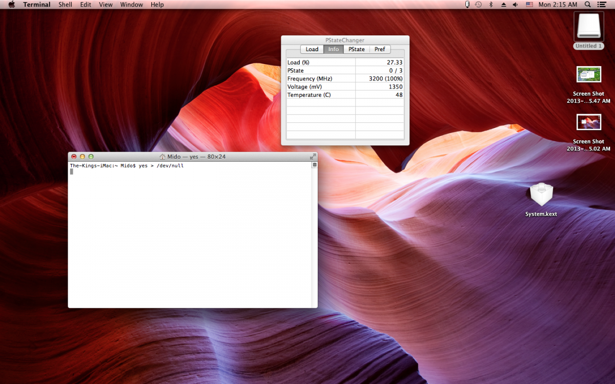

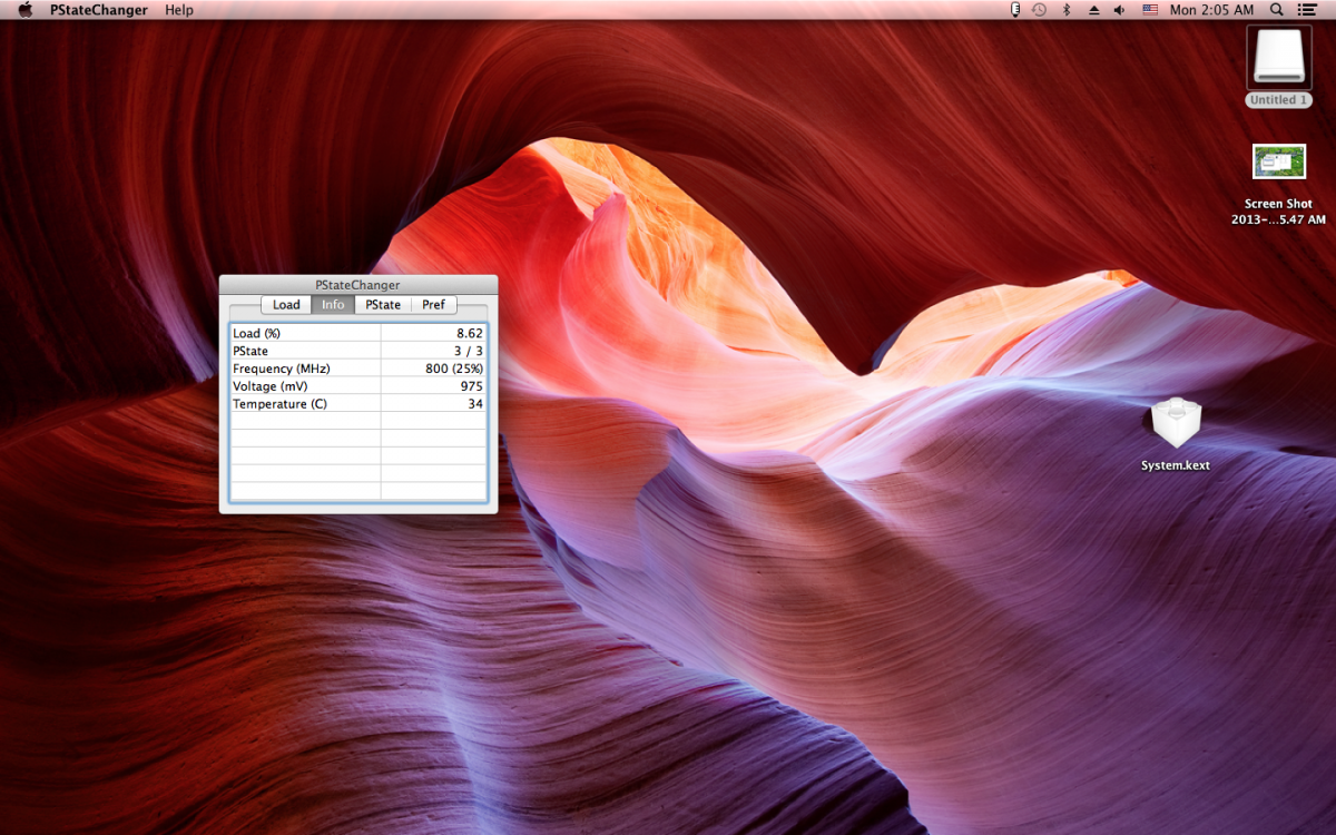

And PM works?
You're able to see and change states with the PStateChanger?

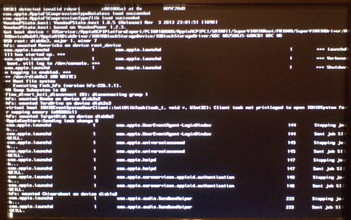

PM Pack and Kernel +VPState + System cleared kernelcache
Stalls at launchd:
Chimera Boot 2.2.1

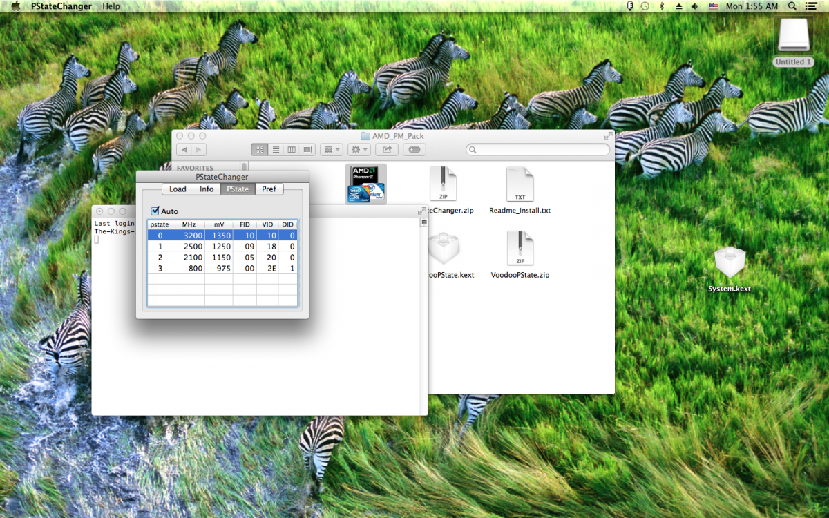

I can change between 4 states
and on load see levels of states but how to confirm

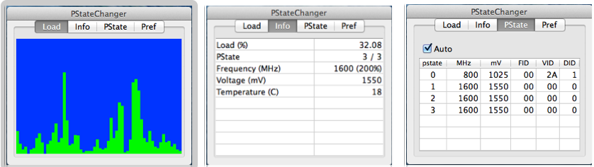

Load still pretty low but frequency is either 100% or 200% Received bad artefacts on the login screen not had them since the first kernel. System doesn't seem and quicker or slower. Temp is lower than it is in Windows lol
Edit: CPU Speed lowered :( Went from factory 2.70 to 1.60 GHz
