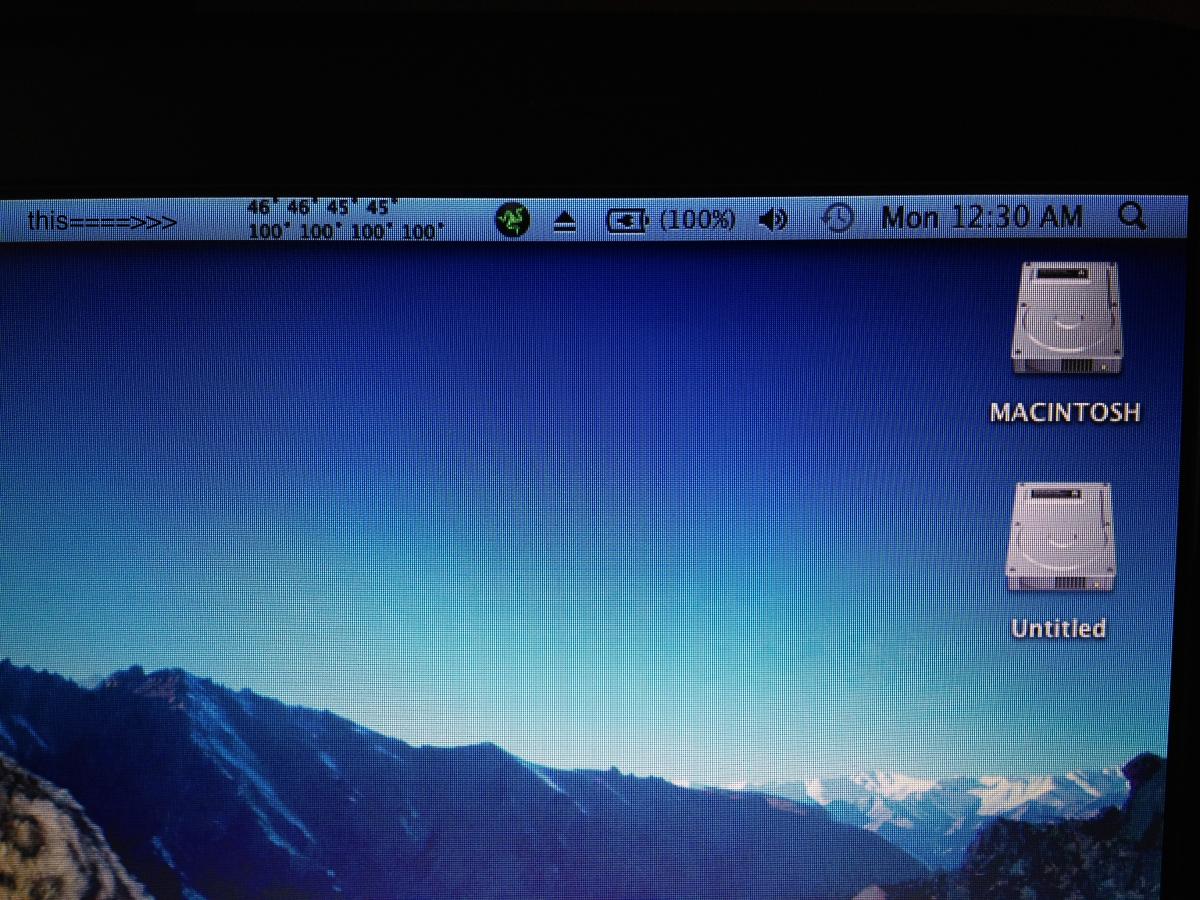

Also, I'm running the smcK-Stat-i app to detect the temps. Are the 100's suppose to say 100?? (See Pic)

Concerning temps :
- As far as I know, the 100° on the second line are for the 4 threads that some CPU's have. As you have a i5 with 4 threads, you only get 4 temps and the 4 others @100°. But I'm not sure of it...

Concerning temps :
