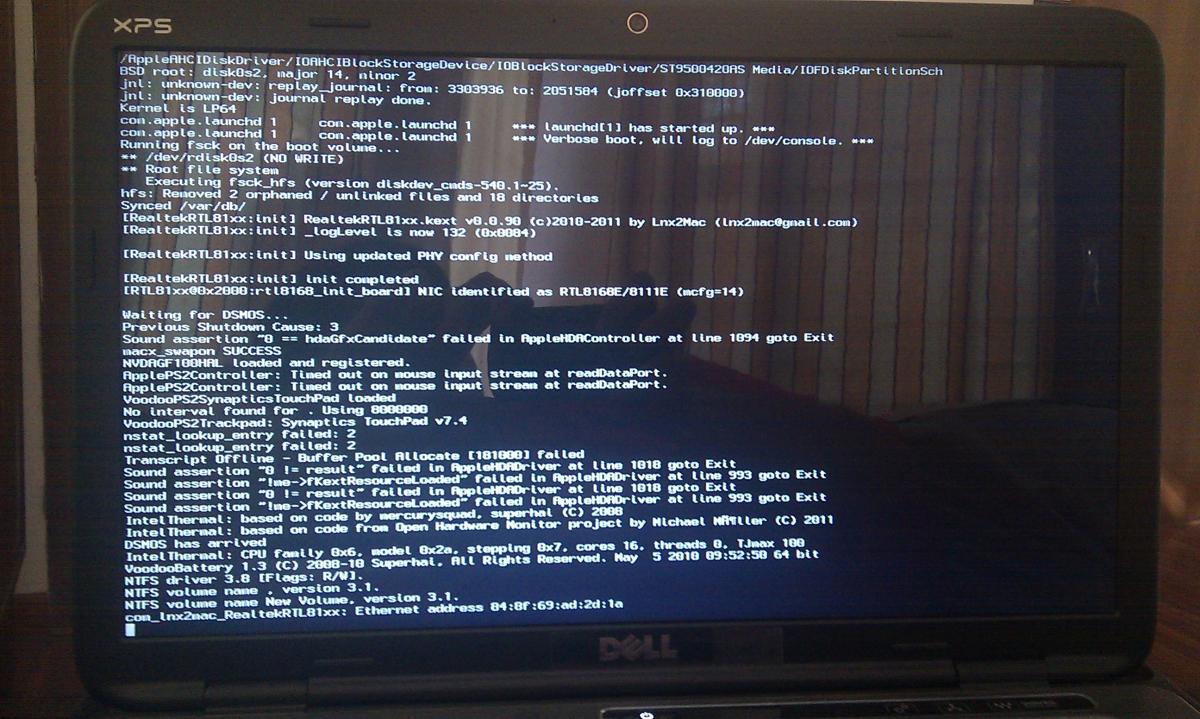

I still need to put the graphics enabler , bus ratio and CPUs flags to get mine to boot , have posted a screen shot in my previous post of the -v boot flag. Waiting patiently for sometime to help me
followed AKennedy_4's guide using iAktos L2 the 10.7.2
after installing all kexts, [url=&quot;http://www.insanelymac.com/forum/topic/279450-why-insanelymac-does-not-support-tonymacx86/&quot;]#####[/url], system definations 8,1 , only HD(not full HD), SSDT 3 step, kext utility, disk utility for repair permission still unable to boot without -v GraphicsEnabler=No busratio=20 cpus=1
bios is 06
any help would be appreciated,
thank you all
The Bus ratio and cpus=1 flag are not neccesary.... Check your Extra/ folder... smbios.plist make sure you have this model set as the "board product" Mac-94245B3640C91C81.. delete if you have any other smbiost.plist file on your root partition. Scrappy_coco pretty much gave you the solution in the post numbered #825

Hey how did you get yours working?
first tell me did you use the retail way of installing mac os lion or did you use iAKTOS L1/L2 ????
oh got it, i read your post. you used iAKTOS lion 10.7.2 same as mine. so this is what you need to do. go to root folder then go to 'Extra' folder. there you will find 'smbios.plist', delete it, you dont need this(beacuse this smbios.plist contains system definition of MacPro3,1). Another 'smbios.plist'(containing system definition of MacBookPro 8,1) already exist in root folder . now in mac dock click 'system preferences', at the bottom click on 'bootloader'. Now in Bootloader select the tab 'bios'. There select the smbios file of your root folder. restart and your system will boot without rBoot-LE cd
Thanks a TON guys! Never realized that it booted with the one using 3,1 instead of the one with which I was seeing which was in another folder. Never realized there were 2 of the smbios.plist files. Now I get it. Thanks a lot for helping me out. Will get my system fully running and let you know about the battery life test. My battery is as good as new as I dont charge/discharge it often. I only use AC power with charging disabled as I use it at home and hence it reduces the charge/discharge cycles giving my battery a greater life.
cheers and again thanks a ton
p.s AKennedy_4 please update your guide about the 2 smbios.plist files being created in the root and in the Extra folder and to delete the one with 3,1 and going to bootloader and changing it to the correct file.
EDIT: sound now works!! l502x one which wasnt working before! I think the problem was that it was loading the older smbios.plist file hence audio and battery didnt work, AKennedy_4 Please update your guide with this info thanks to DoiX and scrappy_coco for solving that problem :)
