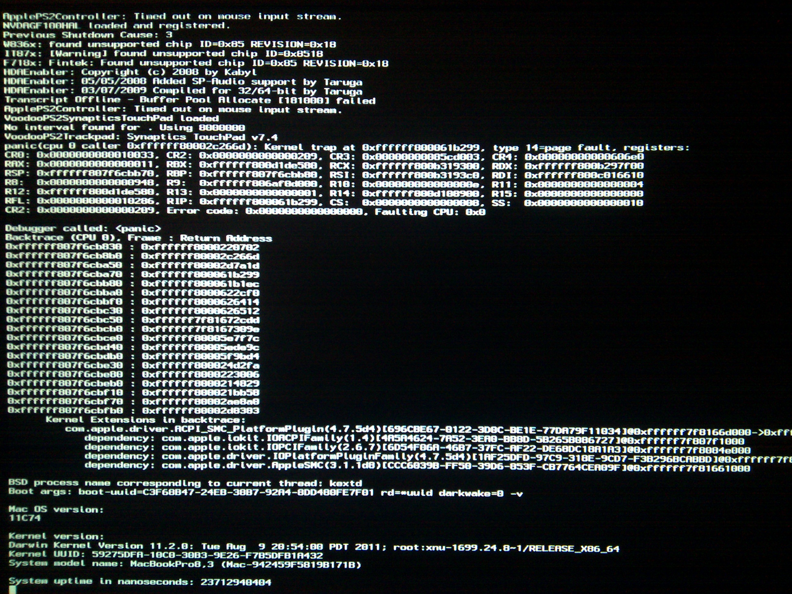

My Dell L702X (with 1030N Bluetooth internally connected via EHCI USB) conflicts with the Audio and connecting an compatible WLAN-Stick results in Kernel Panics, not fully booting or no Bluetooth anymore. And all the time the stick is recognized but not working.
Please boot with -v and cause a kernel panic then upload a picture of it.

@morbidangel, install NullCPUPowerManagement.kext (it's in [url="http://www.insanelymac.com/forum/topic/279450-why-insanelymac-does-not-support-tonymacx86/"]#####[/url]) report if kernel panics still happen.

NullCPUPowermanagement lets me boot up and I had success with the WLAN-Stick, Bluetooth via internal USB does not.
I was able to get everything working, even without NullCPUPowermanagement for some minutes with adding static IRQ to my HPET but at the moment I dont know how to do it correctly.
