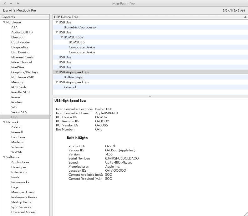

Built-in iSight:
Product ID: 0x213b
Vendor ID: 0x05ac (Apple Inc.)
Version: 4.35
Speed: Up to 480 Mb/sec
Manufacturer: Apple Inc.
Location ID: 0xfa100000
Current Available (mA): 500
Current Required (mA): 500

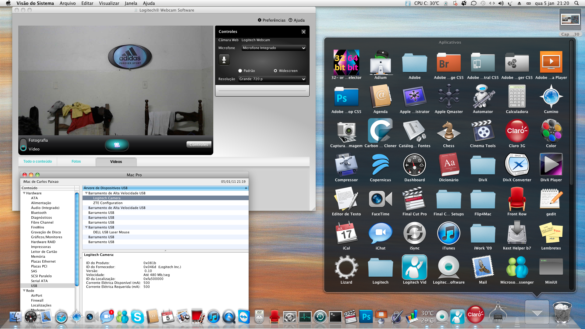

I have a Dell Inspiron 1720 with the Dell Integrated Webcam.
Product ID: 9792
Vendor ID: 1449
Once I added these numbers in the three locations in the Info.plist, the webcam was recognized as an internal iSight. Thanks very much for this driver.
