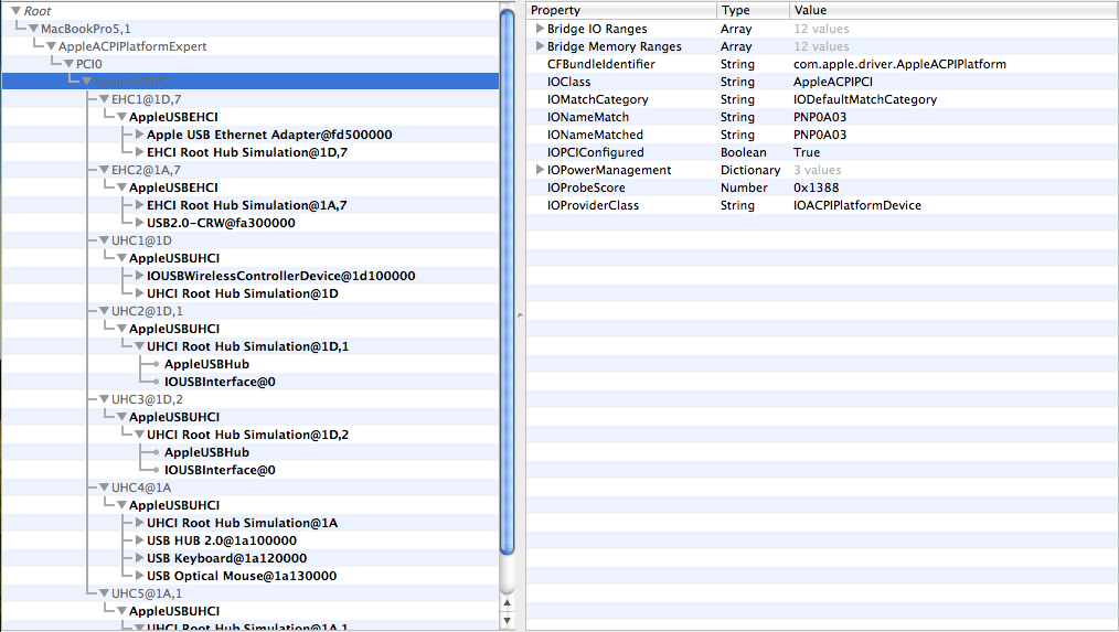

I'm having troubling applying this same concept to patching my ICH8-based laptop. The relevant output from lspci is:
00:1a.0 USB Controller [0c03]: Intel Corporation 82801H (ICH8 Family) USB UHCI Contoller #4 [8086:2834] (rev 03)
00:1a.1 USB Controller [0c03]: Intel Corporation 82801H (ICH8 Family) USB UHCI Controller #5 [8086:2835] (rev 03)
00:1a.7 USB Controller [0c03]: Intel Corporation 82801H (ICH8 Family) USB2 EHCI Controller #2 [8086:283a] (rev 03)
00:1d.0 USB Controller [0c03]: Intel Corporation 82801H (ICH8 Family) USB UHCI Controller #1 [8086:2830] (rev 03)
00:1d.1 USB Controller [0c03]: Intel Corporation 82801H (ICH8 Family) USB UHCI Controller #2 [8086:2831] (rev 03)
00:1d.2 USB Controller [0c03]: Intel Corporation 82801H (ICH8 Family) USB UHCI Controller #3 [8086:2832] (rev 03)
00:1d.7 USB Controller [0c03]: Intel Corporation 82801H (ICH8 Family) USB2 EHCI Controller #1 [8086:2836] (rev 03)
Using the same convention as the first post, this is cross referenced as follows:
USB 1: 1D  2830
USB 2: 1D, 1: 2831
USB 3: 1D, 2: 2832
USB 4: 1A: 2834
USB 5: 1A,1: 2835
EHCI 1: 1D, 7: 2836
EHCI 2: 1A, 7: 283a
I changed my DSDT code to the following:

I have the DTGP Method defined earlier in my DSDT. But, there is no effect on sleep! If I let the laptop go into "sleep" on its own, it only has "display sleep" and will waken upon keyboard or mouse. If I manually sleep through the Apple menu, it goes into some form of pseudosleep, but doesn't wake up, having to be powered off and then on. I'm not sure if its real sleep that it goes into, because this is a laptop that, at least on Windows, has a logo that is lit when on, and off when sleeping or powered down. That logo remains lit even with manual sleep. Can anyone give me any ideas?
I saw this other post about applying a similar fix for ICH8, but it wouldn't compile for me.
Jonas_S mate, for every Device (USBxx) you should insert (via DTGP) the corresponding device-id. Namely, for ICH8 devices that you posted:
USB1 - UHCI Controller #1 = "device-id"  0x30, 0x28, 0x00, 0x00
USB2 - UHCI Controller #2 = "device-id"  0x31, 0x28, 0x00, 0x00
USB3 - UHCI Controller #3 = "device-id"  0x32, 0x28, 0x00, 0x00
USB4 - UHCI Controller #4 = "device-id"  0x34, 0x28, 0x00, 0x00
USB5 - UHCI Controller #5 = "device-id"  0x35, 0x28, 0x00, 0x00
EHC1 - EHCI Controller #1 = "device-id"  0x36, 0x28, 0x00, 0x00
EHC2 - EHCI Controller #2 = "device-id"  0x3A, 0x28, 0x00, 0x00
...and not the IDs you've inserted in your code. They are wrong...

I introduce my conditions:
First ,I rename the Device (USB1) to Device (UHC1).....(USB5) to Device (UHC5),and other place when you get errors.So I just rename "USB" t o "UHC",and add the code under the Device (EHC1) and Device (EHC2) like this
				Store (Package (0x0B)
						"AAPL,clock-id",
						Buffer (One)
							0x01
						"device_type",
						Buffer (0x05)
							"EHCI"
						"AAPL,current-available",
						0x04B0,
						"AAPL,current-extra",
						0x02BC,
						"AAPL,current-in-sleep",
						0x03E8,
						Buffer (One)
							0x00
					}, Local0)
				Return (Local0)
,then I can get computer sleep as well .Here is my DSDT:dsdt.aml.zip

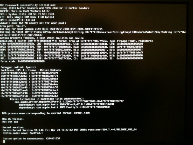

Hi All,
I'm still learning how to patch DSDT to make AHCI and speedstep work on my ABit IB9 motherboard with Q6600 CPU.
ABit IB9 using ICH8 chipset. so:
For AHCI, I tried both ESB 2 (2681) and ICH8MAHCI (2829), but both give me KP. I attached screen shot.
For speedstep, I keep getting KP as "CPU 1 has no HPET assigned to it" without NullCPUManagement.kext.
I'm using MacPro3,1 model in my smbios.plist. Running 10.6.4 with all latest update.
Attached is my current DSDT (without AHCI device-id).
lspci -nn
00:00.0 Host bridge [0600]: Intel Corporation 82P965/G965 Memory Controller Hub [8086:29a0] (rev 02)
00:01.0 PCI bridge [0604]: Intel Corporation 82P965/G965 PCI Express Root Port [8086:29a1] (rev 02)
00:1a.0 USB Controller [0c03]: Intel Corporation 82801H (ICH8 Family) USB UHCI Controller #4 [8086:2834] (rev 02)
00:1a.1 USB Controller [0c03]: Intel Corporation 82801H (ICH8 Family) USB UHCI Controller #5 [8086:2835] (rev 02)
00:1a.7 USB Controller [0c03]: Intel Corporation 82801H (ICH8 Family) USB2 EHCI Controller #2 [8086:283a] (rev 02)
00:1b.0 Audio device [0403]: Intel Corporation 82801H (ICH8 Family) HD Audio Controller [8086:284b] (rev 02)
00:1d.0 USB Controller [0c03]: Intel Corporation 82801H (ICH8 Family) USB UHCI Controller #1 [8086:2830] (rev 02)
00:1d.1 USB Controller [0c03]: Intel Corporation 82801H (ICH8 Family) USB UHCI Controller #2 [8086:2831] (rev 02)
00:1d.2 USB Controller [0c03]: Intel Corporation 82801H (ICH8 Family) USB UHCI Controller #3 [8086:2832] (rev 02)
00:1d.7 USB Controller [0c03]: Intel Corporation 82801H (ICH8 Family) USB2 EHCI Controller #1 [8086:2836] (rev 02)
00:1e.0 PCI bridge [0604]: Intel Corporation 82801 PCI Bridge [8086:244e] (rev f2)
00:1f.0 ISA bridge [0601]: Intel Corporation 82801HB/HR (ICH8/R) LPC Interface Controller [8086:2810] (rev 02)
00:1f.2 IDE interface [0101]: Intel Corporation 82801H (ICH8 Family) 4 port SATA IDE Controller [8086:2820] (rev 02)
00:1f.3 SMBus [0c05]: Intel Corporation 82801H (ICH8 Family) SMBus Controller [8086:283e] (rev 02)
00:1f.5 IDE interface [0101]: Intel Corporation 82801H (ICH8 Family) 2 port SATA IDE Controller [8086:2825] (rev 02)
01:00.0 VGA compatible controller [0300]: nVidia Corporation G84 [GeForce 8600 GTS] [10de:0400] (rev a1)
02:01.0 Ethernet controller [0200]: Realtek Semiconductor Co., Ltd. RTL-8110SC/8169SC Gigabit Ethernet [10ec:8167] (rev 10)
kextstat | grep LPC
59	0 0xffffff7f80f52000 0x3000	 0x3000	 com.apple.driver.AppleLPC (1.4.12) <9 5 4 3>
Can somebody please help me to take a look? Let me know if you need more information.
Thanks a lot
Noodle
DSDT.zip

p.s.
I'm using MacBookPro6,2 in my smbios.plist. (as this one is closest to mine http://www.everymac.com/systems/apple/macb...ody-specs.html)
--- EDIT---
I've attached pure DSDT from everest. I can't compile it in untouched form (201 errors). I've made it able to compile using some autopacher but can't remember which one....
If someone can have a look and try to compile, please.
Thanks in advance,
fingerr.
