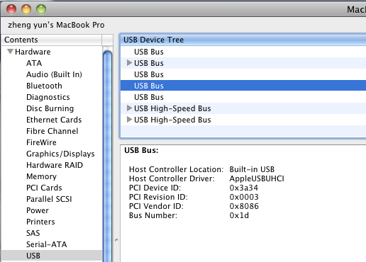

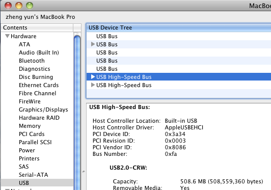

Zprood Posted January 1, 2010 Share Posted January 1, 2010 Hi guys ,i have fixed the sleep problem about Intel ich8 family. OK,i give the method. First, you must have these thins, your dsdt.dsl should have five USB Devices such as ,Device (USB1)......Device (USB5) ,Device (EHC1 and EHC2) . Also the IDs are : DeviceIDs Intel USB1 - 0x2830 USB2 - 0x2831 USB3 - 0x2832 USB4 - 0x2834 USB5 - 0x2835 EHC1 - 0x2836 EHC2 - 0x283a Now,let`s do it. 1, Rename the Device (USB1)......Device (USB5) to Device (UHC1)......Device (UHC5) and add the code in each Device Method (_DSM, 4, NotSerialized) { Store (Package (0x0f) { "device-id", Buffer (0x04) { 0x34, 0x3A, 0x00, 0x00 }, "AAPL,clock-id", Buffer (One) { 0x0a }, "built-in", Buffer () { 0x00 }, "device_type", //not sure it is useful Buffer (0x05) { "EHCI" }, "AAPL,current-available", 0x04B0, "AAPL,current-extra", 0x02BC, "AAPL,current-in-sleep", 0x03E8, Buffer (0x01) { 0x00 } }, Local0) DTGP (Arg0, Arg1, Arg2, Arg3, RefOf (Local0)) Return (Local0) } 2, now compile dsdt.dsl to dsdt. aml and replace it ,reboot. 3, then check your usb information ,if they are the "Built -in USB" ,you can click sleep .that`s my work . I hope you can post the result and give you advice. my dsdt : DSDT.dsl.zip it`s my dsdt Link to comment https://www.insanelymac.com/forum/topic/205239-fixed-ich8-usb-sleep-problem/ Share on other sites More sharing options...
