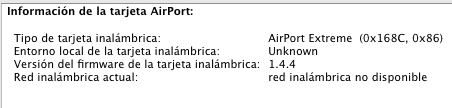

LiquidSnake Posted May 18, 2009 Share Posted May 18, 2009 EDIT: Ignore this reply since you have found the solution. Have you try to write with other GPIO (-g) value? Please read ath_info.c file for more information. kizwan Many thx for your quick answer, now i have the card looking like: 02:00.0 Network controller: Atheros Communications, Inc. AR5006EG 802.11 b/g Wireless PCI Express Adapter (rev 01) lspci -v : 02:00.0 Network controller: Atheros Communications, Inc. AR5006EG 802.11 b/g Wireless PCI Express Adapter (rev 01) Subsystem: Apple Computer Inc. Device 0086 Flags: fast devsel Memory at <unassigned> (64-bit, non-prefetchable) [disabled] Capabilities: [40] Power Management version 2 Capabilities: [50] Message Signalled Interrupts: Mask- 64bit- Queue=0/0 Enable- Capabilities: [60] Express Legacy Endpoint, MSI 00 Capabilities: [90] MSI-X: Enable- Mask- TabSize=1 Capabilities: [100] #168c Capabilities: [001] #1c16 now i have this on dmesg: (same as before rebranding.) ath_attach: devid 0x1c unable to attach hardware; HAL status 13 start [/SourceCache/AirPortDriverAtheros5424/AirPortDriverAtheros5424-314.43.1/src/driver/AtherosController.cpp:516] loaded unsuccessfully any suggests? Link to comment Share on other sites More sharing options...
kizwan Posted May 18, 2009 Share Posted May 18, 2009 02:00.0 Network controller: Atheros Communications, Inc. AR5006EG 802.11 b/g Wireless PCI Express Adapter (rev 01) lspci -v : 02:00.0 Network controller: Atheros Communications, Inc. AR5006EG 802.11 b/g Wireless PCI Express Adapter (rev 01) Subsystem: Apple Computer Inc. Device 0086 Flags: fast devsel Memory at <unassigned> (64-bit, non-prefetchable) [disabled] Capabilities: [40] Power Management version 2 Capabilities: [50] Message Signalled Interrupts: Mask- 64bit- Queue=0/0 Enable- Capabilities: [60] Express Legacy Endpoint, MSI 00 Capabilities: [90] MSI-X: Enable- Mask- TabSize=1 Capabilities: [100] #168c Capabilities: [001] #1c16 Looks like successful rebranding, but I don't have any idea why it still not working. I assume you have tried cool-boot your laptop, right? Maybe you can try to boot to windows (if you have dual boot with windows), turn on your wireless card & reboot to OS X. kizwan Link to comment Share on other sites More sharing options...
LiquidSnake Posted May 18, 2009 Share Posted May 18, 2009 Looks like successful rebranding, but I don't have any idea why it still not working. I assume you have tried cool-boot your laptop, right? Maybe you can try to boot to windows (if you have dual boot with windows), turn on your wireless card & reboot to OS X. kizwan fail! i dont have any other os than osx on the wind. the backtrack i have it on a sdcard (wireless spoofing - aircrack-ng) the card seems to work well on linux Link to comment Share on other sites More sharing options...
