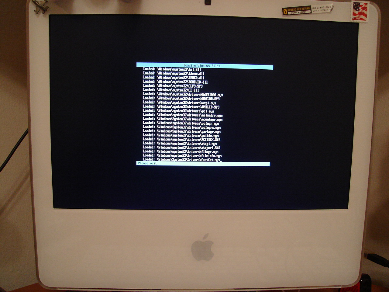

Also I am now at the same point that NAK managed where he could access the Vista boot menu and try and boot into safe mode. Just as in his case I reached the point where crcdisk.sys loads and vista is supposed to boot into the desktop but instead the iMac reboots entirely. I'm gonna try to run sysprep on the vista install and see if that helps any.

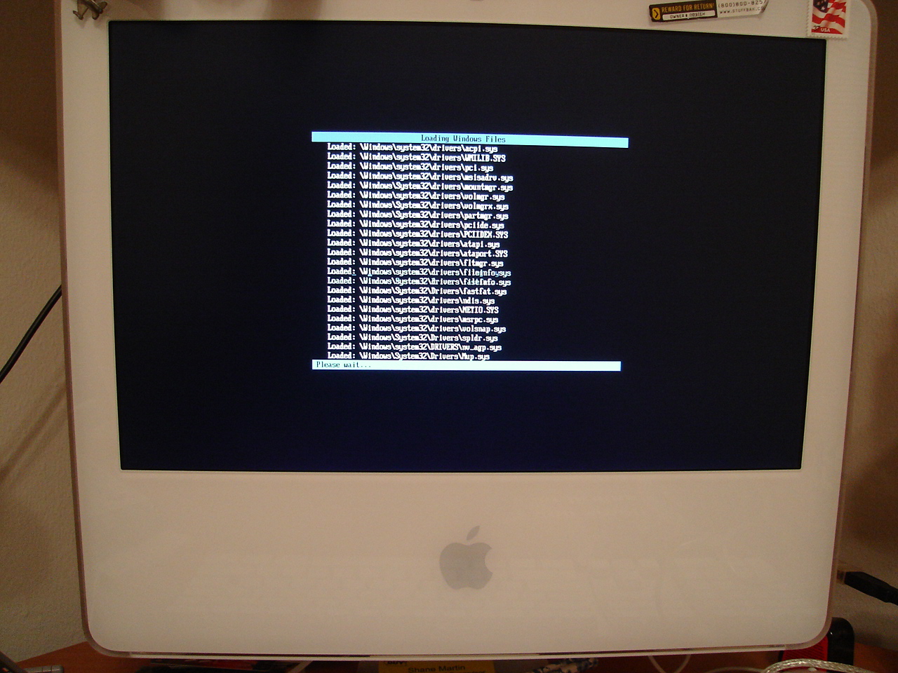

Well after further playing I think its safe to say that booting Vista via EFI works. I don't think the reboot is really EFI releated now (though you never know I could be wrong). I doubt that the lack of UGA support is the cause of windows rebooting right before it reaches the desktop but there's no way of really knowing at this time and its definitely not the file system causing the problem as it boots on a regular PC fine. SO what could it be.... ;)

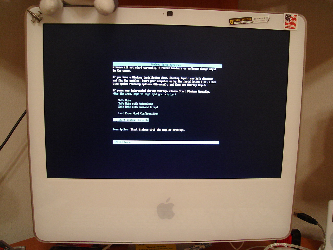

I looked at crcdisk.sys description: "Disk Block Verification Filter Driver" But I don't know what ii verifies.
But I read after a search on google that a couple of people had a problem with that file on their windows machines too. I will look into when I have more time.
I also found a list of the files vista 6.0 5270 boots before a first screen init with a mouse (the guy had a different problem) Maybe that might help to determine the driver which is causing the problem:

I myself don't have an intel iMac (yet) but I would like to see some windows booting on one before I get one myself :).
So thanks for the help of you guys who try this...
crcdisk.sys error can also happen when multiple OS are installed on the same computer, for example, if you install winServer2003 and after you install winXP (even on another driver) , it will freeze when it will try to load crcdisk.sys (like you have) because winXP is older than winServer2003 ...
don't ask me why , i dont know ...
then to test correclty you have to totaly erase OSX , and put winVISTA on the primary hard driver (the one where is OSX i mean) and try to boot again...
to do that i dont know how because i dont have an iMac here ...
but try to start the iMac as a external harddriver and connect it to your windows box to erase every thing and put WinVISTA ..
like that you will have only vista on it .. and it will be more clean to test like this ...

This may have to do with the SATA driver Vista is using for the iMac's drive. Recent Vista builds have had buggy/broken SATA support. Try loading an XP SATA driver from i386 and make sure that it works with your iMac's SATA drive first.
EDIT: Actually, Vista Beta 1's SATA drivers should work well, try them?
EDIT2: Actually, if 5270's EFI loader works, try using it to load a copy of Vista Beta 1 using the procedure you used before. GL!

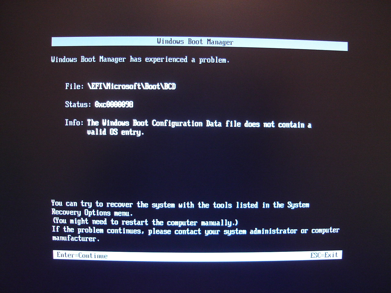

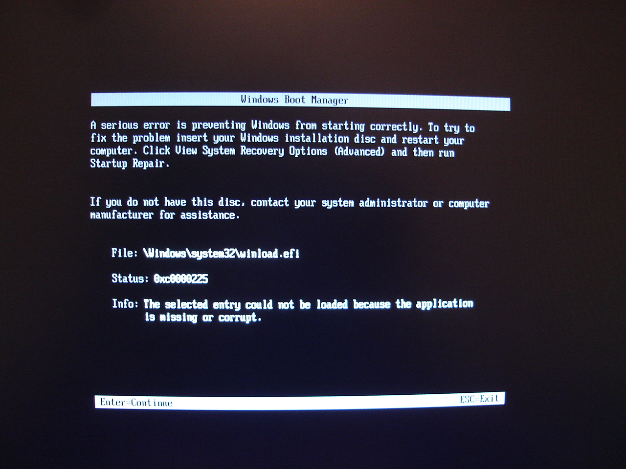

Also I've hit a new snag that I just started working with. I discovered that vista reboots even if you try and boot it via the USB drive on a regular PC so I repartitioned the iMac and created a 2nd 20GB FAT32 Partition BUT now the loader is complaining it can't find /windows/system/winload.efi even though it IS there. I'm thinking this may be because it was hunting for an install located on the first partition of a drive (if I leave the USB drive connected and load the bootmgfw.efi file off the iMac partition it still tries to load windows off the USB drive.) I have Vista installed on the second partition on my laptop so I'm gonna edit the BCD file off that and see if that works as its pointing at partition #2.
UPDATE: OK that didn't work....I realize though now that the iMac really has 3 partitions (the EFI Hidden FAT, OSX HFS+, and Vista FAT32) so I need a matching BCD that says its on partition 3. Will try reinstalling using this combination and see where I get.
Yea thats on my list on things to try also. Thanks for the tip.
Still not having any luck on booting from the FAT32 partition though. I can't figure out how to get the BCD to point at it. Still keeps trying to load off the USB drive. I noticed it only loads off the USB drive if its the first drive listed in the EFI menu (USB drives are always listed first if connected at startup)

As a heads up I seem to have gotten to make the machine boot off the local Hard Drive finally (though I'm not exactly sure what I did as I was just fuddling at that time. I'll have to look in detail later) but it still reboots and at least in this config I lost the ability to use F8 on that partition too. On a side to that I also discovered that once the bootmanager is loaded it can read NTFS drives even if the EFI doesn't see it as I put vista back on an NTFS partition on the USB drive and it started loading. Also and this may be a bit more significant....I had installed XP on another partition on the drive and so it showed up on the bootloader. It started do...well..SOMETHING as I had hard drive activity when I selected the Legacy OS boot option. Problem is I couldn't see anything on the screen and the PC rebooted itself after which it told me it couldn't find NTLDR anymore.
