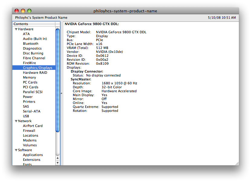

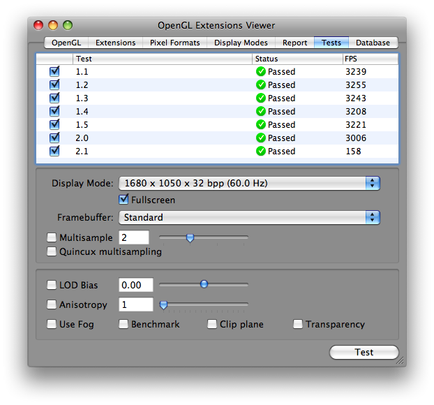

theory Posted May 10, 2008 Share Posted May 10, 2008 Thank you aqua-mac for making this work! (The GFX strings method worked best on my Leadtek PX9800GTX.) Link to comment https://www.insanelymac.com/forum/topic/98666-9800-gtx-working-in-osx86/page/4/#findComment-741563 Share on other sites More sharing options...
aqua-mac Posted May 10, 2008 Author Share Posted May 10, 2008 Hi Theory, Glad it worked for you and thanks for letting me know it worked! Link to comment https://www.insanelymac.com/forum/topic/98666-9800-gtx-working-in-osx86/page/4/#findComment-741603 Share on other sites More sharing options...
