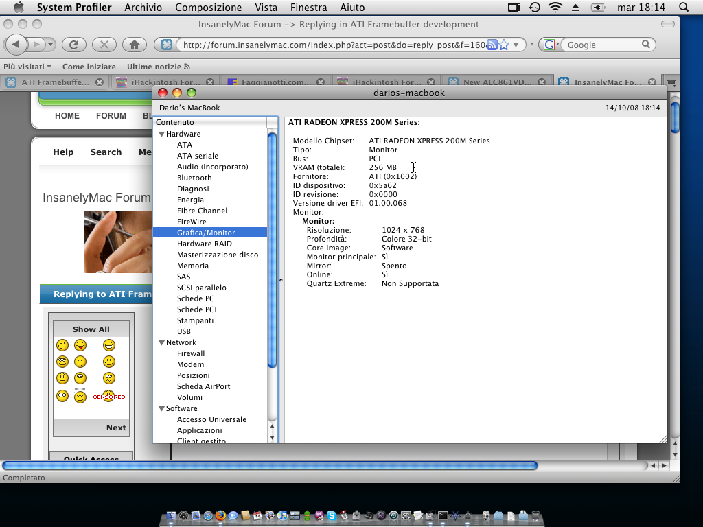

I'd like to try these two kexts (ATILead and ATI) but I'm not sure what to edit in the Info.plist of ATILead.kext. I've read through the thread but I'm having trouble understanding exactly what I should edit.
My card is a Radeon X300 Mobility (it shows up as an M300 (M22) under System Profiler, although it's really supposed to be M24), the device ID is 0x5460, and right now I've got native resolution of 1920x1200@32 using Callisto (but of course no QE/CI). It's a PCIe card, would this possibly work with the kexts?
I understand that I'm supposed to edit the Info.plist to add my device ID and the resolution, but I could use a little help on where to put this info and in what format.
Has anyone managed to get X1300 mobility to native resolution on an internal screen?
I am trying to get 1280X800, but only get 1024x768.

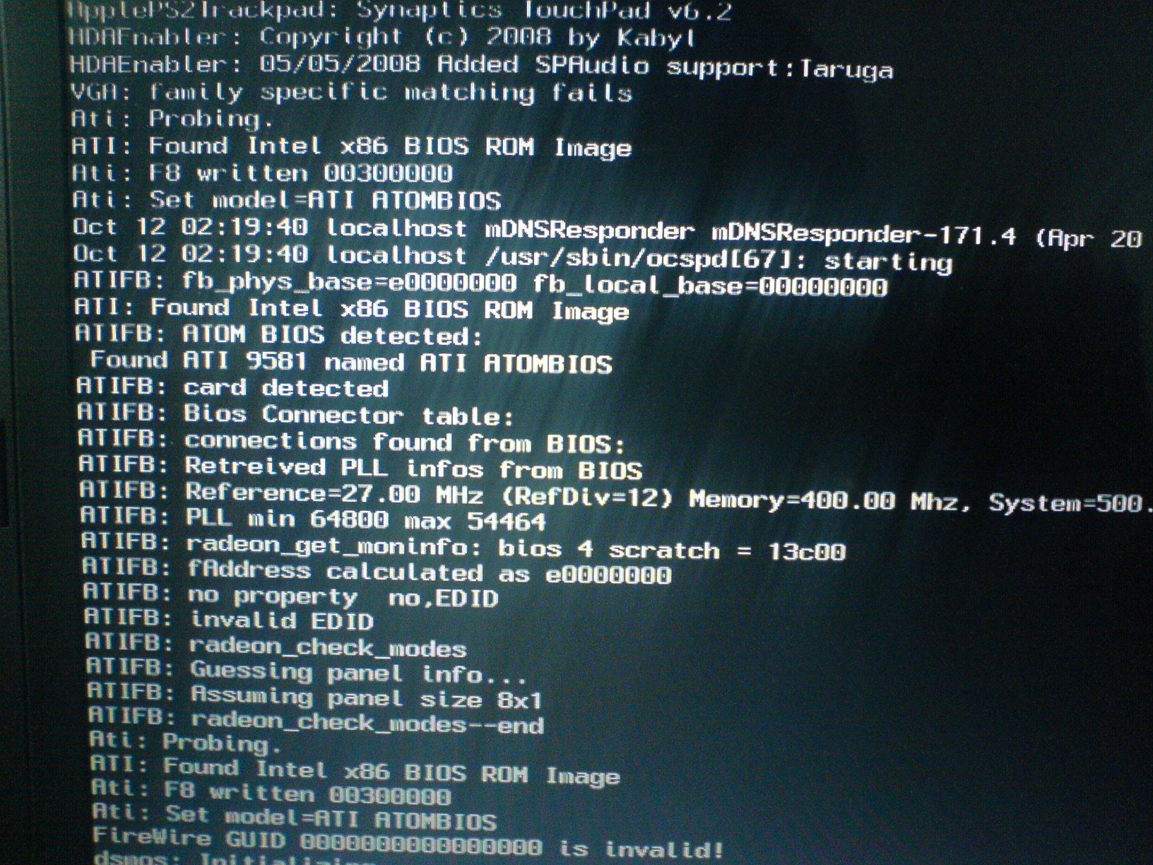

My Card: mobility hd2600 id:9581 System:10.5.4
With Ati.kext and Atilead.kext ,I got system hang. :)

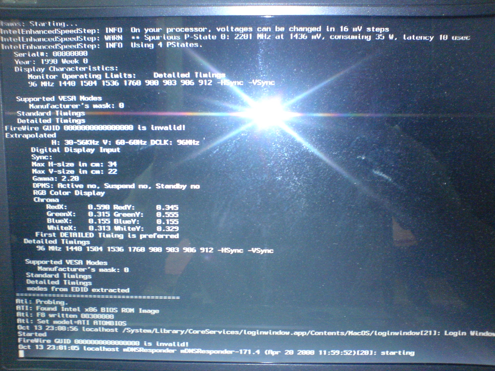

Thank you for good testing!
Yes, I know the problem with model name. For ATOM_BIOS I need to set custom name.
With your testing I see that BIOS_4_SCRATCH give you non-expected value. I have no documentation about it so it would be great to know about this value from experiments.
Can you do a command
sudo -s
kextload -v RadeonPCI.kext
./RadeonDump -r 1700,1760
with different monitor connections?
And at last. Try again with corrected ATILead.info.plist
M1,EDID
no,EDID
I think you may enter GUI with it.
<key>M1,EDID</key>
<key>no,EDID</key>
I changed <key>M1,EDID</key> to <key>no,EDID</key>
then i got system hang again :) !Of course,i have tried different monitor connections.
just can see this

HI Slice!I tried ATI.kext+ATILead +RadeonPCI!
Hangs at Start ;)
ATILead+RadeonPCI doing the image in attachament!
IN attachments there is the result of

hello to all!
edit:Any idea for the Change resoluction? :D
