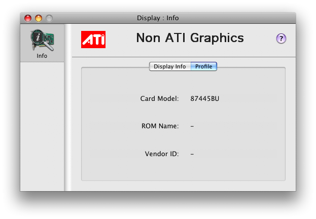

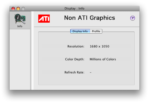

Gord Posted August 19, 2008 Share Posted August 19, 2008 Ok here are my screen shots and dump files: Anything else that might be handy? Cheers, Gord. dmesg.txt ioreg.txt Link to comment https://www.insanelymac.com/forum/topic/96664-ati-framebuffer-development/page/13/#findComment-860919 Share on other sites More sharing options...

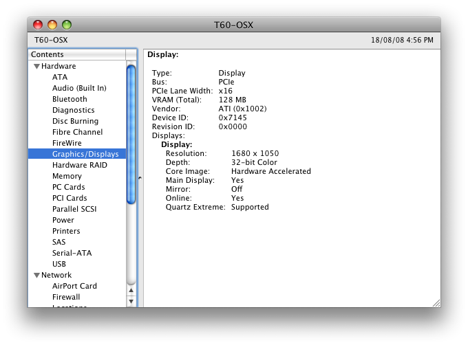

Gord Posted August 19, 2008 Share Posted August 19, 2008 FYI: I have tested some resolution things to verify that I actually have the display indicated. If I take a screenshot of the entire desktop, the resolution of that picture is 1400x1050 If I take a finder window and drag the corners to fill the screen, except the menu bar the application capture resolution is 1480x1108 Kinda strange, I think that there is some display discrepancy here and that I don't really have 1680x1050, even though everything reports it as such. Perhaps it is the internal driver scaling it to 1400x1050? Cheers, Gord. Link to comment https://www.insanelymac.com/forum/topic/96664-ati-framebuffer-development/page/13/#findComment-860953 Share on other sites More sharing options...
dong Posted August 19, 2008 Share Posted August 19, 2008 Just a quick reply. Since you have a T60, it's possible that RadeonHD detect the 1680x1050 mode and set it as the virtual width and virtual height. The scanout and scansize are set accordingly. Thus although IONDRVSupport only provide a 1400x1050 mode, somehow the full 1680x1050 framebuffer is used and get displayed. Details remains unknown yet. I will look at the files you provide later. Link to comment https://www.insanelymac.com/forum/topic/96664-ati-framebuffer-development/page/13/#findComment-860965 Share on other sites More sharing options...
