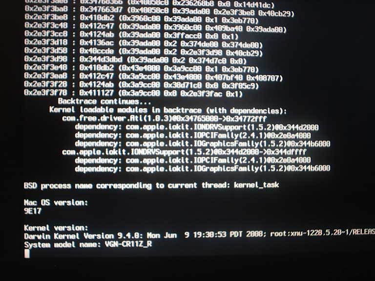

pere Posted September 11, 2008 Share Posted September 11, 2008 Hi to all... i follow this thread also from some time, and i will like to help/debug, i dont know programming, but i can dive into the code to change things (commenting lines, changing values, etc), i have xcode installed and willing, just need a little guide to know how to do the correct testing. My hardware: Ati X2300 (DEV: 718A) on sony vaio laptop (This graphic card is an old rebranded x1450) Link to comment https://www.insanelymac.com/forum/topic/96664-ati-framebuffer-development/page/14/#findComment-887500 Share on other sites More sharing options...
Slice Posted September 12, 2008 Author Share Posted September 12, 2008 Very rare skill is programmer! But I thought that not only noobs install MacOSX on PC! What do I need to explain? OK. How to test? 1. Install ATILead.kext and Ati.kext. 2. Correct its info.plist 3. Try to boot. 4. Catch messages to show me. 5. Undo all changes and rest. Details. 1. How to install kexts? Type in terminal. sudo -scp -r -v ~/Desktop/ATILead.kext /S*/L*/E*/ cp -r -v ~/Desktop/Ati.kext /S*/L*/E*/ rm -v /S*/L*/E*.ke* rm -v /S*/L*/E*.mke* diskutil repairpermissions / 2. How to correct info.plist? sudo -snano /S*/L*/E*/ATILead.kext/Contents/info.plist ctrl^o ctrl^x What to correct? See my previous post. 3. How to boot? Best in single user mode with -v -s keys. 4. How to catch messages? After boot with -s you may enter /sbin/fsck -fy/sbin/mount -uw / sh /etc/rc wait for all messagestype crtl^c dmesg >dmesgYourNick.txt exit exit If you can't boot make digital photo of screen If you successfully boot the type in terminal sudo -sdmesg >dmesgYourNick.txt ioreg -l -x -w 2048 >ioregYourNick.txt kextstat >kextstatYourNick.txt kextload -v RadeonPCI.kext ./RadeonDump -r 0,400 >regsYourNick.txt Check also xBench, OpenMark or other graphics tests. 5. How to finish tests? sudo -srm -r -v /S*/L*/E*/ATILead.kext rm -r -v /S*/L*/E*/Ati.kext reboot 6. How to rest? Take two bottle of beer... Is there any news here? For programmers/hackers/coders and so on. If you find an error at the boot try to understand what is wrong. Compatibility: at the moment for all except nVidia and Intel. Link to comment https://www.insanelymac.com/forum/topic/96664-ati-framebuffer-development/page/14/#findComment-887721 Share on other sites More sharing options...

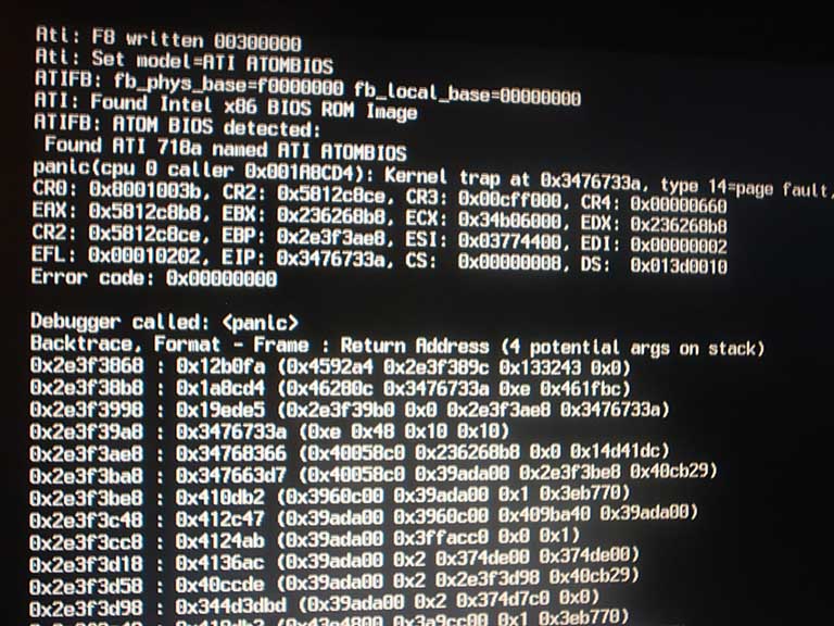

Slice Posted September 12, 2008 Author Share Posted September 12, 2008 Thanks, i will try and post what i find. Got kernel panic.... im trying to get good pictures, but cant find where in the code the error comes from the kernel panic, if you like i can add iologs to see where the kernel panic comes, but first need to guess where the iologs should be added.... When KP you see hexadecimal values on screen. Find EIP register - it is address of last command Look for loading address of kext where KP is occur. It might be slightly less then address of KP. Then I can binary find a place in sources. Link to comment https://www.insanelymac.com/forum/topic/96664-ati-framebuffer-development/page/14/#findComment-888038 Share on other sites More sharing options...
Slice Posted September 12, 2008 Author Share Posted September 12, 2008 Thanks, doing it now....Panic (CPU 0 caller 0x001A8CD4) EIP: 0x34bfa33a If is not the correct loading adress, please tell me where to look for it. It looks like Ati.kext: (0x34bf123456) or ATILead or other with near address Link to comment https://www.insanelymac.com/forum/topic/96664-ati-framebuffer-development/page/14/#findComment-888105 Share on other sites More sharing options...
Slice Posted September 12, 2008 Author Share Posted September 12, 2008 Done: EIP: 0x34bfa33a Com.free.driver.ati (1.0.3)@ 0x34650000>0x34b5dfff Sorry, but this address is too far 0x34bfa33a - 0x34b5dfff = 0x9C33B = 639 803 ( Application Calculator in programmer's mode) But Ati.kext has size only 100kb. So this address is out of the kext. Try to look more carefully. It may be a problem of address as I said before. Link to comment https://www.insanelymac.com/forum/topic/96664-ati-framebuffer-development/page/14/#findComment-888525 Share on other sites More sharing options...
Slice Posted September 13, 2008 Author Share Posted September 13, 2008 I get this: | | | +-o EVGA@0 | | | | { | | | | "IOPCIResourced" = Yes | | | | "IOInterruptControllers" = ("io-apic-0","IOPCIMessagedInterruptController") | | | | "IOName" = "display" | | | | "subsystem-id" = | | | | "IODeviceMemory" = (({"address"=0xfffffffff0000000,"length"=0x4000000}),{"parent"=({"address"=0x0,"length"=0x10000}),"offset"=0x2000,"length"=0x100},({"address"=0xfffffffffc000000,"length"=0x10000})) | | | | "display-connect-flags" = | | | | "class-code" = | | | | "revision-id" = | | | | "assigned-addresses" = and insert it as 0x0000000.... Better i try to post a good picture.... No. "address"=0xfffffffff0000000 = 0xf0000000 Yes, show picture. Link to comment https://www.insanelymac.com/forum/topic/96664-ati-framebuffer-development/page/14/#findComment-888865 Share on other sites More sharing options...
pere Posted September 13, 2008 Share Posted September 13, 2008 Sorry cause my mistakes... i have clean my posts also, dont want to flood the thread. I added 0xf0000000 I have used plist editor for this, not text edit. , so it looked like: <key>@0,address</key> <integer>-268435456</integer <key>@0,model</key> <string>ATY,M64</string <key>chipset-model</key> <string>ATY,M64</string> Then got kernel panic on boot, i have attached two pics cause the camera didnt do a good job. Link to comment https://www.insanelymac.com/forum/topic/96664-ati-framebuffer-development/page/14/#findComment-889239 Share on other sites More sharing options...
Slice Posted September 13, 2008 Author Share Posted September 13, 2008 Sorry cause my mistakes... i have clean my posts also, dont want to flood the thread.I added 0xf0000000 I have used plist editor for this, not text edit. , so it looked like: @0,address -268435456 @0,model ATY,M64 chipset-model ATY,M64 Then got kernel panic on boot, i have attached two pics cause the camera didnt do a good job. Now all is clear. Bad reading name of card from ATOMBIOS. Actually ATOMBIOS doesn't contain card name. It is not hard to correct. For example using list of different names. EIP=0x3476733a Ati =0x34765000 relative address = 0x233a. It is in procedure GetConnectorInfoFromBIOS. KP is here. Some mistake in my codes. Actually Dong has good sources for GetConnectorInfo for ATOMBIOS. But very complex. Dong, look at my codes, please! Where is zero pointer for AtomBIOS? EDITED: Found! MasterDataStart is undefined! Sorry! int MasterDataStart; // rinfo->ROMHeaderStart = BIOS_IN16(0x48); if(rinfo->IsAtomBios) { // MasterDataStart = BIOS_IN16( rinfo->ROMHeaderStart + 32 ); tmp = BIOS_IN16( MasterDataStart + 22); // unassigned Should be // int MasterDataStart; // don't need local definition // rinfo->ROMHeaderStart = BIOS_IN16(0x48); if(rinfo->IsAtomBios) { // MasterDataStart = BIOS_IN16( rinfo->ROMHeaderStart + 32 ); tmp = BIOS_IN16(rinfo->MasterDataStart + 22); Link to comment https://www.insanelymac.com/forum/topic/96664-ati-framebuffer-development/page/14/#findComment-889411 Share on other sites More sharing options...
