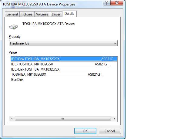

Hi,
I am not getting any furthur information from the device manager other than the one already given.....
but my AMD IDE controller gives 0x1002438c as the device ID....is that something you are looking for?
Else could you let me know how i can get the device id.
My Device Manager displays this for the Under Disk Drives -->
IDE\DiskTOSHIBA_MK1032GSX_______________________AS021G__
I am attaching a pic of the same...
Edit: On 2nd look...my AMD Sata Controller(native IDE Mode) gives me 0x10024380
PCI\VEN_1002&DEV_4380&SUBSYS_01F51028&REV_00
TIA...

Ok that SATA controller is there, what is your PATA controller? or are you using a SATA DVD?
