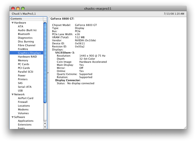

Bizmarke Posted July 13, 2008 Share Posted July 13, 2008 IT's WORKING!!!!!! Heh I was doing some reg. system maint. you know updating drivers, and I found a update for my bios!! I figure well why not drop back into Leo and see if she boots and damnit she does!!! Link to comment https://www.insanelymac.com/forum/topic/91755-how-to-gfx-efi-tutorial-for-nvidia-geforce-8800gt-512mb-g92/page/9/#findComment-817510 Share on other sites More sharing options...
agrafuese Posted July 13, 2008 Author Share Posted July 13, 2008 Cheers to that man! Solutions can pop up in the most unlikely places. Gotta love it. Link to comment https://www.insanelymac.com/forum/topic/91755-how-to-gfx-efi-tutorial-for-nvidia-geforce-8800gt-512mb-g92/page/9/#findComment-817635 Share on other sites More sharing options...
