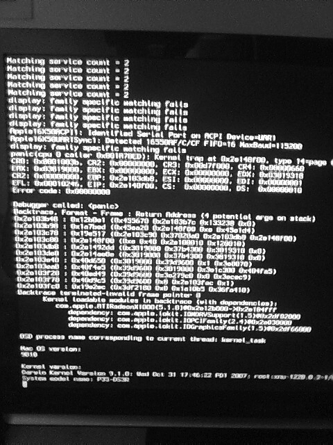

Pilgrimage Posted May 6, 2008 Share Posted May 6, 2008 First, thanks for the excellent guide! The installation went without any problems on my Gigabyte P35-DS3R, but when i restart my computer, the all-famous "You need to restart your computer" error pops up. I booted with -v and see something like this: display: family specific matching fails ... Debugger called: <panic> ... Kernel loadable modules in backtrace: com.apple.ATIRadeonX1000 ... I tried installing OSX with NATIT driver, ATYinject driver and without a driver. But every time the same error. The videocard is a Sapphire x1950 pro 256 MB. Should I try to install this version? http://forum.insanelymac.com/index.php?showtopic=58988. If so, how do I do this in the console? Thanks for your help... edit: I attached a capture of the errors I get when I boot with -v (crappy quality from mobile camera, but stil readable) edit 2: found the same problem in this thread (http://forum.insanelymac.com/index.php?s=&showtopic=90795&view=findpost&p=689582). The terminal code looks pretty much the same. Will try this first... Link to comment https://www.insanelymac.com/forum/topic/90795-guide-installer-leopard-gigabyte-ga-p35-ds3pds3rds4-1052-efi/page/28/#findComment-737873 Share on other sites More sharing options...

~pcwiz Posted May 8, 2008 Author Share Posted May 8, 2008 Silven, Dual boot with XP: http://wiki.osx86project.org/wiki/index.php/Chain0 Pilgrimage, If you are getting "Kernel loadable modules in backtrace: com.apple.ATIRadeonX1000" and you can't fix it, just remove ATIRadeonX1000.kext and it will boot. To do this, boot up the system in single user mode (-s at F8 boot prompt) and run these commands: /sbin/mount -uw / mkdir /KextBackup/ cp -R /System/Library/Extensions/ATIRadeonX1000.kext /KextBackup/ rm -rf /System/Library/Extensions/ATIRadeonX1000.kext rm -rf /System/Library/Extensions.mkext Should boot up after that so you can install new drivers gendem, For sure, thanks Treggs and Fruitboi, In the new Ubuntu 8.04 there is a new Wubi installer that will install Ubuntu from within Windows to a DSK file and it will add an entry to the Windows bootloader to boot Ubuntu. Worked perfectly for me Link to comment https://www.insanelymac.com/forum/topic/90795-guide-installer-leopard-gigabyte-ga-p35-ds3pds3rds4-1052-efi/page/28/#findComment-739195 Share on other sites More sharing options...

Pilgrimage Posted May 8, 2008 Share Posted May 8, 2008 Pilgrimage, If you are getting "Kernel loadable modules in backtrace: com.apple.ATIRadeonX1000" and you can't fix it, just remove ATIRadeonX1000.kext and it will boot. To do this, boot up the system in single user mode (-s at F8 boot prompt) and run these commands: /sbin/mount -uw / mkdir /KextBackup/ cp -R /System/Library/Extensions/ATIRadeonX1000.kext /KextBackup/ rm -rf /System/Library/Extensions/ATIRadeonX1000.kext rm -rf /System/Library/Extensions.mkext Should boot up after that so you can install new drivers Wow, that just solved the problem! Thanks! Just one other thing: when I installed the 10.5.2 kernels package, I only selected the Vanilla option (the last one if I remember). No sleep, SSE3,... Afterwards I installed the sleep kernel from the Gigabyte P35 Installer, but now, the sleep function doesn't work. Do I need to select both sleep kernels when I install? PS: I changed the ACPI Suspend Type to S1 like you told me in the guide. Link to comment https://www.insanelymac.com/forum/topic/90795-guide-installer-leopard-gigabyte-ga-p35-ds3pds3rds4-1052-efi/page/28/#findComment-739354 Share on other sites More sharing options...
