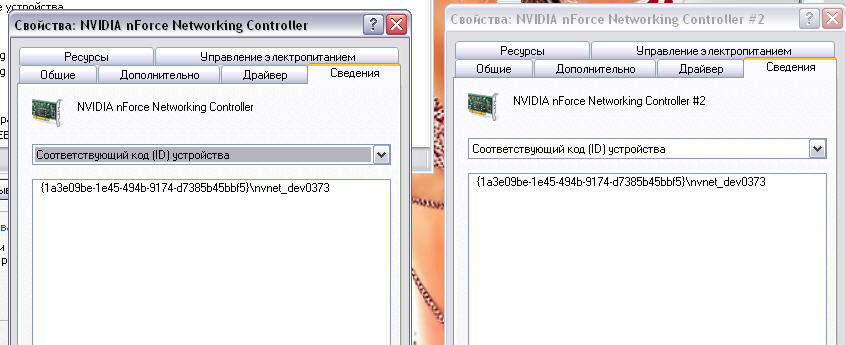

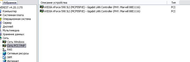

kinst2008 Posted June 19, 2008 Share Posted June 19, 2008 Does it have one or two PHYs? PHYs? Sorry, may be I don't anderstand you correctly. Here is my shot from windows everest Link to comment https://www.insanelymac.com/forum/topic/89475-discontinued/page/5/#findComment-790173 Share on other sites More sharing options...
kinst2008 Posted June 19, 2008 Share Posted June 19, 2008 ok, may be you mean the device Id? It's The same for the both controllers 0373 Link to comment https://www.insanelymac.com/forum/topic/89475-discontinued/page/5/#findComment-790430 Share on other sites More sharing options...
iNoob Posted June 19, 2008 Author Share Posted June 19, 2008 So you have one NIC and two PHYs... Cost reduction? Seriously, maybe that's the reason why. NIC > controller PHY > physical interface, connects to NIC Link to comment https://www.insanelymac.com/forum/topic/89475-discontinued/page/5/#findComment-790434 Share on other sites More sharing options...
kinst2008 Posted June 19, 2008 Share Posted June 19, 2008 aaa.. ok. It's calls dual gigabit lan in my mboard specification. So there is no variants what to do? Link to comment https://www.insanelymac.com/forum/topic/89475-discontinued/page/5/#findComment-790439 Share on other sites More sharing options...
kinst2008 Posted June 20, 2008 Share Posted June 20, 2008 So i can't understand.. may be the controller is one, but why windows sees two PHYs and Leo only one? Link to comment https://www.insanelymac.com/forum/topic/89475-discontinued/page/5/#findComment-790506 Share on other sites More sharing options...
