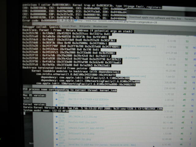

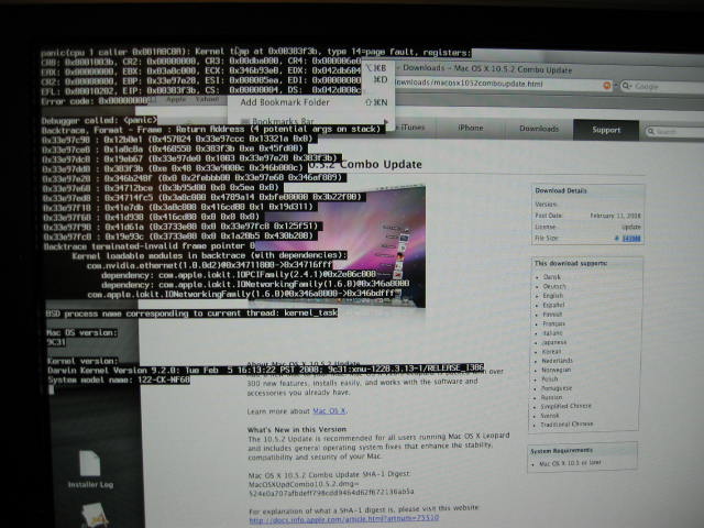

MrRoper Posted February 25, 2008 Share Posted February 25, 2008 thanks for pickin up on this project iNOOB, glad its finally back in the works Both boot the machine successfully, DHCP functional, full-duplex 100, 1500 MTU, 2 cores 1. If i set full-duplex 1000 i get a kernel panic 2. I tried downloading a single file, seemed to be stabile, this was repeated 4 times on different restarts, downloading the MacOSXUpdCombo10.5.2 from apple at 1.6mb/sec, one time i got a panic at about 75% downloaded... 3. Torrents... seems as reported, under load, will induce a panic. it would be nice to actually be able to use the onboard dual gigabit ethernet ports on the osx side of things... even tho i've resorted to using the linksys pci card w/tulip is rock solid Looking forward to see some improvements Here are screenies: Panic 1 is under kext from first post Panic 2 is under kext from your 2nd post Link to comment https://www.insanelymac.com/forum/topic/89475-discontinued/#findComment-641798 Share on other sites More sharing options...

muitommy Posted February 25, 2008 Share Posted February 25, 2008 i have tried both kext, both work well in cpus=1, (tramissions + comboupdate dl ) but got kernel panic with all core enabled ..(when dl comboupdate from apple @3.6mb/s) --------------p.s. those symptoms is the same when i use my belkin usb adapter, and got network drops instead of panic for 8139 ... so i think it's really some others prob. of nforce chipset or kernel :/ Link to comment https://www.insanelymac.com/forum/topic/89475-discontinued/#findComment-642268 Share on other sites More sharing options...
