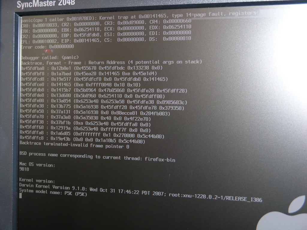

radov4n Posted February 15, 2008 Share Posted February 15, 2008 Well guys, I'll be {censored}. Looks like it didn't crash. It's the remap thing. Link to comment https://www.insanelymac.com/forum/topic/87267-4gb-of-ram-random-crashesfreezeskernel-panics/page/2/#findComment-626094 Share on other sites More sharing options...

PoloBear Posted February 17, 2008 Share Posted February 17, 2008 I just deleted the jmicron kext, deleted cache, repaired everything with kexthelper, removed maxmem from apple.boot.plist..... After that the memtest with Highload ran through with no panics..... So AHCI, no IDE drives and deleting the not working driver did the trick. Happy hacking.... Jürgen Link to comment https://www.insanelymac.com/forum/topic/87267-4gb-of-ram-random-crashesfreezeskernel-panics/page/2/#findComment-628808 Share on other sites More sharing options...

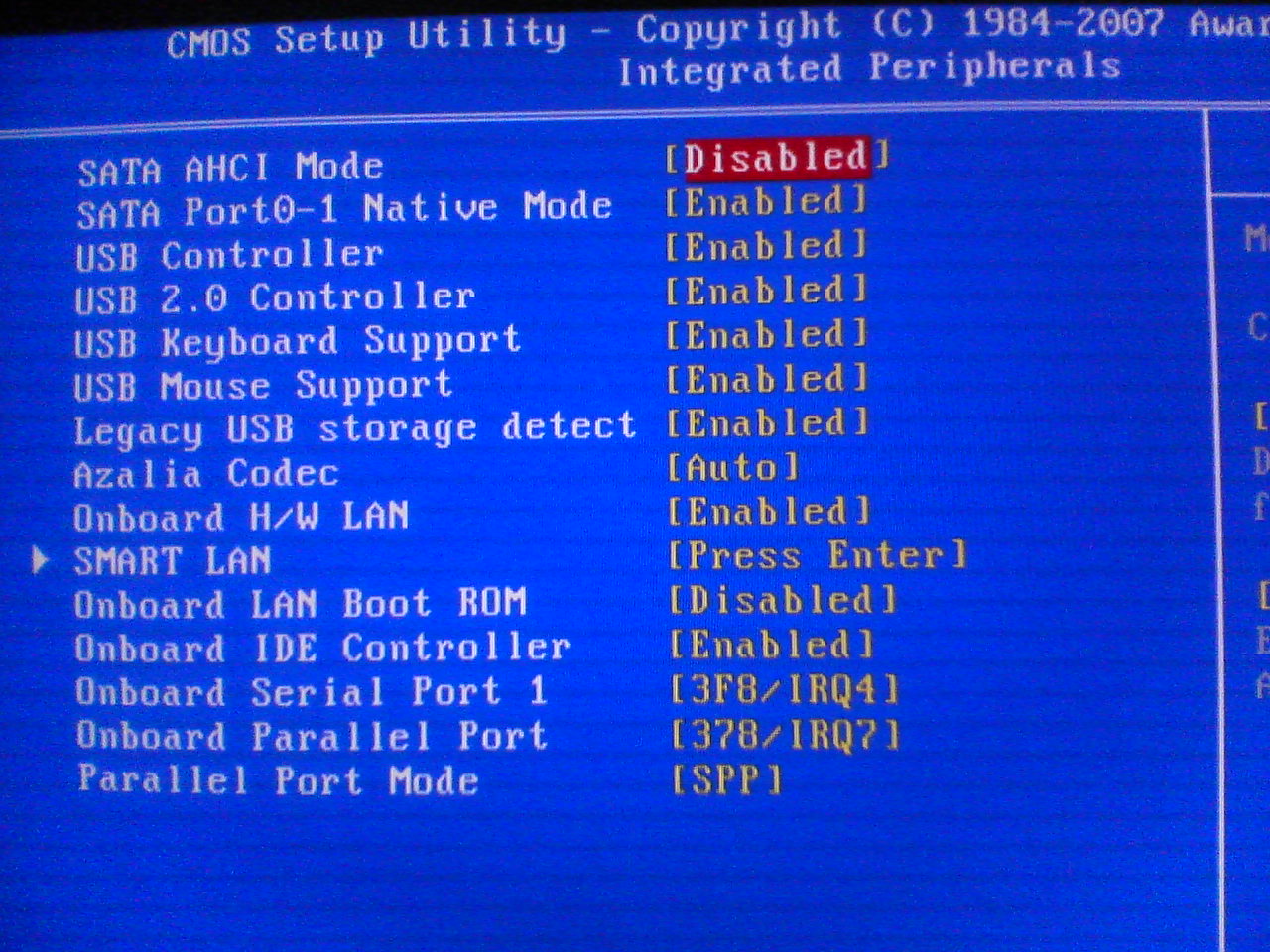

frizbot Posted February 19, 2008 Share Posted February 19, 2008 I'm confused, and need a summary. JMicron is a company that creates SATA and other controller chips. Maxmem limits the amount of RAM OSX will use. Deleting JMicron's kext can cause KPs. Disabling jmicron is not possible in Gigabyte's motherboard, but possible in ASUS BIOS, which then disables IDE. "The memory remapping feature allows for the segment of system memory that was previously overwritten by the Peripheral Component Interconnect (PCI) configuration space to be remapped above the 4 GB address line." -Microsoft KB 929605. So disabling memory remapping limits you to ~3120mb of RAM. Disabling IDE then disables non-SATA CDROM drives? Does disabling JMicron have an effect on the amount of addressable memory? (eg. is having 4, 6, 8, etc gigabytes usable after disabling JMicron) Do chipsets such as X38 have this issue, or is it limited to P35? Link to comment https://www.insanelymac.com/forum/topic/87267-4gb-of-ram-random-crashesfreezeskernel-panics/page/2/#findComment-631751 Share on other sites More sharing options...
radov4n Posted February 19, 2008 Share Posted February 19, 2008 I'm confused, and need a summary. JMicron is a company that creates SATA and other controller chips. Maxmem limits the amount of RAM OSX will use. Deleting JMicron's kext can cause KPs. Disabling jmicron is not possible in Gigabyte's motherboard, but possible in ASUS BIOS, which then disables IDE. "The memory remapping feature allows for the segment of system memory that was previously overwritten by the Peripheral Component Interconnect (PCI) configuration space to be remapped above the 4 GB address line." -Microsoft KB 929605. So disabling memory remapping limits you to ~3120mb of RAM. Disabling IDE then disables non-SATA CDROM drives? Does disabling JMicron have an effect on the amount of addressable memory? (eg. is having 4, 6, 8, etc gigabytes usable after disabling JMicron) Do chipsets such as X38 have this issue, or is it limited to P35? You can disable jMicron on Gigabyte boards. If you disable jMicron you lose IDE drives, because they are controlled by jMicron. Your ICH9/ICH9R (depending on the manufacturer) can operate in different modes (IDE, AHCI or both). No disabling jMicron has no affect on memory. I think this issue is with any board that has ICH9/ICH9R, hence X38 too. Truth is, we don't know if jMicron is causing KP. This is merely an educated guess. I deleted my jMicron kext and I am not getting KPs. It's also disabled in my DS3R BIOS. Hope this helps. Link to comment https://www.insanelymac.com/forum/topic/87267-4gb-of-ram-random-crashesfreezeskernel-panics/page/2/#findComment-631773 Share on other sites More sharing options...
ridgecity Posted February 19, 2008 Share Posted February 19, 2008 You can disable jMicron on Gigabyte boards. If you disable jMicron you lose IDE drives, because they are controlled by jMicron. Your ICH9/ICH9R (depending on the manufacturer) can operate in different modes (IDE, AHCI or both). No disabling jMicron has no affect on memory. I think this issue is with any board that has ICH9/ICH9R, hence X38 too. Truth is, we don't know if jMicron is causing KP. This is merely an educated guess. I deleted my jMicron kext and I am not getting KPs. It's also disabled in my DS3R BIOS. Hope this helps. where do you disable it on your gigabyte board? I cant find it... Link to comment https://www.insanelymac.com/forum/topic/87267-4gb-of-ram-random-crashesfreezeskernel-panics/page/2/#findComment-631922 Share on other sites More sharing options...
PoloBear Posted February 19, 2008 Share Posted February 19, 2008 You can disable it in bios, same page where you set your drives to AHCI. But I think that you dont have to disable it. I recently upgraded my RAM to 6 GB and just deleted the kext, I have a timemachine SATA drive connected to the Jmicron set to AHCI working fine.No more panics since deleting the jmicron.kext.Here is the bios page...It is the onboard IDE controller Link to comment https://www.insanelymac.com/forum/topic/87267-4gb-of-ram-random-crashesfreezeskernel-panics/page/2/#findComment-631967 Share on other sites More sharing options...
KirbySaysHi Posted February 19, 2008 Share Posted February 19, 2008 The other day I downloaded and installed macnub's AppleSMBIOS kext, and a few things changed: now, in system profiler, when I click on ATA it shows my two PATA hard drives (controlled by JMicron). Also, in extensions, the jmicron kext is loaded; previously it would not. I still get kernel panics when trying to move large amounts of data, (only in terminal. when I do it using the gui, I get an error like, "This operation cannot be completed because the file <filename> already exists"). I'll try removing the kext and report back! Link to comment https://www.insanelymac.com/forum/topic/87267-4gb-of-ram-random-crashesfreezeskernel-panics/page/2/#findComment-632002 Share on other sites More sharing options...
erbasvizzera Posted February 22, 2008 Share Posted February 22, 2008 I have the same problem on my P5KC with 4GB ram. I have disabled Memory Remap and system work fine. My question is: the bios read 3GB Leo read 4GB Truly works 4GB on system with 4GB ram installed and memory remap disabled? Link to comment https://www.insanelymac.com/forum/topic/87267-4gb-of-ram-random-crashesfreezeskernel-panics/page/2/#findComment-637335 Share on other sites More sharing options...
erbasvizzera Posted February 22, 2008 Share Posted February 22, 2008 With memory remap enabled and jmicron disabled = no kernel panic with 4GB ram. If i set memory remap disabled system work truly with 3GB. Link to comment https://www.insanelymac.com/forum/topic/87267-4gb-of-ram-random-crashesfreezeskernel-panics/page/2/#findComment-637641 Share on other sites More sharing options...
radov4n Posted February 23, 2008 Share Posted February 23, 2008 With memory remap enabled and jmicron disabled = no kernel panic with 4GB ram. If i set memory remap disabled system work truly with 3GB. Even though BIOS reads 3GB, your OS has access to all 4GB. Link to comment https://www.insanelymac.com/forum/topic/87267-4gb-of-ram-random-crashesfreezeskernel-panics/page/2/#findComment-639392 Share on other sites More sharing options...
erbasvizzera Posted February 23, 2008 Share Posted February 23, 2008 Even though BIOS reads 3GB, your OS has access to all 4GB. I don't know, because in system monitoring read 4GB but if you see the statistic at the left of the screen the available + free memory is 3GB. When memory remap is enabled the available + free memory is 4GB. Link to comment https://www.insanelymac.com/forum/topic/87267-4gb-of-ram-random-crashesfreezeskernel-panics/page/2/#findComment-639644 Share on other sites More sharing options...

linkley Posted February 24, 2008 Share Posted February 24, 2008 Hi, there is a solution for the problem of 4gb, see this http://forum.insanelymac.com/index.php?showtopic=88335 , i delete my viaata kext and replace the ioata kext that you can find in that thread, now with p5k i can use 4gb without kernel panic (test with hight load software)!!! p.s sorry for my english Link to comment https://www.insanelymac.com/forum/topic/87267-4gb-of-ram-random-crashesfreezeskernel-panics/page/2/#findComment-640548 Share on other sites More sharing options...
