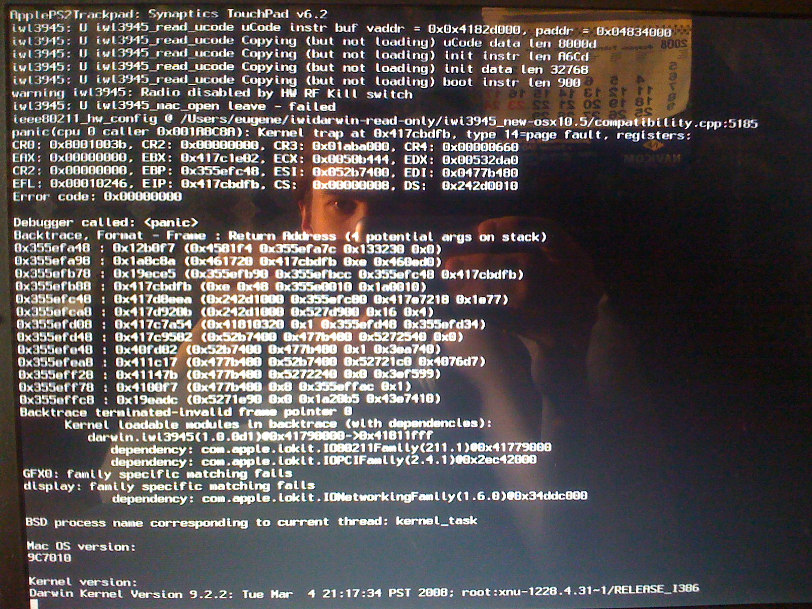

nordix Posted May 3, 2008 Share Posted May 3, 2008 iwi3945 rel 938 With iosleep(4000) -> norm w/o iosleep -> first time norm, switching on/off gives nothing, then reboot with WiFi switched off -> KP (twice) Then switch on, reboot -> freeze, then ok system_with_iosleep.txt system.txt Link to comment Share on other sites More sharing options...
