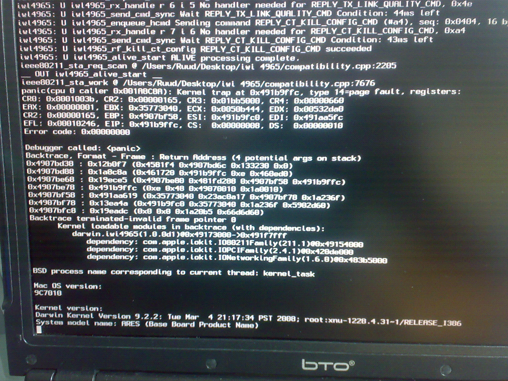

while I build iwi4965, I get an error from xcode saying that a custom build script failed:
password:
password:
password:
I'm guessing that a sudo command is in one of the custom scripts, and is hung on asking for a password.
When I build from cli using `sudo xcodebuild' it builds and installs. I'm not sure if you are expecting to have xcode also install the kext. kinda odd.
I guess another question that I have is, couldn't you install the symbols for 9c7010 (my build on leo4allv3) to help you understand what is going on with KP, and also do gdb debugging from another box?

From what I can tell, using 910, right after the build it automatically installs the kext and my computer locks up. When I reboot I get kp. I think nordix is maybe getting about the same. I'm new to mac, but normally if I were kernel debugging under linux I would use gdb, which is what I was asking earlier. being able to read the symbols form the kernel and being able to step through breakpoints in the module would probably prove most valuable.
