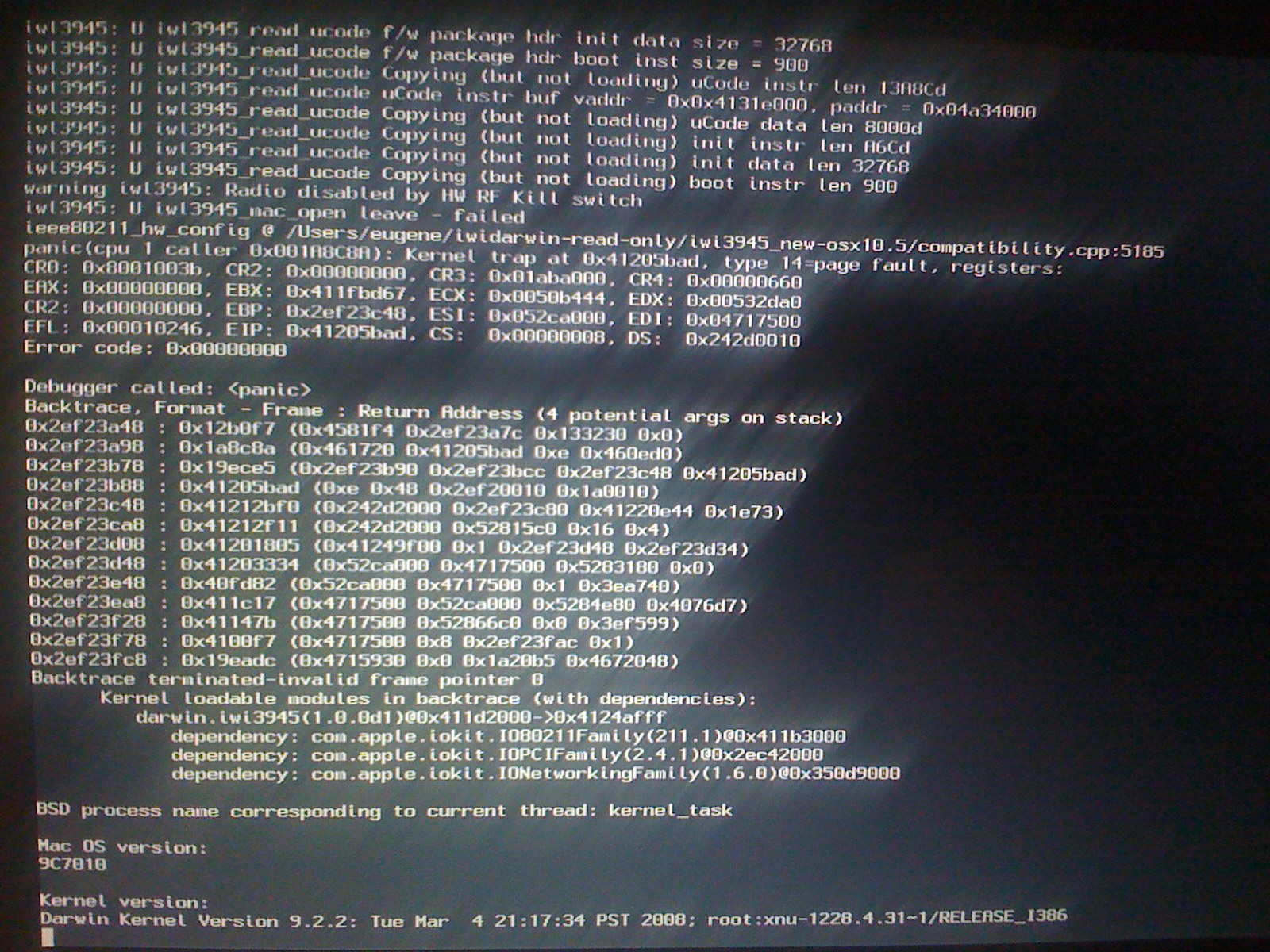

pere Posted May 4, 2008 Share Posted May 4, 2008 I have try to make it kp, but just got frozen, then i booted with the hardware switch turned off, and i could get a kp, the last line printed before the kp was the code line 5185 on compatibility.cpp, related to this: int ieee80211_hw_config(struct ieee80211_local *local) { IM_HERE_NOW(); struct ieee80211_hw_mode *mode; struct ieee80211_channel *chan; int ret = 0; if (local->sta_scanning) { chan = local->scan_channel; mode = local->scan_hw_mode; } else { chan = local->oper_channel; mode = local->oper_hw_mode; Sorry, no pic. } Link to comment https://www.insanelymac.com/forum/topic/84072-intel-wireless-2100-2200bg-2915bg-3945abg-4965agn/page/80/#findComment-735576 Share on other sites More sharing options...
jalavoui Posted May 4, 2008 Author Share Posted May 4, 2008 thanks pere - i am expecting this to work iwi3945 rel 963 iwi4965 rel 964 to build iwi3945.dmg read 1st post open terminal cd to iwi3945 folder... sudo rm iwi3945.dmg sudo xcodebuild iwi3945.xcodeproj this instruction should be add to 1st post - this fix the error while build in xcode for non root acounts you don't need the dmg. xcode will place iwi3945.kext in system/library/extensions reboot and goto sys prefs -nets to add en1 if not already Link to comment https://www.insanelymac.com/forum/topic/84072-intel-wireless-2100-2200bg-2915bg-3945abg-4965agn/page/80/#findComment-735581 Share on other sites More sharing options...

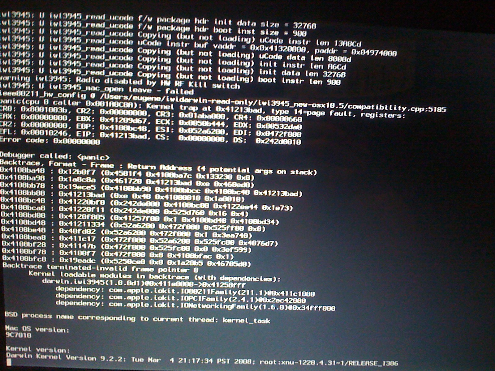

nordix Posted May 4, 2008 Share Posted May 4, 2008 Here are my shots of KP's Link to comment https://www.insanelymac.com/forum/topic/84072-intel-wireless-2100-2200bg-2915bg-3945abg-4965agn/page/80/#findComment-735583 Share on other sites More sharing options...
