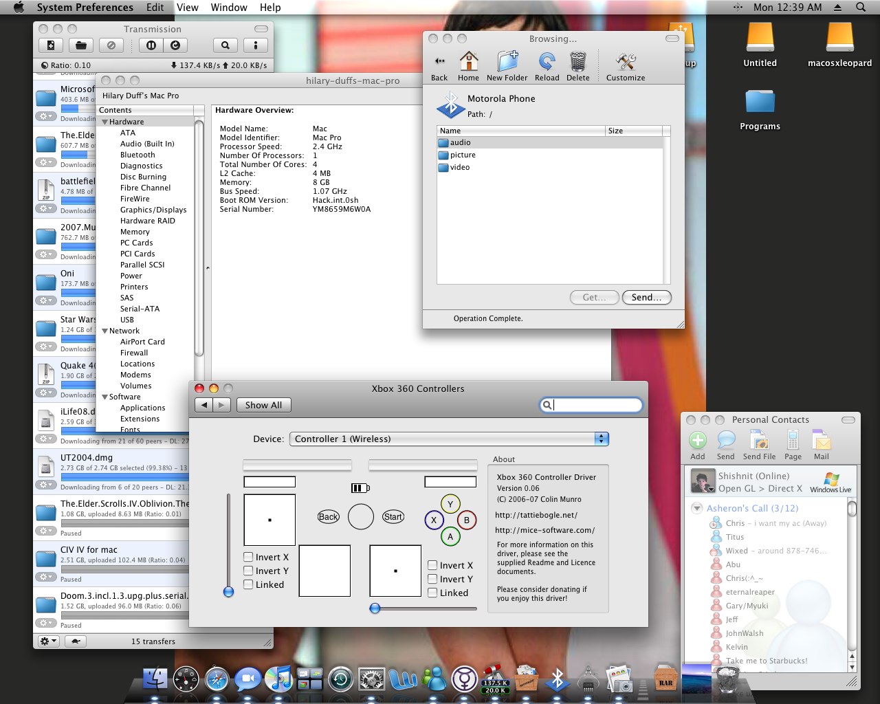

shishnit Posted February 4, 2008 Share Posted February 4, 2008 I also got my hack working, I ended up doing a Kalyway installation and the reason why it didn't work before was because winrar doesn't unrar it right. Everything worked out of the box except I needed graphics card and audio drivers. Shutdown has some issues, it shuts down the OS, but not the PC all the way.. fans still going, LED lights are on.. all I have to do is press the power button from there so it isn't too big of an issue. Have yet to try sleep and firewire though. I can even view my second internal (windows) hard drive and transfer files from it. (just can't transfer files TO it from the mac, says it's read only) as well as my D-link bluetooth dongle and xbox 360 wireless controller P.S. download quicksilver its so useful! Link to comment https://www.insanelymac.com/forum/topic/82760-how-i-install-1052-in-ep35ds4-rev-21-intel/#findComment-607914 Share on other sites More sharing options...

shishnit Posted February 6, 2008 Share Posted February 6, 2008 Hey Kunijp I found the perfect front row remote, I've been using it all day, all you need is bluetooth It's a wiimote! It works perfectly with Kalyway and you can even use it as a wireless mouse for the whole operating system! I've also tried using it with games and it works okay, but some bugs need to be weaved out first. I'm going to make a youtube video on it soon. P.S. for bluetooth I'm using a $20 D-link bluetooth USB dongle which is PC and Mac compatible. P.S.S. Are your WD5000AACS hard drives loud? Mine are REALLY loud, and annoying. They are even louder than my 5 year old Dell's western digital hard drives... I bought mine open box so I'm wondering if that is the reason why, or are they all made that way? Link to comment https://www.insanelymac.com/forum/topic/82760-how-i-install-1052-in-ep35ds4-rev-21-intel/#findComment-611211 Share on other sites More sharing options...
^_^ Posted February 7, 2008 Author Share Posted February 7, 2008 Hey Kunijp I found the perfect front row remote, I've been using it all day, all you need is bluetooth It's a wiimote! It works perfectly with Kalyway and you can even use it as a wireless mouse for the whole operating system! I've also tried using it with games and it works okay, but some bugs need to be weaved out first. I'm going to make a youtube video on it soon. P.S. for bluetooth I'm using a $20 D-link bluetooth USB dongle which is PC and Mac compatible. P.S.S. Are your WD5000AACS hard drives loud? Mine are REALLY loud, and annoying. They are even louder than my 5 year old Dell's western digital hard drives... I bought mine open box so I'm wondering if that is the reason why, or are they all made that way? Hey ^^/ My WD5000AACS is quite quiet i think... but then i have an aquarium in the room so i don't know, anyways i got 2 of the same drive (bulk) and i haven't realise any noise. Ohh! i was about to get Manta TR1 with the apple remote but was looking for something internal now yours sounds like a good idea! Anyway i am going to reinstall my hack again closer to ls8's hack... got stuck on the first step... never good with terminal... shell gave me error file not found... i might be doing something wrong... Link to comment https://www.insanelymac.com/forum/topic/82760-how-i-install-1052-in-ep35ds4-rev-21-intel/#findComment-612158 Share on other sites More sharing options...
