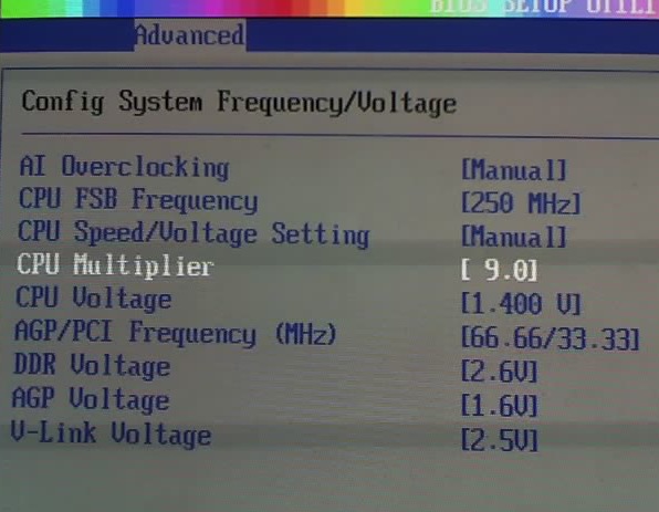

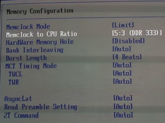

Georgiles Posted October 1, 2006 Share Posted October 1, 2006 AMD X2 3800+ Godfather solved my stuttering problem in two steps: FIRST STEP: Now, as Godfather explained me you have to set up in bios your settings manualy: - reduce the multiplier (click for info) - increase the FSB - memlock to CPU Ratio 5:3 (DDR 333) (for my system he set up the FSB at 250 and multiplier at 9 ) SECOND STEP: 1] open terminal, and stretch the size of the box... make it fairly large to avoid confusion later. 2] type: sudo nano /library/preferences/systemconfiguration/com.apple.Boot.plist 3] enter your password 4] change it to <string>cpuidle=0 -v</string> do this comands: nano /library/preferences/systemconfiguration/com.apple.Boot.plist update_prebinding -root / -force diskutil repairPermissions / STUTTERING GONE!!!!! extra tips he gave me: sudo -s sudo defaults write /Library/Preferences/com.apple.windowserver Compositor -dict deferredUpdates 0 sudo defaults write com.apple.Safari WebKitInitialTimedLayoutDelay -float 0 MANY MANY THANX TO FOR THE INCREDIBLE HELP: Gdfath3r Group: Members Posts: 182 Member No.: 14,294 Joined: 31-October 05 bakerman1ca Link to comment Share on other sites More sharing options...

JeffreySung Posted October 2, 2006 Share Posted October 2, 2006 Hi I read whole pages.. The conclusion is inly Careless had successed. WHY??? Maybe the answer is overclocking. Gerogeanton had successed with overclocking. Today, I tried whole method in this thred and it doesn't work and I tried overclocking. (I had overclocked a few months ago up to 2.5GHz with default voltage.) My original config is 200MHz * 10 and changed to 230MHz * 9.5 (and idlehalt=0 fn=3) It works!!!!!!!!!! The key is multplier number. It should not be 10. (I tried) and...I must test stability check in windows.. Have fun..!! P.S. Sorry for my poor english : ) Link to comment Share on other sites More sharing options...
