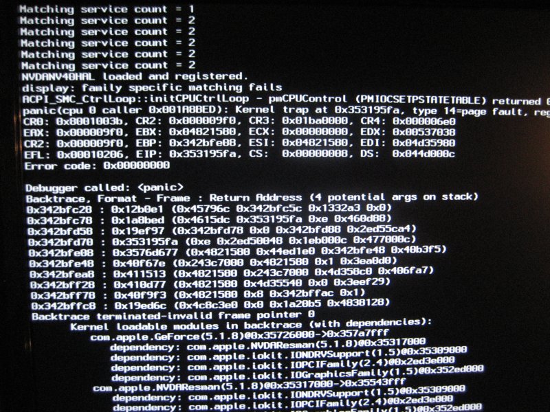

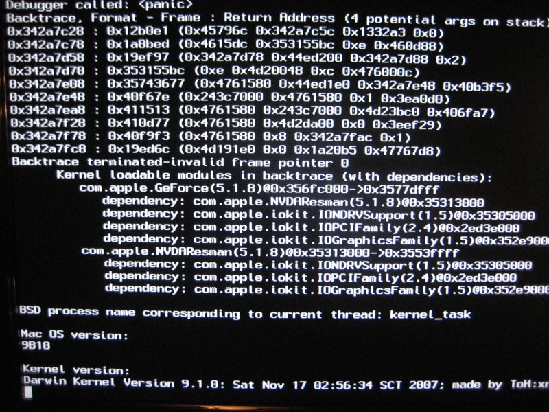

this is what i end up with:
eluminx, I am a n00b w/ OSX, but that kernel panic looks to me to be screaming about the geforce card and it's drivers. What kind of video card do you have? I assume a Geforce of somekind, I would revisit the whole section in .netroller's guide and ensure I have followed it very closely for the GPU type you have. I am using a geforce8800gts and it worked pretty good for me. If it is an 8800GTX GPU, then there is a different driver that is supposedly working for G92 series.
That's my 2 cents. Someone else here can probably tell you more based on that panic. But the kernel panicked because it couldn't load something (a kernel extension) correctly so I am more after what happens right before that panic...Right before the kernel panics, is it trying to load NVDAN30HAL or NVDAN50HAL? or do you see something else? It will be hard to catch maybe...
actually is not hard to catch, this screen will just sit there forever if i let it so i can tell you exactly which file is trying to load. I have a GeForce 7600gt, and i kind of figured that it had something to do with the card, but when i read MAX's guide it said to not choose any video drivers when installing so i didn't and to my surprise when i started the box without any drivers installed and got the same error, it kind of threw me off. I thought it didnt have anything to do with it. i will restart now and see which NVDA.... file it tries to load...

ok is trying to load NVDAN40HAL. Here is the shot:
that screen looks famaliar to me x)
It looks familiar to me too. The best thing I found to do when I was having this problem is to remove the NVDAResman.kext file from /system/library/extensions/. That always let me boot into safemode at the very least. I have a 7600gt too but i couldn't get any drivers to work for the life of me. Then the Punk92 drivers that Max mentioned worked a treat. Since then I have switched to an 8600gt which also worked with those drivers (with dual display working nicely too). Hope this helps!

panic is due to video drivers, just remove nvresman.kext or boot with -x -v and install proper video drivers......if you do go the remove route, make sure to move a back up to your documents folder or whichever your preference because it is needed for the drivers for your card to work when you obtain them
part of his problem is he can't boot with -x yet because he gets into the "loop". So boot -s and follow directions to edit the files... you will understand it's unix... then mv that /System/Library/Extensions/nvresman.kext to nvresman.kext_bak to prevent it from loading. Type exit and it should boot on from there.
Posting that screen was the best thing to do, a lot of others here experienced the same thing(s) during install.
