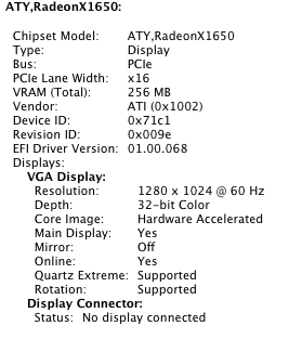

radiohead Posted November 19, 2007 Share Posted November 19, 2007 hi there, thanks, it worked. using both atiinject.kext and edited atiradeonx1000.kext (and hexedit bits as well)... (sapphire pci-e x1650 pro, 256 ram ddr2, device id 0x71c1, leopard 10.5 brazilmac) UPDATE: As of 11/17/07 I removed the install packages from this guide. Too many people where having difficulties with them. I would advise doing it manually until I have time to make better install packages. I would also suggest that you use ATIinject.kext first then if that doesn't work, refer to update 2. Link to comment https://www.insanelymac.com/forum/topic/69345-guide-ati-x1x00-video-cards-on-leopard-qeci-enabled/page/2/#findComment-511917 Share on other sites More sharing options...

TheGreatDeceiver Posted December 5, 2007 Share Posted December 5, 2007 hi there, thanks, it worked. using both atiinject.kext and edited atiradeonx1000.kext (and hexedit bits as well)... (sapphire pci-e x1650 pro, 256 ram ddr2, device id 0x71c1, leopard 10.5 brazilmac) I have the identical card on Leo 10.5.1, followed the instructions to the dot but I always get stuck at the blue screen right before login with mouse cursor. No AGP here, it's pci-e. Any help what I can do? Link to comment https://www.insanelymac.com/forum/topic/69345-guide-ati-x1x00-video-cards-on-leopard-qeci-enabled/page/2/#findComment-528617 Share on other sites More sharing options...

TheGreatDeceiver Posted December 15, 2007 Share Posted December 15, 2007 I have the identical card on Leo 10.5.1, followed the instructions to the dot but I always get stuck at the blue screen right before login with mouse cursor. No AGP here, it's pci-e. Any help what I can do? thought I got it but I either have Qe/Ci with mouse tearing or no Qi/Ci without mouse tearing. here is what I did. I used the flatimage to install Leo. Booted up fine with 1024x768 res on my Dell XPS400 with Saphire X1650 pci-e 256mb, id# 71c1, dual monitor setup with dual dvi. then I did this to find when I get my resolution correct (1280x1024) and get rid of mouse tearing: 1) I used koslowski's 71C1 files (ATIRadeonX1000.kext; ATIRadeonX1000GA.plugin; ATIRadeonX1000GLDriver.bundle). http://forum.insanelymac.com/index.php?showtopic=52826 that alone didn't do anything. I got my res by forcing it in boot.Apple.plist 2) I then installed the other files that I did not change in 1) from the modbin package http://forum.insanelymac.com/index.php?showtopic=35733 I replaced these files: ATINDRV.kext; ATIRadeonX1000VADriver.bundle; IONDRVSupport.kext always fixed permissions, rebooted and voila, no mouse tearing and I have a number of resolutions to pick under display props. but now there is no qe/ci! I tried this the other way around, first installed modbin's package and then 71c1 files, but the same happens. When I put the original ATINDRV.kext back in I have QE/CI back but now with mouse tearing, no resolutions to pick I would like to get dual monitor also, but it only mirrors at the moment and doesn't detect two monitors (un/replug doesn't help, no options in display props) am I missing sth here? thank you edit1: ok, redid everything, this time modbin first then kazlowski's method, but edited original leo files . I end up with the same as above. I have Qe/Ic but mouse tearing and mirrored dvi monitors. edit2: I upgraded to 10.5.1 and reinstalled the kexts. Now I have everything, I can even rotate the screen and have multiple resolutions to pick from. The only thing that is still missing is the second monitor on DVI 2. it just shows black. Under sys profiler in the graphic section it shows Mirror as off. any hints? Is there a software solution for multiple monitors for macs like ultramon for win? Link to comment https://www.insanelymac.com/forum/topic/69345-guide-ati-x1x00-video-cards-on-leopard-qeci-enabled/page/2/#findComment-539144 Share on other sites More sharing options...

radiohead Posted December 19, 2007 Share Posted December 19, 2007 sorry, i was away but i see you managed! congrats! I have the identical card on Leo 10.5.1, followed the instructions to the dot but I always get stuck at the blue screen right before login with mouse cursor. No AGP here, it's pci-e. Any help what I can do? Link to comment https://www.insanelymac.com/forum/topic/69345-guide-ati-x1x00-video-cards-on-leopard-qeci-enabled/page/2/#findComment-542954 Share on other sites More sharing options...
TheGreatDeceiver Posted December 20, 2007 Share Posted December 20, 2007 sorry, i was away but i see you managed! congrats! yeah, thanks. the only thing I'd like to get is both DVI working for my dual monitor setup. it only recognizes one of them. if you have any idea, let me know thanks Link to comment https://www.insanelymac.com/forum/topic/69345-guide-ati-x1x00-video-cards-on-leopard-qeci-enabled/page/2/#findComment-543863 Share on other sites More sharing options...
