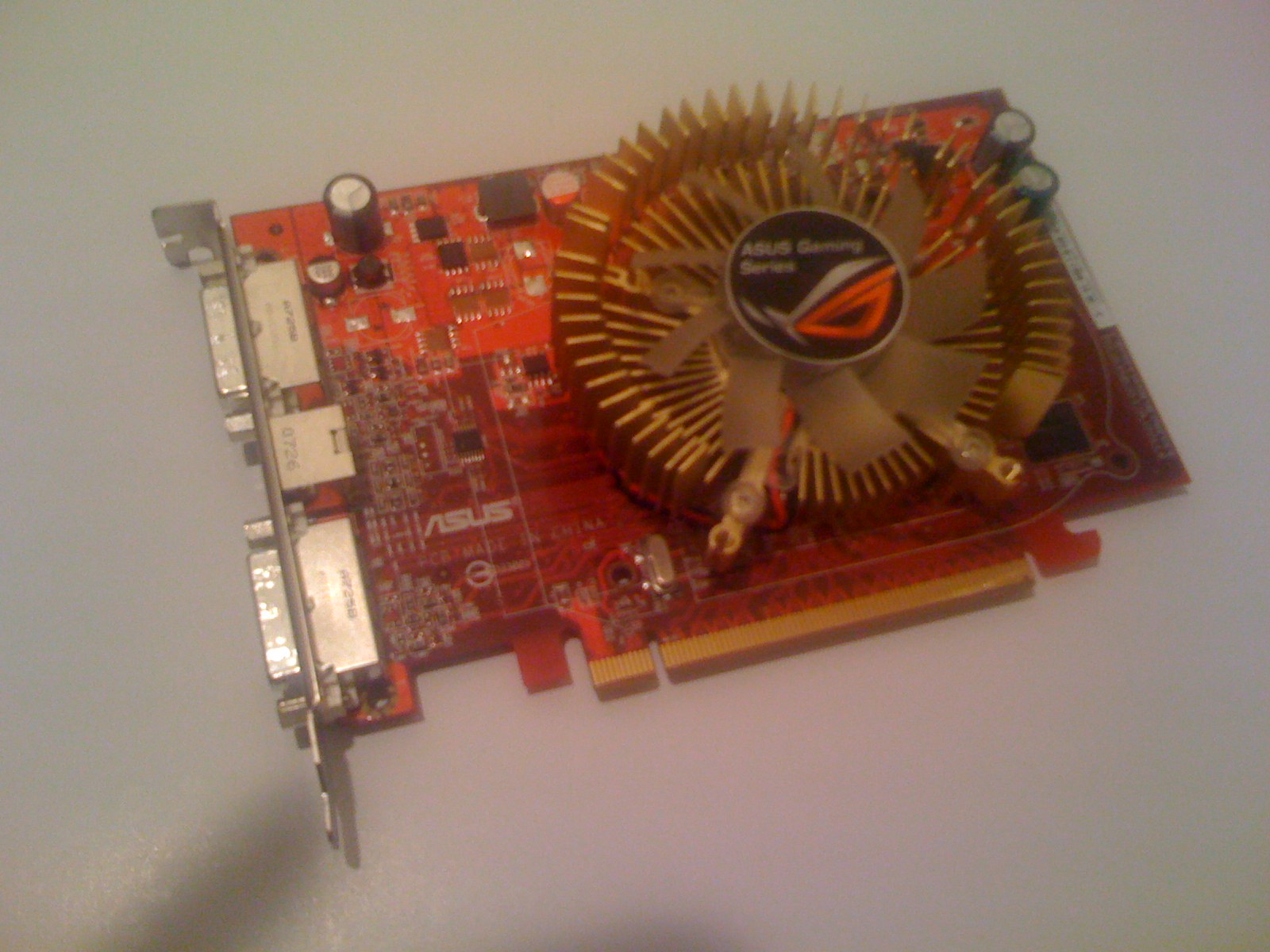

system : Kaliway Leopard 10.5.1
mainboard : asus p5k
cpu : core2 quadram : 2 gb kingston
and video card : asus EAH2600PRO 256 mb ddr2/htdp
can someone confirm that it works ?????
for me, it works very well but i'm now installing a 8800 GTX... :D
