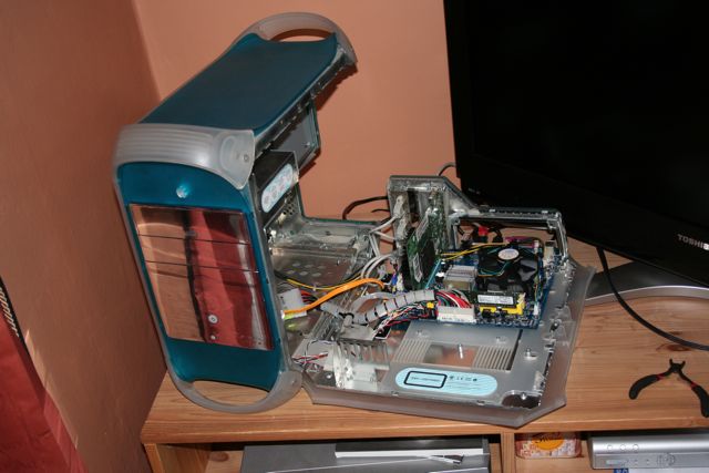

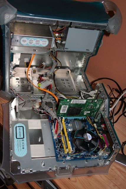

hipunk Posted July 19, 2008 Share Posted July 19, 2008 http://skitch.com/showgetter/ Maybe I will add some pics later today or tomorrow... My G3 Mod. I didn't know that so many guys here already did a G3 mod with a mATX mobo... Specs: Asus P5GC-MX/1333 Core2Duo E8200 @ 2.66GHz (Stock) 2 x 1GB Dual Channel 667MHz Ram 120GB Samsung Spinpoint unsing ATA GeForce 7200GS 256MB PCI Lan Card, the onboard Lan has no drivers for OS X The DVD drive was one I already had. It's the Samsung Super-Writemaster 18x. It's not so long as normals DVD drives. Everything is running fast and without big problems using vanilla kernel. Link to comment https://www.insanelymac.com/forum/topic/59926-blue-white-g3-case-mod/page/4/#findComment-825718 Share on other sites More sharing options...
Hagar Posted July 19, 2008 Share Posted July 19, 2008 http://skitch.com/showgetter/Maybe I will add some pics later today or tomorrow... My G3 Mod. I didn't know that so many guys here already did a G3 mod with a mATX mobo... Specs: Asus P5GC-MX/1333 Core2Duo E8200 @ 2.66GHz (Stock) 2 x 1GB Dual Channel 667MHz Ram 120GB Samsung Spinpoint unsing ATA GeForce 7200GS 256MB PCI Lan Card, the onboard Lan has no drivers for OS X The DVD drive was one I already had. It's the Samsung Super-Writemaster 18x. It's not so long as normals DVD drives. Everything is running fast and without big problems using vanilla kernel. LOL I don't believe it, I run that exact same motherboard in that exact same case! Link to comment https://www.insanelymac.com/forum/topic/59926-blue-white-g3-case-mod/page/4/#findComment-825722 Share on other sites More sharing options...
hipunk Posted July 19, 2008 Share Posted July 19, 2008 LOL I don't believe it, I run that exact same motherboard in that exact same case! Rly? Cool. I didn't read the whole thread because I don't have desire to read it... But I've already seen your Hägar ava... Link to comment https://www.insanelymac.com/forum/topic/59926-blue-white-g3-case-mod/page/4/#findComment-825799 Share on other sites More sharing options...
