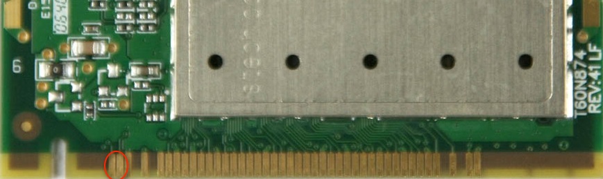

Yarrix's tip on taping pins 11 and 13 works on an Atheros AR5BMB5 mini-PCI wireless card. I no longer have to mess with the on/off switch! Thanks for the tip Yarrix.
For those who are absolutely unable to follow the discussion in this topic here is what the pins look like.
The main and aux antennae plugs should be facing upwards. The first two pins from the left should be taped over.

It's the one on the opposite side of the one in red (if you flip the card over. there's a pin labeled 18, it's right beside it). sorry don't have a cam on hand to take a picture of the back side.
By the way, tried the fix. Works in Windows, i.e. the switch on my laptop doesn't do anything + LED stays on. In Mac OS, no light, still nothing detected in network prefs or system profiler.

I am running IPC_OSX86 beta and covered pin 20 but the card is still not detected in OS X (though it is in Vista). I am confused, though. Could someone who got this to work clarify. You are only covering the pin next to the one marked 18 and only on ONE side of the card, yes? Otherwise it would be pin twenty and pin... whatever the pin on the flip side of the card is. Post 61 seems to be saying both sides of the card. My laptop is an Acer 4720z; the model listed below works without any modification using the same card. I did select the broadcom wireless package during install of IPC_OSX86.

EDIT: I recall, pin 20 it's correct i missunderstood the picture and covered the ping with the card facing front and not backwards. It's the pin located next to pin 18.
