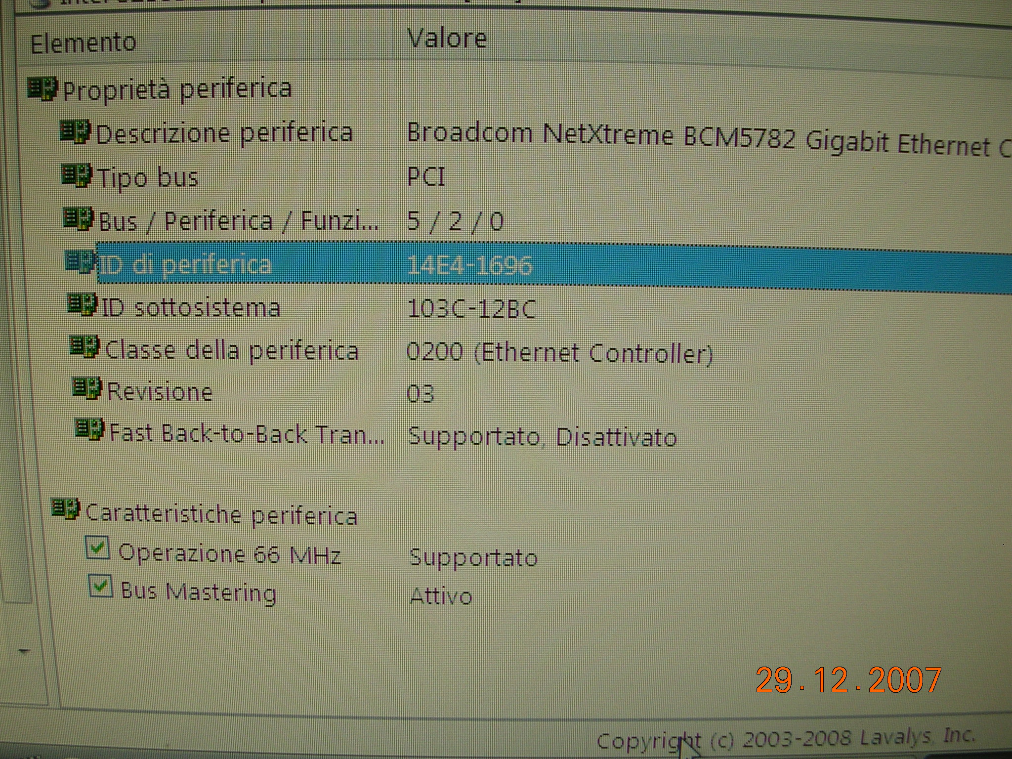

unicomagno Posted December 29, 2007 Share Posted December 29, 2007 This is my integrated ethernet controller Broadcom Netxtreme BCM5782 Gigabit: Help my for configuration kext... Link to comment https://www.insanelymac.com/forum/topic/4987-broadcom-570x-and-575x/page/15/#findComment-556460 Share on other sites More sharing options...
