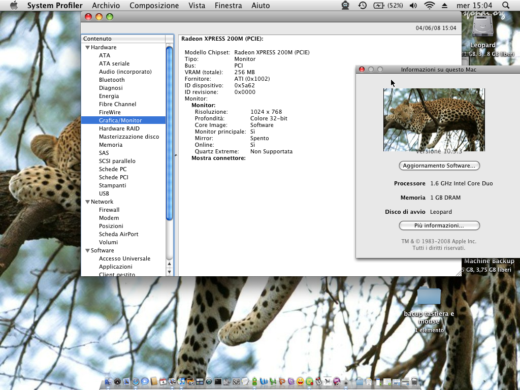

Eddie94 Posted June 4, 2008 Share Posted June 4, 2008 Ok boys....look this photo of my pc.....not questions..... Isn't sucessfully at 100% yet (scuse me for my bad english ) Link to comment https://www.insanelymac.com/forum/topic/47944-radeon-xpress-200m/page/16/#findComment-770629 Share on other sites More sharing options...

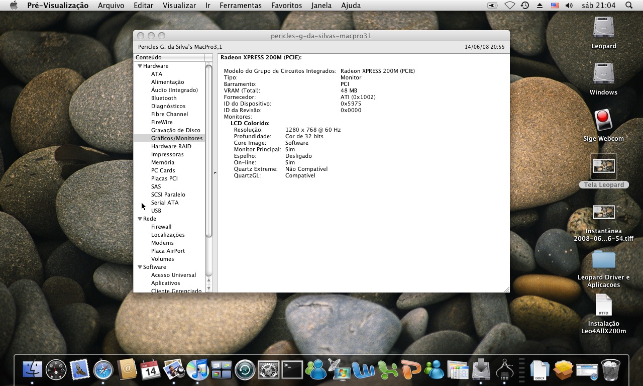

Pericles Silva Posted June 15, 2008 Share Posted June 15, 2008 Hello for all. First, congrats to Slice and to the others who have try this Graphic Card to have accelaration. Well, i have the same problem above: I use a Acer 5040, with X200M Graphic Card. After i put Mac Pilot, i can make CE for Software... but memory shows only 48mb (even i set 256mb in BIOS). Resolution works after download the Calisto003 Fixed and put the kext in the Extensions Folder. Well, if help someone, here goes my specs: (some translation, because i'm brazilian) Radeon XPRESS 200M (PCIE): Modelo do Grupo de Circuitos Integrados: Radeon XPRESS 200M (PCIE) Tipo: Monitor Barramento: PCI VRAM (Total): 48 MB (P.S.: I set 256mb in BIOS) Fornecedor: ATI (0x1002) ID do Dispositivo: 0x5975 ID da Revisão: 0x0000 Monitores: LCD Colorido: Resolução: 1280 x 768 @ 60 Hz Profundidade: Cor de 32 bits Core Image: Software Monitor Principal: Sim (Yes) Espelho: Desligado (off) On-line: Sim (Yes) Quartz Extreme: Não Compatível (Not Compatible) QuartzGL: Compativel (Compatible) I think if we can change the memory size, we will have more speed in Graphics... i try to understand the explanations, but, i can't understand it... In Windows, appears like ATI RADEON XPRESS 200M, and appears the 256mb of memory. Thanks to all!!! Link to comment https://www.insanelymac.com/forum/topic/47944-radeon-xpress-200m/page/16/#findComment-783859 Share on other sites More sharing options...

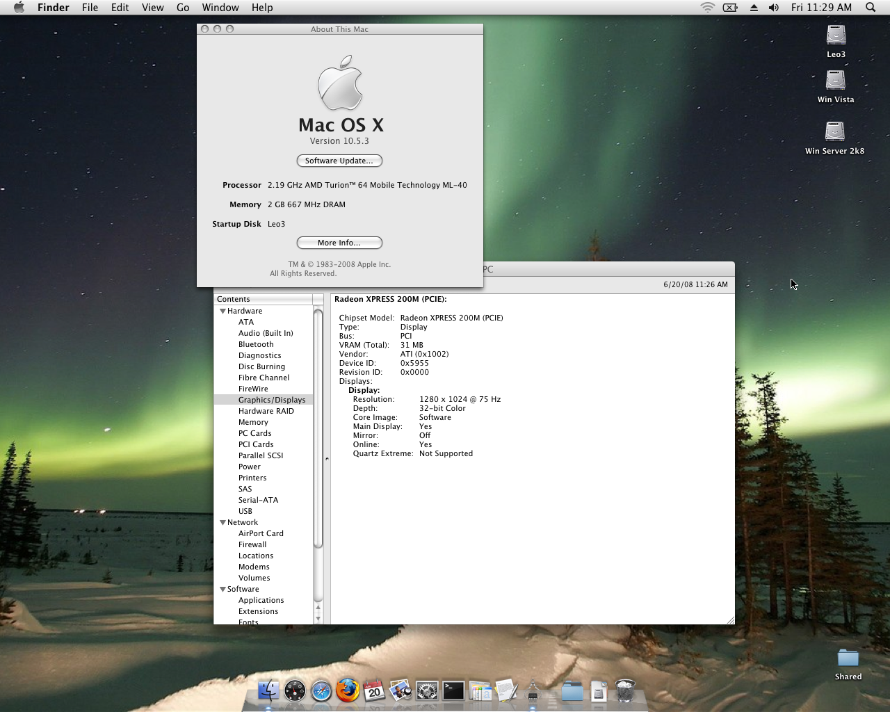

alien2xx Posted June 20, 2008 Share Posted June 20, 2008 Thanks Slice... Its a good chipset, Vista runs beautifully on this (aero), its a shame that it cant be done yet for Mac OSX, This is probably what is stopping me (and probably many other users) from enjoying 100% Leopard ... I really wish that someone with the skills would put their hand on this and make it work... Slice you have done a great job and I thank you for it... Please dont let this die ... Thanks again. alien2xx Its a 128MB dedicated video, Callisto version 6 drivers reads it as 31MB. Link to comment https://www.insanelymac.com/forum/topic/47944-radeon-xpress-200m/page/16/#findComment-791064 Share on other sites More sharing options...
