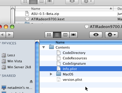

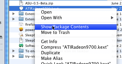

alien2xx Posted June 20, 2008 Share Posted June 20, 2008 I have Tiger...and i try to it....,alien, can you made an ATIRadeon9700.kext patched for this id :5a62Thanks! The ATISlice set the model to Unknow ATI because my ATIRadeon9700.kext doesn't have a god patch for my id! Thanks Alien! Hi, this is very simple to change and you can do it very easely, just open the kext file: If you are doing it from a MAC OSx, just right click on it and select "Show Package Contents", it will open a window, navigate inside and find the file called" info.plist", then open that file with any text editor, look for the line (see picture and just add your ID device number to it. If you are doing it from a windows machine just browse to the file and change it, the kext will show as a directory under windows... Link to comment https://www.insanelymac.com/forum/topic/47944-radeon-xpress-200m/page/17/#findComment-791324 Share on other sites More sharing options...

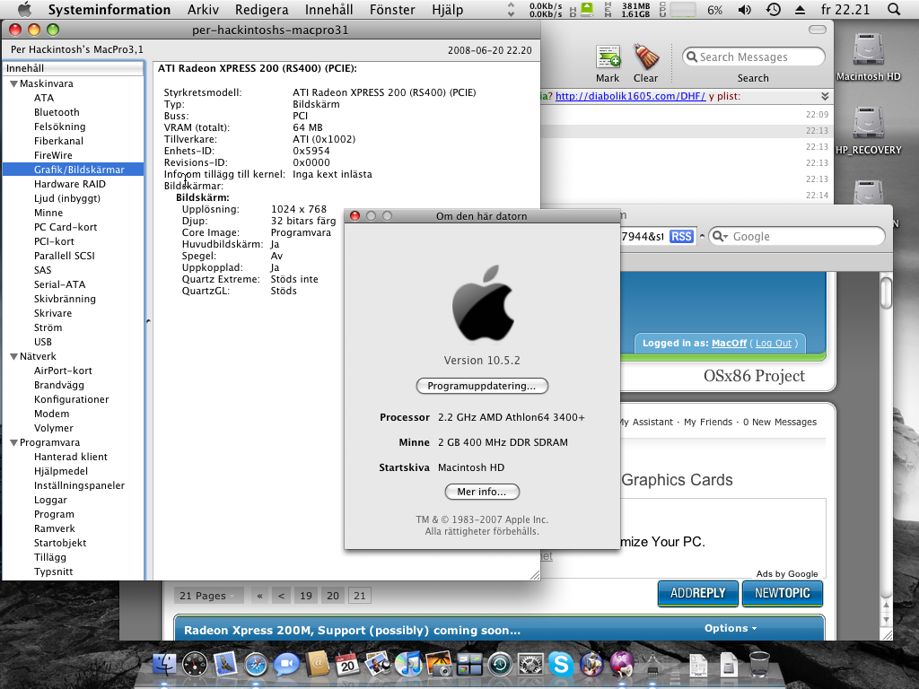

macoff Posted June 20, 2008 Share Posted June 20, 2008 Good, I tried kext of Slice and recognizes the X200, but without QE / QI and unable to change the resolution. You've tried the patch koverg, but Leopard freezer ... I also edited the ATIRadeon9700.kext without fortune ... Greetings MacOff PS sorry for my bad English Link to comment https://www.insanelymac.com/forum/topic/47944-radeon-xpress-200m/page/17/#findComment-791408 Share on other sites More sharing options...
Slice Posted June 20, 2008 Share Posted June 20, 2008 1. Use ATILead instead of ATISlice. It is replacement! The most interesting settings is F8,size. when 0x00300000 you cat have QE/CI but slow. If greater - black screen. 2. About ATIRadeon9700.kext I already made a patch in the thread and say how to patch to another DevID using perl command. Search! 3. If your kext is PowerPC only - drop it to trash and look for other Intel version. 4. Anymore you can't get full speed QE/CI because there is NO SOLUTION YET. Link to comment https://www.insanelymac.com/forum/topic/47944-radeon-xpress-200m/page/17/#findComment-791427 Share on other sites More sharing options...

Eddie94 Posted June 21, 2008 Share Posted June 21, 2008 Try to make binary patch for ATIRadeon9700.kext. Extract file ATIRadeon9700.kext/Contents/MacOS/ATIRadeon9700 to any place you like. Make the follow perl -pi -e 's|\x66\x3d\x4e\x4a|\x66\x3d\x55\x59|g' ATIRadeon9700 perl -pi -e 's|\x66\x3d\x48\x4a|\x66\x3d\x55\x59|g' ATIRadeon9700 I assume DevID=5955 - last digits in the string in reverse order. You need to do both commands! In some versions of ATIRadeon9700 it is not work. In this case you need other commands perl -pi -e 's|\x3d\x4e\x4a\x00|\x3d\x55\x59\x00|g' ATIRadeon9700 perl -pi -e 's|\x3d\x48\x4a\x00|\x3d\x55\x59\x00|g' ATIRadeon9700 Then replace original file with patched, repair permissions and try! The bynary patch!I try! Link to comment https://www.insanelymac.com/forum/topic/47944-radeon-xpress-200m/page/17/#findComment-791892 Share on other sites More sharing options...
