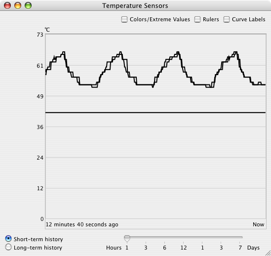

frankietabs Posted February 23, 2007 Share Posted February 23, 2007 Okik, what temp are you getting off your laptop with speedstep? I am getting 65 at idle and it goes to about 74 when using the computer. Mine is a Core 2 Duo. paulicat, the kext in my installer, was not the one you distributed, i had to edit it a bit to make it work on my Core 2 Duo's, it also worked on all my other Pentium 4's. (3.0ghz sse3) and on my Core Duo laptop. I can make a pkg with the kext u distributed in it as well, if thats what you want. Link to comment https://www.insanelymac.com/forum/topic/42865-howto-sse3-kernel-with-sleep-speedstep/page/2/#findComment-309260 Share on other sites More sharing options...
mifki Posted February 23, 2007 Share Posted February 23, 2007 for my core 2 duo, i get 53C reported (but take 10C off that for bias) and it = 43C. I think bresink adds a couple of C to it, because 74C is crazy, that'd burn a chicken. If you can, load up the cpu heaps in Mac OS X, then look in ur bios (if u have a heat sensor) Paulicat, i'll try get to irc this afternoon, as here (at college, we have a firewall). If i miss you i'll send you a PM, but basically its just the source code off niall's site. Link to comment https://www.insanelymac.com/forum/topic/42865-howto-sse3-kernel-with-sleep-speedstep/page/2/#findComment-309268 Share on other sites More sharing options...
