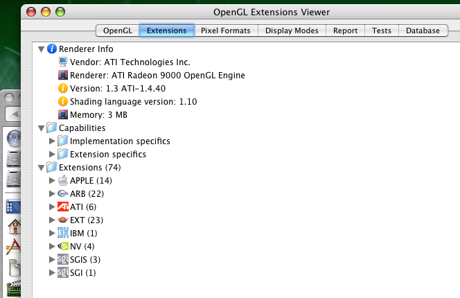

Slice Posted November 18, 2007 Share Posted November 18, 2007 Preliminary rezult Link to comment Share on other sites More sharing options...
DJ HORA Posted November 18, 2007 Share Posted November 18, 2007 Slice, can u tell us more details abt your glview result??? i've a 5835 too and with agpgart 2.4.3 i got almost no glitches at quicktime, but wasnt able to run dvd or anything elses related to opengl... i see on your gl extension it seems to have a drive loaded.... do u want help testing, since we have the same devid?? Best regards and thx for dedicate so much time to all of us!!! Link to comment Share on other sites More sharing options...
Slice Posted November 19, 2007 Share Posted November 19, 2007 Slice, can u tell us more details abt your glview result??? i've a 5835 too and with agpgart 2.4.3 i got almost no glitches at quicktime, but wasnt able to run dvd or anything elses related to opengl...i see on your gl extension it seems to have a drive loaded.... do u want help testing, since we have the same devid?? Best regards and thx for dedicate so much time to all of us!!! It is preliminary rezult. I have OpenGL loaded but it crashes and as you see I have OpenGL memory only 3Mb while in XP I have 32+54MB. I need testing with another kind of 9000/9100/9200 to understand what is wrong. With 5835 I can test by myself. But I get only reports "Not working..." and no information. Link to comment Share on other sites More sharing options...

Slice Posted November 20, 2007 Share Posted November 20, 2007 Can u provide me the files u r using??? my 9100 is 128mb shared. maybe i can get more lucky or another result to help u. I am using ATIRadeon8500*.* files v1.4.40 from 10.4.8, they works in any system version. But the main driver needs to be patched. I uploaded it here http://forum.insanelymac.com/index.php?act...st&id=15538 The picture above I can get only with 16Mb shared memory. Or with 32Mb but with little cracking driver ATISlice.kext. It is injector like natit but with my additional settings. It is useful to set correct Video Memory Size, name of the card and display type. You can also set any value such as jodo hacker Can I provide anything else but the dmesg and the ioreg from AGPGart 243 with the radeon 8500? jodo! I have no any report from you. Look to my thread about AGPGart. http://forum.insanelymac.com/index.php?sho...=71308&st=0 Can you show me so useful report? And you still don't say me how you successful with different kexts combinations as I ask before. P.S. I have new idea: I need to create agpMemory inside AGRGart driver (only for IGP cards) Link to comment Share on other sites More sharing options...

Slice Posted November 22, 2007 Share Posted November 22, 2007 jodo! Deadend for you as for all other AGP card. Destroy it AGP driver works only with AMD64 CPU. If your video can get QE/CI in PCI mode use it. Else no any way. For users 5835. As I have something like hardwareOpenGL I should try to make 8500 working as PCIE. I have a chance because of shared memory lies in common memory space and don't need AGP driver. It is very hard to get informations by numerous of booting. I have no find any technical information about Radeon chip from ATI. Linux driver is a s h i t. WinXP uses softwareOpenGL or something like it. In it I have find only one hardware setting - base_memory_address. My driver uploaded above do the same and works kirky. WinXP with OpenGL Extension Viewer crashes too Next step? During working the computer may dies... Link to comment Share on other sites More sharing options...
