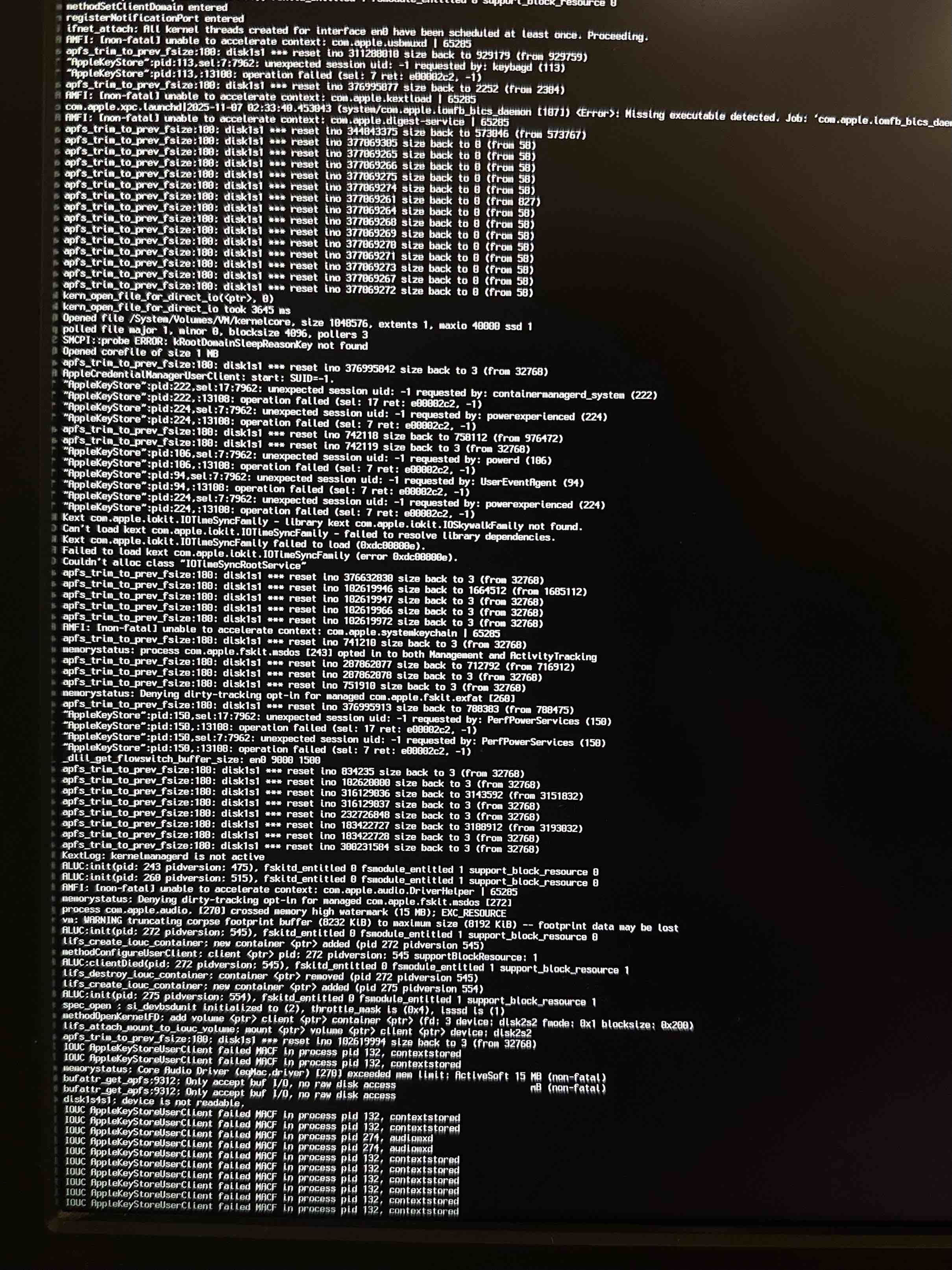

dorts Posted November 6, 2025 Share Posted November 6, 2025 13 minutes ago, ichelash said: can you post your config plist or EFI I've attached the file, thanks in advance! config.plist Link to comment https://www.insanelymac.com/forum/topic/361912-release-macos-tahoe-261/page/3/#findComment-2843240 Share on other sites More sharing options...

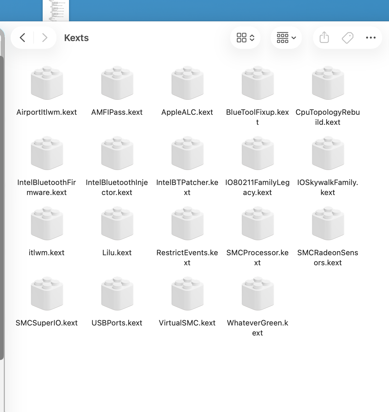

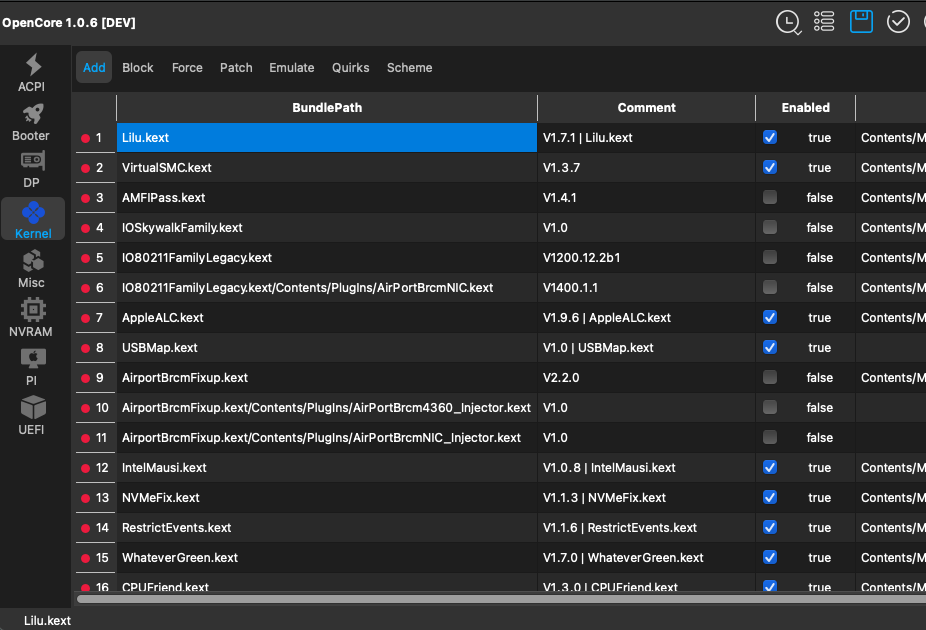

ichelash Posted November 6, 2025 Share Posted November 6, 2025 2 minutes ago, dorts said: I've attached the file, thanks in advance! config.plist 61.85 kB · 0 downloads can you try and disable all wifi kexts..like shown below...and also make sure your kexts are up to date Link to comment https://www.insanelymac.com/forum/topic/361912-release-macos-tahoe-261/page/3/#findComment-2843241 Share on other sites More sharing options...
dorts Posted November 6, 2025 Share Posted November 6, 2025 31 minutes ago, ichelash said: can you try and disable all wifi kexts..like shown below...and also make sure your kexts are up to date Yes I my kexts are all up to date. Tried disabling them as you advised but no change. I am still able to boot in safe mode, but not normally. Here's the attached log: Link to comment https://www.insanelymac.com/forum/topic/361912-release-macos-tahoe-261/page/3/#findComment-2843242 Share on other sites More sharing options...
Matgen84 Posted November 6, 2025 Share Posted November 6, 2025 Hi @dorts Please complete your signature with your hardware like mine or @ichelash for example. 2 Link to comment https://www.insanelymac.com/forum/topic/361912-release-macos-tahoe-261/page/3/#findComment-2843247 Share on other sites More sharing options...
strangeron Posted November 6, 2025 Share Posted November 6, 2025 4 hours ago, dorts said: All kexts and OC has been updated, If the UsbMap.kext was designed for Sequoia, it will not work on Tahoe. WEG.kext version 1.7.0 causes problems on Tahoe. Similarly, Wi-Fi/BT kexts can cause problems during installation. 3 Link to comment https://www.insanelymac.com/forum/topic/361912-release-macos-tahoe-261/page/3/#findComment-2843250 Share on other sites More sharing options...
dorts Posted November 6, 2025 Share Posted November 6, 2025 49 minutes ago, eSaF said: Hi clean the NvRAM and try this config.plist. I have entered Min/MaxKernel Data for SkywalkFamily.kext and associates in your config.plist. I don't know if that was the issue but it's worth a try. Good luck. PS- Remove the -amfipassbeta boot-arg it is no longer needed Cheers. config.plist.zip 7.04 kB · 5 downloads Thanks for the updated file. Sadly I still encounter the same issue and it gets stuck at the same place. Any other ideas? 16 minutes ago, strangeron said: If the UsbMap.kext was designed for Sequoia, it will not work on Tahoe. WEG.kext version 1.7.0 causes problems on Tahoe. Similarly, Wi-Fi/BT kexts can cause problems during installation. Usbmap.kext was updated for Tahoe in safe mode as I've read previously. If WEG.kext was an issue why would safe mode work? I did try disabling it however it would not boot either and was stuck at the same place during boot. 2 hours ago, Matgen84 said: Hi @dorts Please complete your signature with your hardware like mine or @ichelash for example. Updated! Link to comment https://www.insanelymac.com/forum/topic/361912-release-macos-tahoe-261/page/3/#findComment-2843253 Share on other sites More sharing options...
deeveedee Posted November 6, 2025 Share Posted November 6, 2025 @dorts Post your USBMap.kext. Why are you enabling Kernel > Quirks > XhciPortLimit? Link to comment https://www.insanelymac.com/forum/topic/361912-release-macos-tahoe-261/page/3/#findComment-2843254 Share on other sites More sharing options...
strangeron Posted November 6, 2025 Share Posted November 6, 2025 26 minutes ago, dorts said: If WEG.kext was an issue why would safe mode work? I did try disabling it however it would not boot either and was stuck at the same place during boot. Why wouldn't it turn on? If the problem is with the RX570, it will already be disabled in safe mode. Link to comment https://www.insanelymac.com/forum/topic/361912-release-macos-tahoe-261/page/3/#findComment-2843255 Share on other sites More sharing options...
Sherlocks Posted November 6, 2025 Share Posted November 6, 2025 On 11/5/2025 at 12:44 AM, Matgen84 said: @laobamac_yyds the csr-active-config value is already add to delete. On my post, I'm talking about GateKeeper. I disable it with sudo spctl --global-disable and confirm in System settings (I also try --master-disable). But after each update, GateKeeper is enable by default. So apps are moving to relocated items/security/... I made a lot of search and test without success. To prevent big headache, I need a solution. 🥲 Same. I also faced this issue. I searched many info for gatekeeper. But no luck. To resolve this issue, we need to gather same info. What is your mac model? I use imacpro1,1 and csr 03080000 and amfi kext. Link to comment https://www.insanelymac.com/forum/topic/361912-release-macos-tahoe-261/page/3/#findComment-2843275 Share on other sites More sharing options...
Slice Posted November 7, 2025 Share Posted November 7, 2025 19 hours ago, dorts said: Yes I my kexts are all up to date. Tried disabling them as you advised but no change. I am still able to boot in safe mode, but not normally. Here's the attached log: May be switch off VT-d? Link to comment https://www.insanelymac.com/forum/topic/361912-release-macos-tahoe-261/page/3/#findComment-2843299 Share on other sites More sharing options...

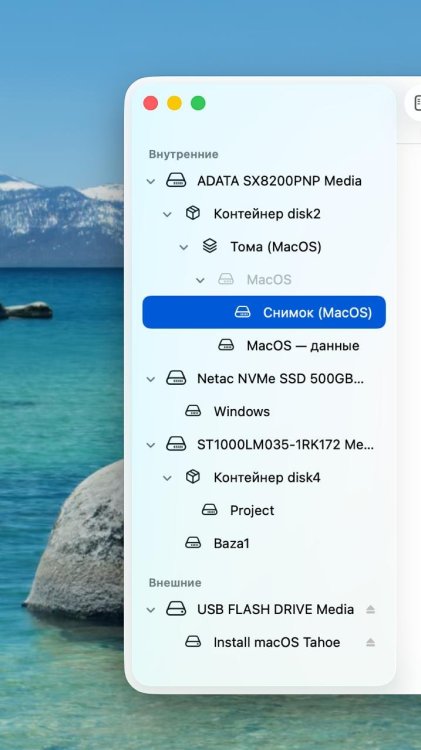

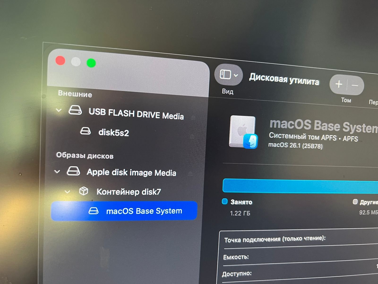

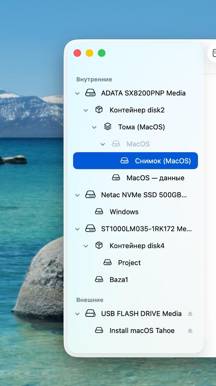

ANTIKO Posted November 7, 2025 Share Posted November 7, 2025 A strange problem, I decided to perform a clean install of 25B78, but I am faced with a situation that I do not understand. The same EFI sees the disks in the already updated system, but not in the installer. I'm kind of stumped🥴 Spoiler 1 Link to comment https://www.insanelymac.com/forum/topic/361912-release-macos-tahoe-261/page/3/#findComment-2843307 Share on other sites More sharing options...
spakk Posted November 7, 2025 Share Posted November 7, 2025 28 minutes ago, ANTIKO said: A strange problem, I decided to perform a clean install of 25B78, but I am faced with a situation that I do not understand. The same EFI sees the disks in the already updated system, but not in the installer. I'm kind of stumped🥴 Hide contents This is possibly due to a missing Lilu.kext and NVMeFix.kext for your ADATA SX8200PNP media? Check that. Link to comment https://www.insanelymac.com/forum/topic/361912-release-macos-tahoe-261/page/3/#findComment-2843308 Share on other sites More sharing options...
ANTIKO Posted November 7, 2025 Share Posted November 7, 2025 13 minutes ago, spakk said: This is possibly due to a missing Lilu.kext and NVMeFix.kext for your ADATA SX8200PNP media? Check that. Thanks for the answer! but what does Lilu.kext have to do with it? he is present. NVMeFix.I don't need kext, I write that the installer doesn't see anything, although the same EFI runs 25B78 perfectly, already installed. Spoiler Link to comment https://www.insanelymac.com/forum/topic/361912-release-macos-tahoe-261/page/3/#findComment-2843309 Share on other sites More sharing options...
spakk Posted November 7, 2025 Share Posted November 7, 2025 45 minutes ago, ANTIKO said: Thanks for the answer! but what does Lilu.kext have to do with it? he is present. NVMeFix.I don't need kext, I write that the installer doesn't see anything, although the same EFI runs 25B78 perfectly, already installed. Reveal hidden contents This is just a guess and should be tested. NVMeFix.kext requires Lilu.kext because Lilu provides fundamental kernel patching services that NVMeFix uses. Check the kexts again after installation to pinpoint the cause more accurately. 2 Link to comment https://www.insanelymac.com/forum/topic/361912-release-macos-tahoe-261/page/3/#findComment-2843311 Share on other sites More sharing options...
spakk Posted November 7, 2025 Share Posted November 7, 2025 1 hour ago, ANTIKO said: Thanks for the answer! but what does Lilu.kext have to do with it? he is present. NVMeFix.I don't need kext, I write that the installer doesn't see anything, although the same EFI runs 25B78 perfectly, already installed. Reveal hidden contents 15 minutes ago, eSaF said: Hi Bro, a few things to check. Insure all kexts are the very latest versions, UEFI/APFS/EnableJumpstart is enabled. There is a possibility an errant setting could have crept into what was working before that is now giving a problem. Compare a working config.plist with your current one to see if an unintentional change was made. Good luck. Cheers. Anything is possible, so make sure to check everything, including whether AHCI mode is enabled in the BIOS. I recently made some changes to the BIOS on a running system with macOS Tahoe 26.01 and macOS Sequoia 15.7.1 to use a tool under Windows, and completely forgot to revert them. The installed macOS systems were not affected. When I tried to install macOS 26.1 the day before yesterday, I couldn't boot into the installer. Only after a colleague in a forum mentioned the possibility of missing kext drivers did I remember the BIOS changes I had made. Once I reverted them, booting and installing macOS 26.1 worked immediately. So never rule anything out, even if everything has been working fine before. 1 Link to comment https://www.insanelymac.com/forum/topic/361912-release-macos-tahoe-261/page/3/#findComment-2843313 Share on other sites More sharing options...

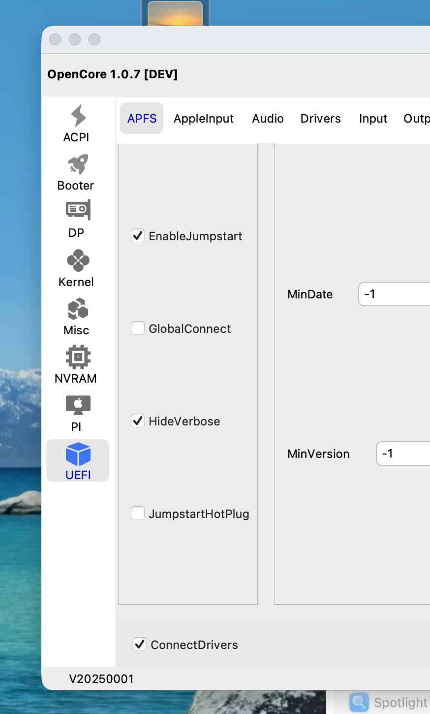

ANTIKO Posted November 7, 2025 Share Posted November 7, 2025 (edited) 25 minutes ago, eSaF said: Hi Bro, a few things to check. Insure all kexts are the very latest versions, UEFI/APFS/EnableJumpstart is enabled. There is a possibility an errant setting could have crept into what was working before that is now giving a problem. Compare a working config.plist with your current one to see if an unintentional change was made. Good luck. Cheers. 6 minutes ago, spakk said: Anything is possible, so make sure to check everything, including whether AHCI mode is enabled in the BIOS. I recently made some changes to the BIOS on a running system with macOS Tahoe 26.01 and macOS Sequoia 15.7.1 to use a tool under Windows, and completely forgot to revert them. The installed macOS systems were not affected. When I tried to install macOS 26.1 the day before yesterday, I couldn't boot into the installer. Only after a colleague in a forum mentioned the possibility of missing kext drivers did I remember the BIOS changes I had made. Once I reverted them, booting and installing macOS 26.1 worked immediately. So never rule anything out, even if everything has been working fine before. Everything is included, Opencore version 107, thanks anyway! I am currently updating to 26.2 (25C5031i) Spoiler Edited November 7, 2025 by ANTIKO 1 Link to comment https://www.insanelymac.com/forum/topic/361912-release-macos-tahoe-261/page/3/#findComment-2843314 Share on other sites More sharing options...

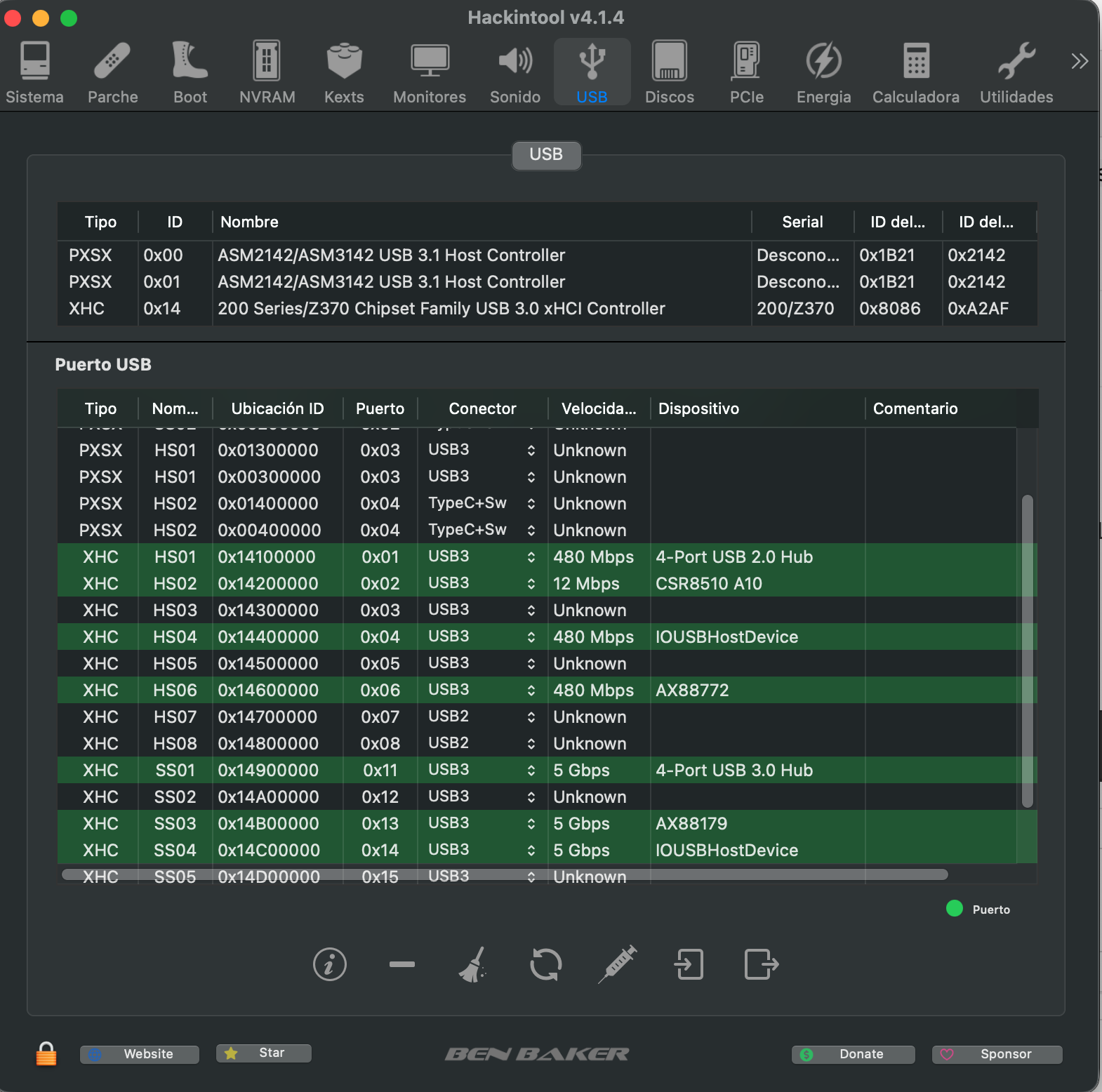

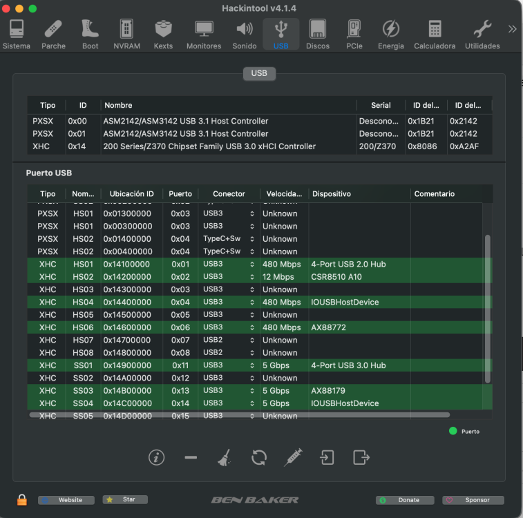

Alan Mac Posted November 12, 2025 Share Posted November 12, 2025 My motherboard (ASRock B660M Phantom Gaming 4), from what I've researched, uses an ASMedia USB controller, so the USB 3.0 ports only function as 2.0 on the Tahoe 26.1. Does anyone know how to help me with this? 1 Link to comment https://www.insanelymac.com/forum/topic/361912-release-macos-tahoe-261/page/3/#findComment-2843601 Share on other sites More sharing options...
Oyecomova Posted November 12, 2025 Share Posted November 12, 2025 58 minutes ago, Alan Mac said: Mi placa base (ASRock B660M Phantom Gaming 4), según mis investigaciones, utiliza un controlador USB ASMedia, por lo que los puertos USB 3.0 solo funcionan como 2.0 en la Tahoe 26.1. ¿Alguien sabe cómo ayudarme con esto? If you have this in Hackintool, it generates the SSDT-UIAC.aml file. 1 Link to comment https://www.insanelymac.com/forum/topic/361912-release-macos-tahoe-261/page/3/#findComment-2843603 Share on other sites More sharing options...

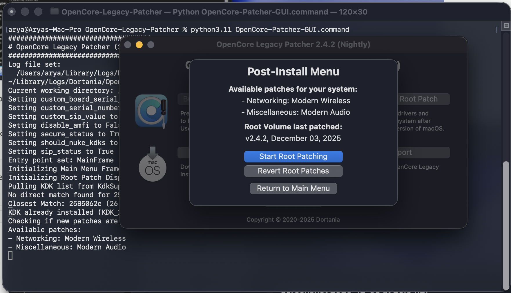

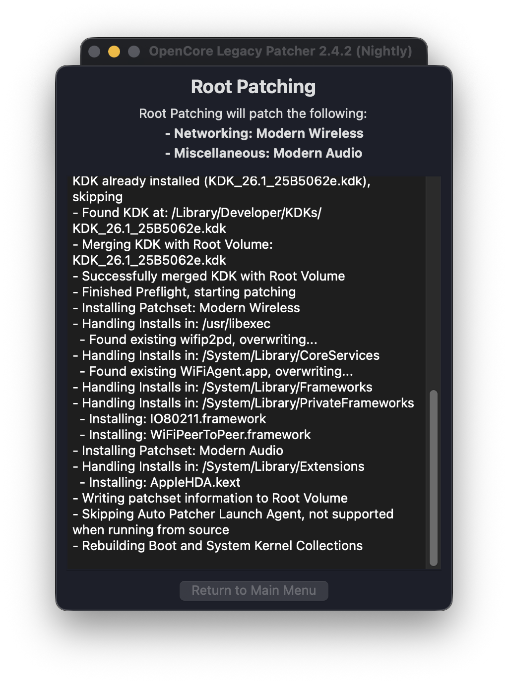

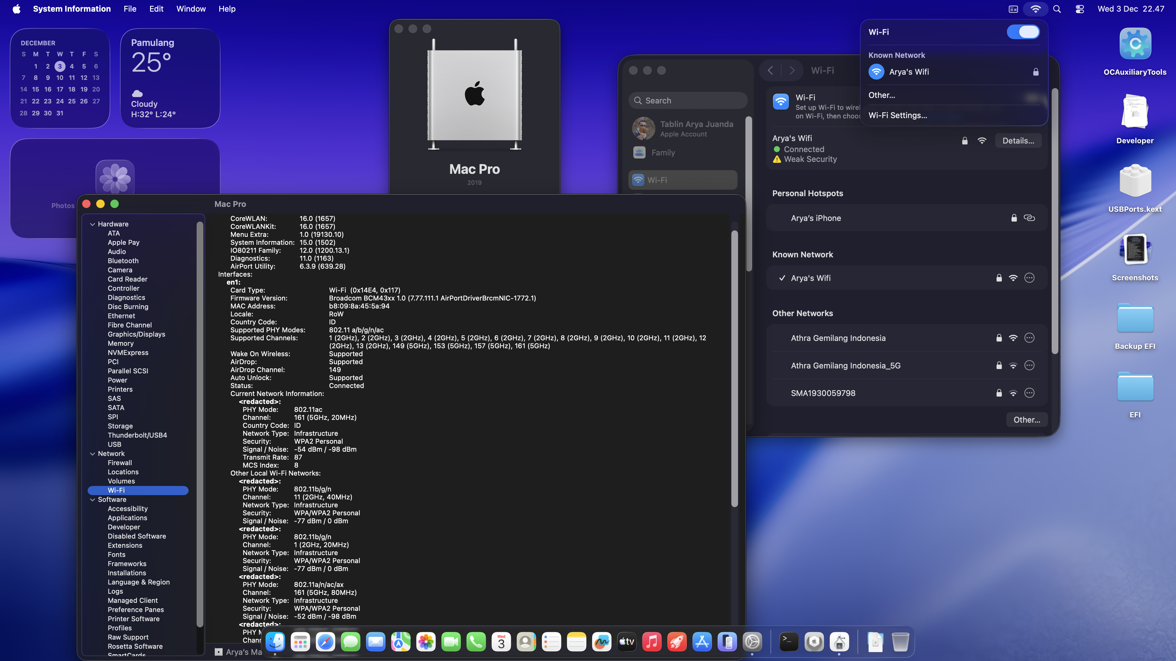

arya Posted December 3, 2025 Share Posted December 3, 2025 (edited) Spoiler hope the OCLP team gonna release it soon... I just test the new patch and run locally.. working wifi patch, airdrop, continuity, etc Edited December 3, 2025 by arya spoiler Link to comment https://www.insanelymac.com/forum/topic/361912-release-macos-tahoe-261/page/3/#findComment-2844435 Share on other sites More sharing options...
deeveedee Posted December 3, 2025 Share Posted December 3, 2025 @arya Where did you find an OCLP 2.4.2 that supports Tahoe? Link to comment https://www.insanelymac.com/forum/topic/361912-release-macos-tahoe-261/page/3/#findComment-2844436 Share on other sites More sharing options...
