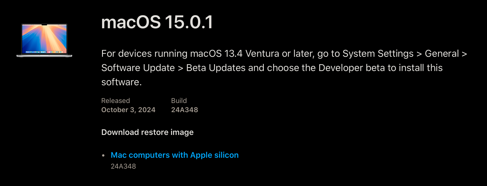

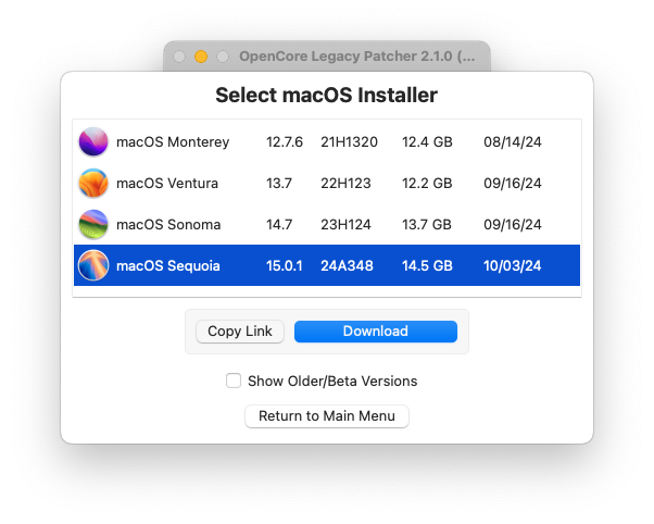

Max.1974 Posted October 4, 2024 Share Posted October 4, 2024 (edited) https://swcdn.apple.com/content/downloads/05/43/072-01382-A_5URDEOHRHL/chwodorv8xcjx5ea41i5gmmw9ofgjwxtq1/InstallAssistant.pkg Sequoia 15.0.1 Edited October 4, 2024 by Max.1974 3 Link to comment https://www.insanelymac.com/forum/topic/359987-release-macos-sequoia-150/page/7/#findComment-2826148 Share on other sites More sharing options...

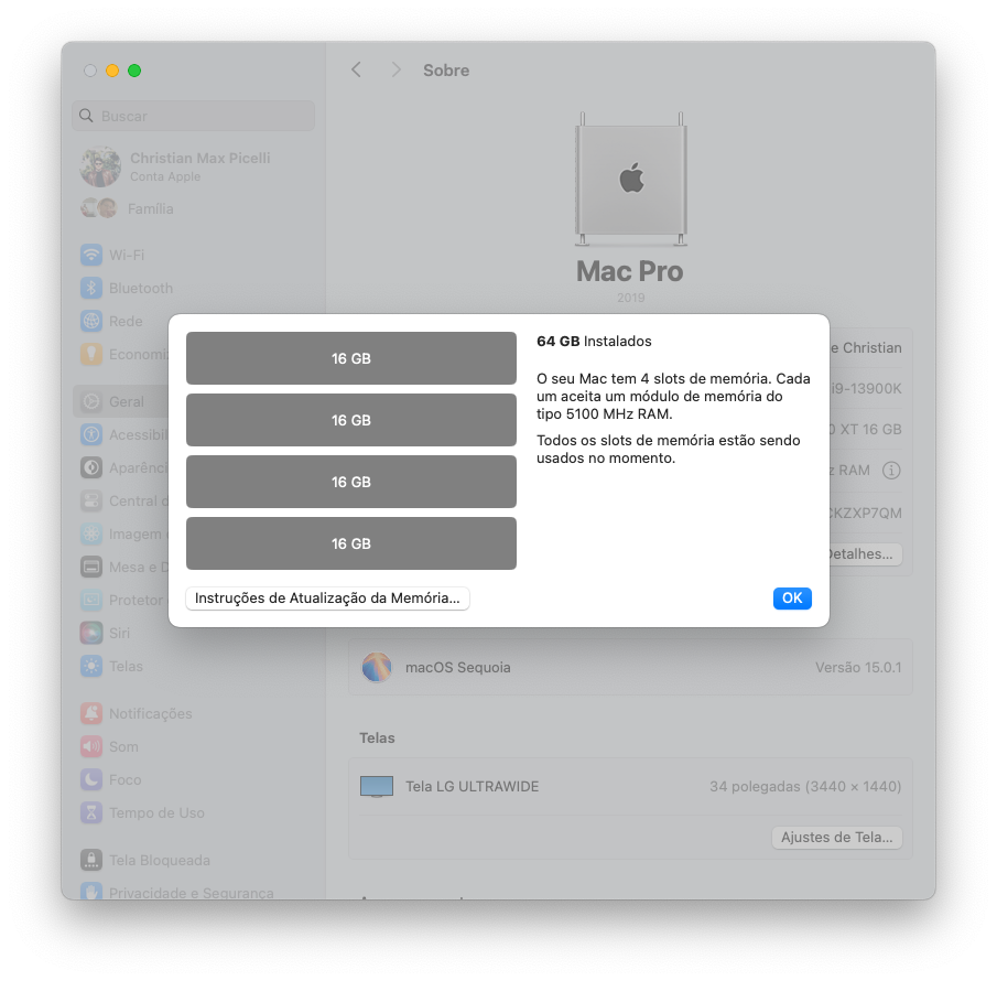

PPCnostalgic Posted October 4, 2024 Share Posted October 4, 2024 12 hours ago, Max.1974 said: https://swcdn.apple.com/content/downloads/05/43/072-01382-A_5URDEOHRHL/chwodorv8xcjx5ea41i5gmmw9ofgjwxtq1/InstallAssistant.pkg Sequoia 15.0.1 Good evening. Do you have 4x16Gb Ram sticks and, if yes, did you see a message about Ram not installed in the correct way? 1 Link to comment https://www.insanelymac.com/forum/topic/359987-release-macos-sequoia-150/page/7/#findComment-2826171 Share on other sites More sharing options...

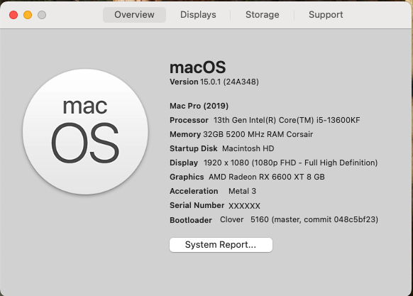

Max.1974 Posted October 4, 2024 Share Posted October 4, 2024 3 hours ago, zerking said: Updated to 15.0.1 and lose wifi again. Anyone is having the same problem? Here using Clover and VoodooHDA kext OCLP Nightly Build 2.0.2 all doing normal, smooth and fast! Wireless Broadcom Fenvi BCM94360CD Link to comment https://www.insanelymac.com/forum/topic/359987-release-macos-sequoia-150/page/7/#findComment-2826172 Share on other sites More sharing options...

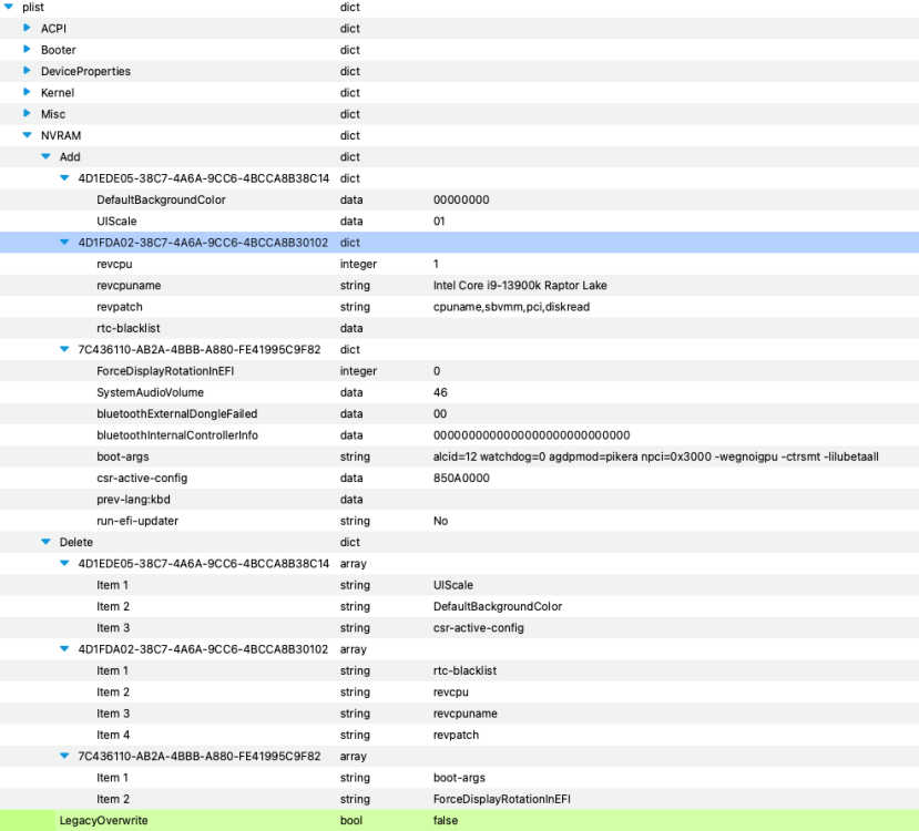

Max.1974 Posted October 4, 2024 Share Posted October 4, 2024 (edited) 26 minutes ago, PPCnostalgic said: Good evening. Do you have 4x16Gb Ram sticks and, if yes, did you see a message about Ram not installed in the correct way? Hi there, I fix that with description of my memories on SMBIOS from Clover and boot-args on Clover boot section with: revcpu=1 revpatch=cpuname,sbvmm,diskread,pci Credits for: @Alpha22 and @MaLd0n Need use RestrictEvents kext Dortania instructions: Fixing MacPro7,1 Memory Errors See: Spoiler Memory fix.mov Edited October 4, 2024 by Max.1974 1 Link to comment https://www.insanelymac.com/forum/topic/359987-release-macos-sequoia-150/page/7/#findComment-2826173 Share on other sites More sharing options...

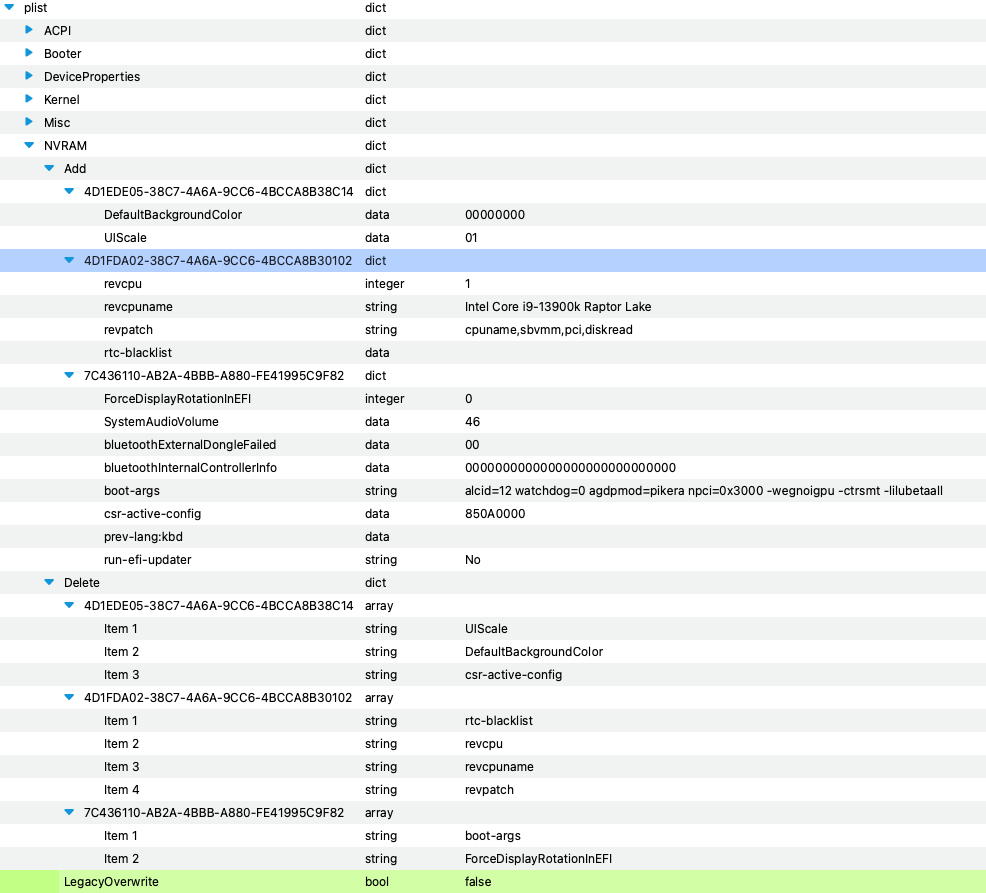

PPCnostalgic Posted October 4, 2024 Share Posted October 4, 2024 I guess I'm missing something. Can you explain how did you reolace these fields revpatch=cpuname,sbvmm,diskread,pci ? 1 Link to comment https://www.insanelymac.com/forum/topic/359987-release-macos-sequoia-150/page/7/#findComment-2826180 Share on other sites More sharing options...

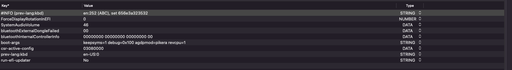

Max.1974 Posted October 4, 2024 Share Posted October 4, 2024 Sure @PPCnostalgic here on Nvram in Opencore plist Here my Nvram parcial config.plist Hope this help you Nvram OC fix revpatch.plist.zip Link to comment https://www.insanelymac.com/forum/topic/359987-release-macos-sequoia-150/page/7/#findComment-2826182 Share on other sites More sharing options...
PPCnostalgic Posted October 4, 2024 Share Posted October 4, 2024 With your modified plist something's changed, it says this Mac has 3 Ram slot instead of 12, on 4 of them is installed a 16gb module, but still non the right way... The machine works normally though. Thank you for your time! 1 Link to comment https://www.insanelymac.com/forum/topic/359987-release-macos-sequoia-150/page/7/#findComment-2826188 Share on other sites More sharing options...

jlrycm Posted October 4, 2024 Share Posted October 4, 2024 4 hours ago, PPCnostalgic said: You did a very good job, I'm on OpenCore and I have to find a way to replcate what you did with Clover. Thank you for your hint, I'll try to do something similar with OpenCore.. @PPCnostalgic I worked on replicating the OpenCore memory configuration fix for macpro 7,1 to Clover and I was able to do it and boot from Clover w/o issues using restrictedevents pci boot arg but the memory slot diagram will not look like a real MacPro 7,1, instead will look like a hackintosh MacPro 7,1. Link to comment https://www.insanelymac.com/forum/topic/359987-release-macos-sequoia-150/page/7/#findComment-2826192 Share on other sites More sharing options...
PPCnostalgic Posted October 5, 2024 Share Posted October 5, 2024 Thank you @Max.1974 and @jlrycm for your time. I managed it to work correctly re-installing RestrictEvents.kext for some reason OpenCore didn't update from 1.1.3 to newer 1.1.4 Now Both Cpu type and Ram slots are listed properly. 2 Link to comment https://www.insanelymac.com/forum/topic/359987-release-macos-sequoia-150/page/7/#findComment-2826201 Share on other sites More sharing options...

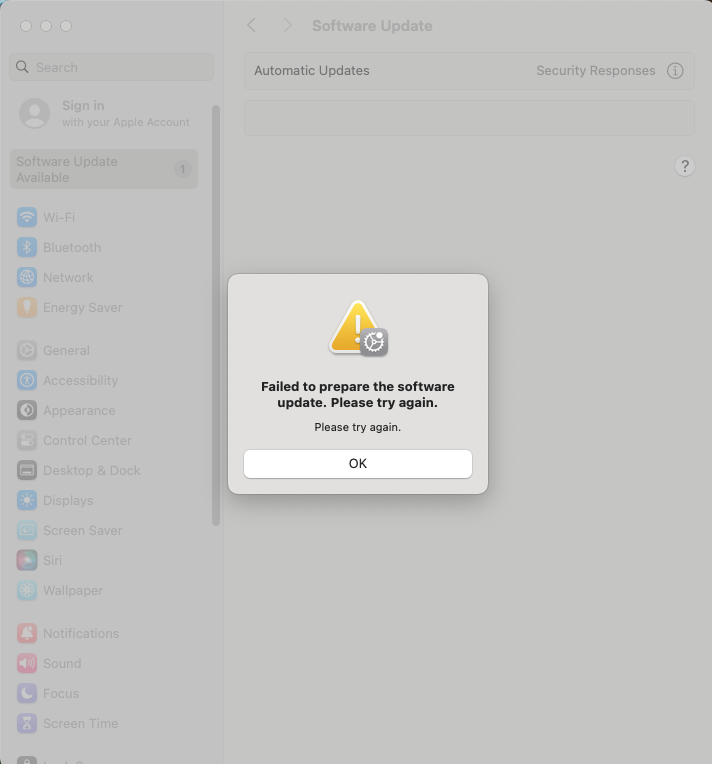

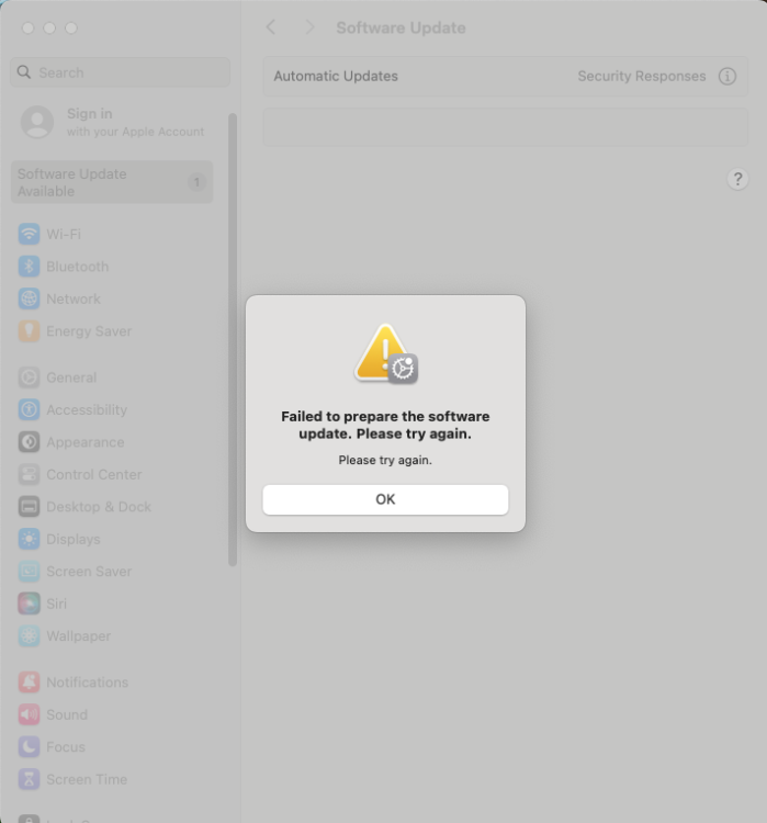

LockDown Posted October 8, 2024 Share Posted October 8, 2024 (edited) Im currently running 15.0. Anybody encountered this error while 15.0.1 (774.8MB )is being downloaded? FIXED!!! Temporarily disabling BlueToolFixup. Edited October 8, 2024 by LockDown 1 Link to comment https://www.insanelymac.com/forum/topic/359987-release-macos-sequoia-150/page/7/#findComment-2826287 Share on other sites More sharing options...
deeveedee Posted October 8, 2024 Share Posted October 8, 2024 (edited) 13 hours ago, LockDown said: FIXED!!! Temporarily disabling BlueToolFixup. This appears to be common in the hackintosh community. I'm not sure if it affects all hack/Mac users the same, but like you, incremental OTA on my HackMini8,1 only works when BluetoolFixup.kext is disabled. Again, thanks to @ird for enlightening me. Edited October 8, 2024 by deeveedee 3 Link to comment https://www.insanelymac.com/forum/topic/359987-release-macos-sequoia-150/page/7/#findComment-2826306 Share on other sites More sharing options...
Anto65 Posted October 8, 2024 Share Posted October 8, 2024 Same thing here as at @LockDown I get incremental updates (doing OCLP revert , I haven't actually applied it lately 🙂 ) but it fails By disabling BluetoolFixup.kext, everything goes as it should 🤷♂️ ( 15.1 Beta 6 ) 7 Link to comment https://www.insanelymac.com/forum/topic/359987-release-macos-sequoia-150/page/7/#findComment-2826307 Share on other sites More sharing options...

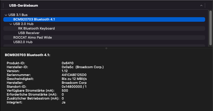

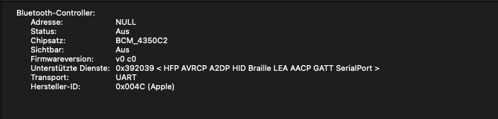

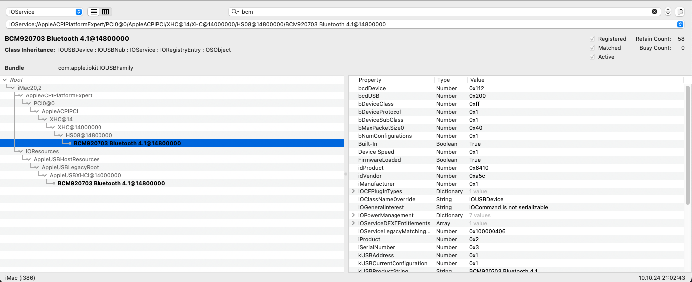

anullpointerexception Posted October 10, 2024 Share Posted October 10, 2024 (edited) Good evening, I'm not sure if this is the correct thread for my issue, so I apologize if it's not. I successfully updated my second Hackintosh to macOS Sequoia, and everything is working perfectly except for one issue: Bluetooth. I’ve updated all my kexts to the latest versions, but for some reason, I can't activate Bluetooth. Under macOS Sonoma, I used earlier versions of the same kexts without any issues, but on Sequoia, Bluetooth just won't turn on. If I enable it, the toggle stays on for a few seconds and then switches to "Disabled" again. This is what log show --last boot | grep -i brcm shows: 2024-10-10 20:41:38.313039+0200 0x3d2 Default 0x0 120 0 kernelmanagerd: Received kext load notification: as.lvs1974.AirportBrcmFixup 2024-10-10 20:41:38.313131+0200 0x892 Error 0x0 309 0 kernelmanager_helper: Could not process load notification in helper: Could not find: Did not find identifier (as.lvs1974.AirportBrcmFixup) in helper to process load notification 2024-10-10 20:41:38.313537+0200 0x3d2 Default 0x0 120 0 kernelmanagerd: Received kext load notification: as.acidanthera.BrcmFirmwareStore 2024-10-10 20:41:38.313626+0200 0x892 Error 0x0 309 0 kernelmanager_helper: Could not process load notification in helper: Could not find: Did not find identifier (as.acidanthera.BrcmFirmwareStore) in helper to process load notification 2024-10-10 20:41:38.315757+0200 0x3d2 Default 0x0 120 0 kernelmanagerd: Received kext load notification: com.apple.driver.AirPort.BrcmNIC 2024-10-10 20:41:38.315828+0200 0x3d2 Default 0x0 120 0 kernelmanagerd: Received kext load notification: as.acidanthera.BrcmPatchRAM3 2024-10-10 20:41:38.315914+0200 0x892 Error 0x0 309 0 kernelmanager_helper: Could not process load notification in helper: Could not find: Did not find identifier (as.acidanthera.BrcmPatchRAM3) in helper to process load notification I did add the following kexts for Bluetooth: bluetoothExternalDongleFailed and bluetoothInternalControllerInfo is also set. Port Mapping is also done: IOReg: Any insights or suggestions would be greatly appreciated! Thanks in advance Edited October 10, 2024 by anullpointerexception Link to comment https://www.insanelymac.com/forum/topic/359987-release-macos-sequoia-150/page/7/#findComment-2826390 Share on other sites More sharing options...
