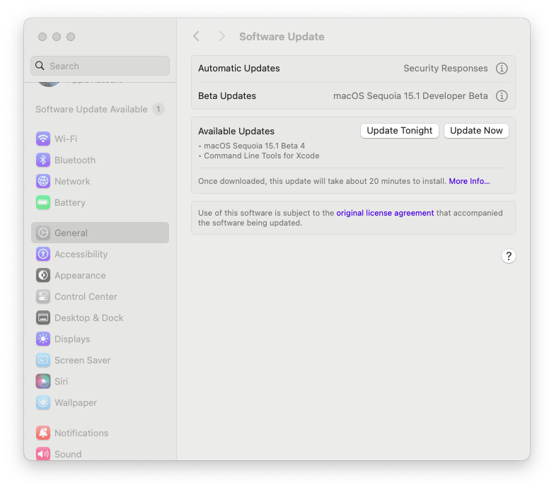

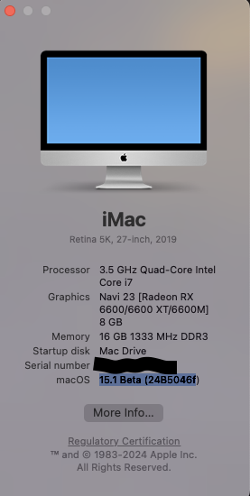

AlfredoM Posted September 18, 2024 Share Posted September 18, 2024 (edited) Something strange happened on my Intel Mac MIni 2018. After I installed the Final Sequoia 15.0 Build 24A335, an update to Seqouia 15.1 Beta4 came (as I said for Intel Mac). Build number 15.1 Beta4 is 24B5046f I installed this Beta 4 15.1 Sequoia on a Test- Partition. Now I ask myself why there was no beta1 or 2 or 3 and why was there beta4? Does anyone know an answer to that? I have found Infos for this Beta4 here: Release Infos Interesst Link here: Read here Edited September 18, 2024 by AlfredoM 2 Link to comment https://www.insanelymac.com/forum/topic/359987-release-macos-sequoia-150/page/3/#findComment-2825534 Share on other sites More sharing options...

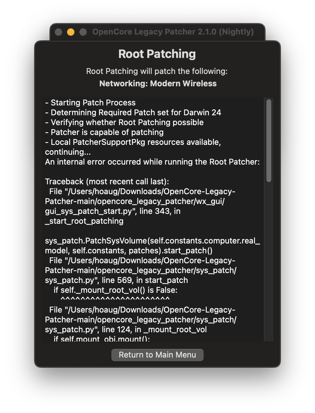

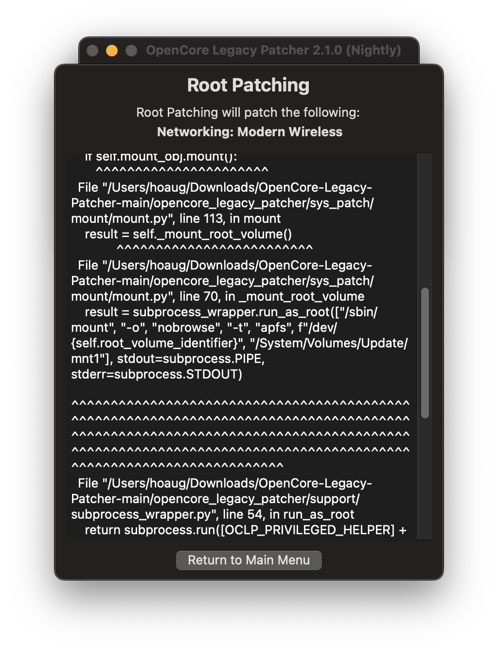

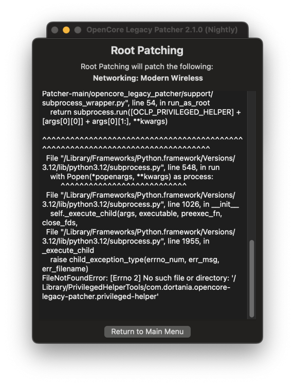

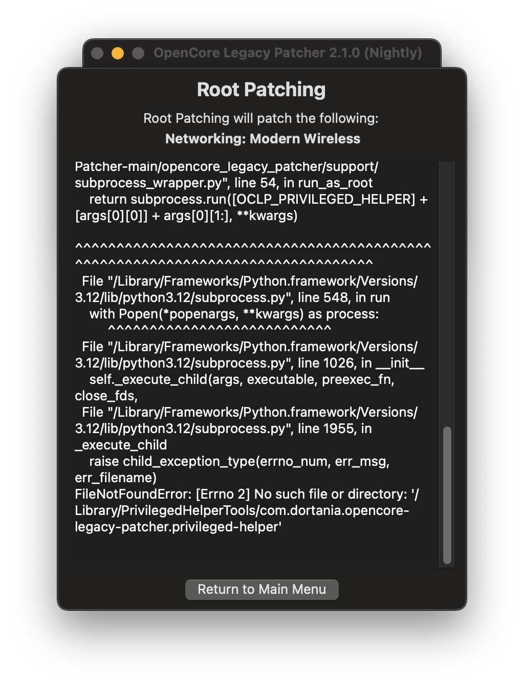

hoaug Posted September 18, 2024 Share Posted September 18, 2024 2 hours ago, chris1111 said: cd /Users/kinhhoang161/Developer/OpenCore-Legacy-Patcher/ci_tooling/privileged_helper_tool make debug i tried but i got another error : Link to comment https://www.insanelymac.com/forum/topic/359987-release-macos-sequoia-150/page/3/#findComment-2825536 Share on other sites More sharing options...
Irish_Man Posted September 18, 2024 Share Posted September 18, 2024 @kinhhoang161 I've had a similar issue. What I did was, I downloaded OpenCore-Patcher-Uninstaller and OpenCore-Patcher.pkg (not OpenCore-Patcher-GUI.app) 1. Run OpenCore-Patcher-Uninstaller. 2. Reboot and clear NVRAM. 3. Run OpenCore-Patcher.pkg. After that it should work. At least it did in my case. 3 Link to comment https://www.insanelymac.com/forum/topic/359987-release-macos-sequoia-150/page/3/#findComment-2825537 Share on other sites More sharing options...
miliuco Posted September 18, 2024 Share Posted September 18, 2024 (edited) @kinhhoang161 If you have in /Library/Extensions any other kext than EnergyDriver.kext, HighPointIOP.kext and HighPointRR.kext, delete them (or move to Desktop) and try again. Also, you can uninstall OCLP and download it again. Edited September 18, 2024 by miliuco Fix typo Link to comment https://www.insanelymac.com/forum/topic/359987-release-macos-sequoia-150/page/3/#findComment-2825542 Share on other sites More sharing options...
hoaug Posted September 18, 2024 Share Posted September 18, 2024 (edited) Many thanks. I discovered that the issue was caused by deleting PcmMsrDriver.kext from the Library/Extensions folder. After uninstalling OCLP and restarting my system, I reinstalled OCLP and successfully applied the Root Patch. Now, the WiFi is working perfectly. Thank you so much! (Honestly, I already knew where that kext came from. I must have done something and then forgotten about it.). Edited September 18, 2024 by kinhhoang161 2 Link to comment https://www.insanelymac.com/forum/topic/359987-release-macos-sequoia-150/page/3/#findComment-2825544 Share on other sites More sharing options...

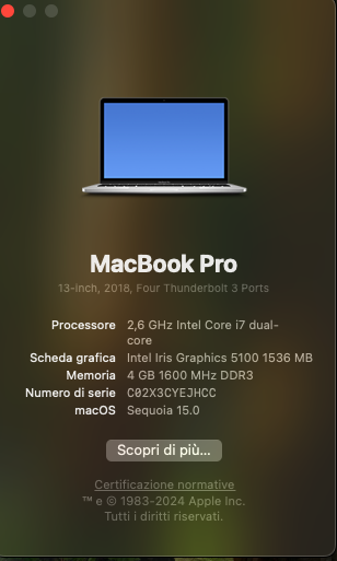

Ludox Posted September 18, 2024 Share Posted September 18, 2024 Lenovo ideapad 100 15ibd Intel Iris 5100 4 Link to comment https://www.insanelymac.com/forum/topic/359987-release-macos-sequoia-150/page/3/#findComment-2825571 Share on other sites More sharing options...

robi62 Posted September 19, 2024 Share Posted September 19, 2024 10 hours ago, Ludox said: Lenovo ideapad 100 15ibd Intel Iris 5100 It runs ok with only 4gb ram?? Funziona bene con solo4gb di ram?? Link to comment https://www.insanelymac.com/forum/topic/359987-release-macos-sequoia-150/page/3/#findComment-2825585 Share on other sites More sharing options...
Ludox Posted September 19, 2024 Share Posted September 19, 2024 7 minutes ago, robi62 said: It runs ok with only 4gb ram?? Funziona bene con solo4gb di ram?? Yes no problem 1 Link to comment https://www.insanelymac.com/forum/topic/359987-release-macos-sequoia-150/page/3/#findComment-2825586 Share on other sites More sharing options...
robi62 Posted September 19, 2024 Share Posted September 19, 2024 33 minutes ago, Ludox said: Yes no problem Is that with clover or OC?? Link to comment https://www.insanelymac.com/forum/topic/359987-release-macos-sequoia-150/page/3/#findComment-2825588 Share on other sites More sharing options...

Ludox Posted September 19, 2024 Share Posted September 19, 2024 1 hour ago, robi62 said: Is that with clover or OC?? For Lenovo OC, no Clover... Link to comment https://www.insanelymac.com/forum/topic/359987-release-macos-sequoia-150/page/3/#findComment-2825594 Share on other sites More sharing options...

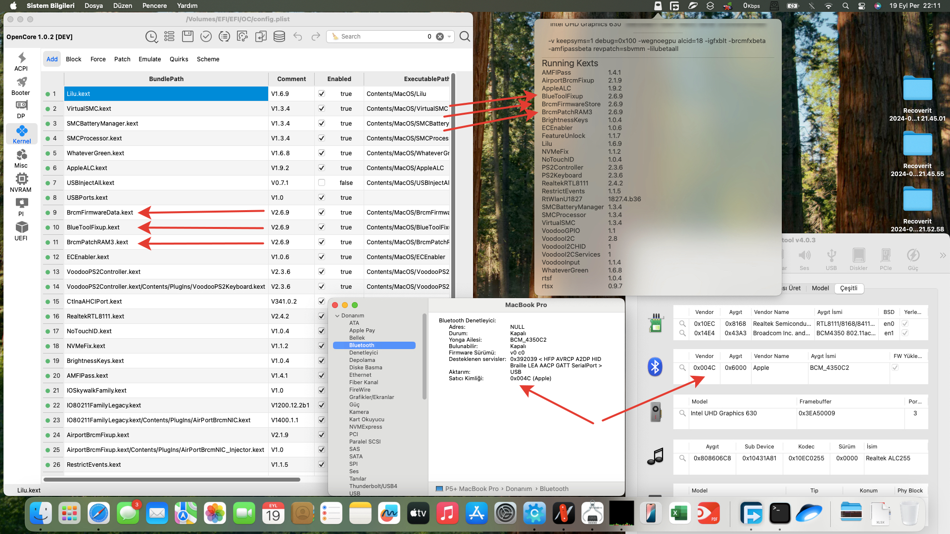

HyperX7 Posted September 19, 2024 Share Posted September 19, 2024 (edited) I have a bluetooth hardware with BCM_4350C2 chip on my laptop as shown on the screen below. I couldn't start the bluetooth feature of the DW1820A combo card. Bluetooth kexts are installed as seen on the screen below. Although bluetooth appears in Hackintool and System information, the bluetooth feature is definitely not turned on. I'm using OCLP 2.0.1 and Opencore 1.0.2 versions. I am waiting for your ideas on the solution of this problem. Thank you to those who were interested and answered! Edited September 19, 2024 by HyperX7 2 Link to comment https://www.insanelymac.com/forum/topic/359987-release-macos-sequoia-150/page/3/#findComment-2825608 Share on other sites More sharing options...
datafeedexpert Posted September 19, 2024 Share Posted September 19, 2024 45 minutes ago, HyperX7 said: I have a bluetooth hardware with BCM_4350C2 chip on my laptop as shown on the screen below. I couldn't start the bluetooth feature of the DW1820A combo card. Bluetooth kexts are installed as seen on the screen below. Although bluetooth appears in Hackintool and System information, the bluetooth feature is definitely not turned on. I'm using OCLP 2.0.1 and Opencore 1.0.2 versions. I am waiting for your ideas on the solution of this problem. Thank you to those who were interested and answered! @HyperX7 i am using the same DW1820A Card & my Bluetooth works great, You have to add below 2 entries 1. NVRAM (7C436110-AB2A-4BBB-A880-FE41995C9F82) boot-args -lilubetaall 2. NVRAM (7C436110-AB2A-4BBB-A880-FE41995C9F82) bluetoothExternalDongleFailed - Data - 00 bluetoothInternalControllerInfo - Data - 00000000 00000000 00000000 0000 After changing these value don't forget to Reset Nvram From Opencore Boot Picker Spoiler 4 1 Link to comment https://www.insanelymac.com/forum/topic/359987-release-macos-sequoia-150/page/3/#findComment-2825610 Share on other sites More sharing options...
